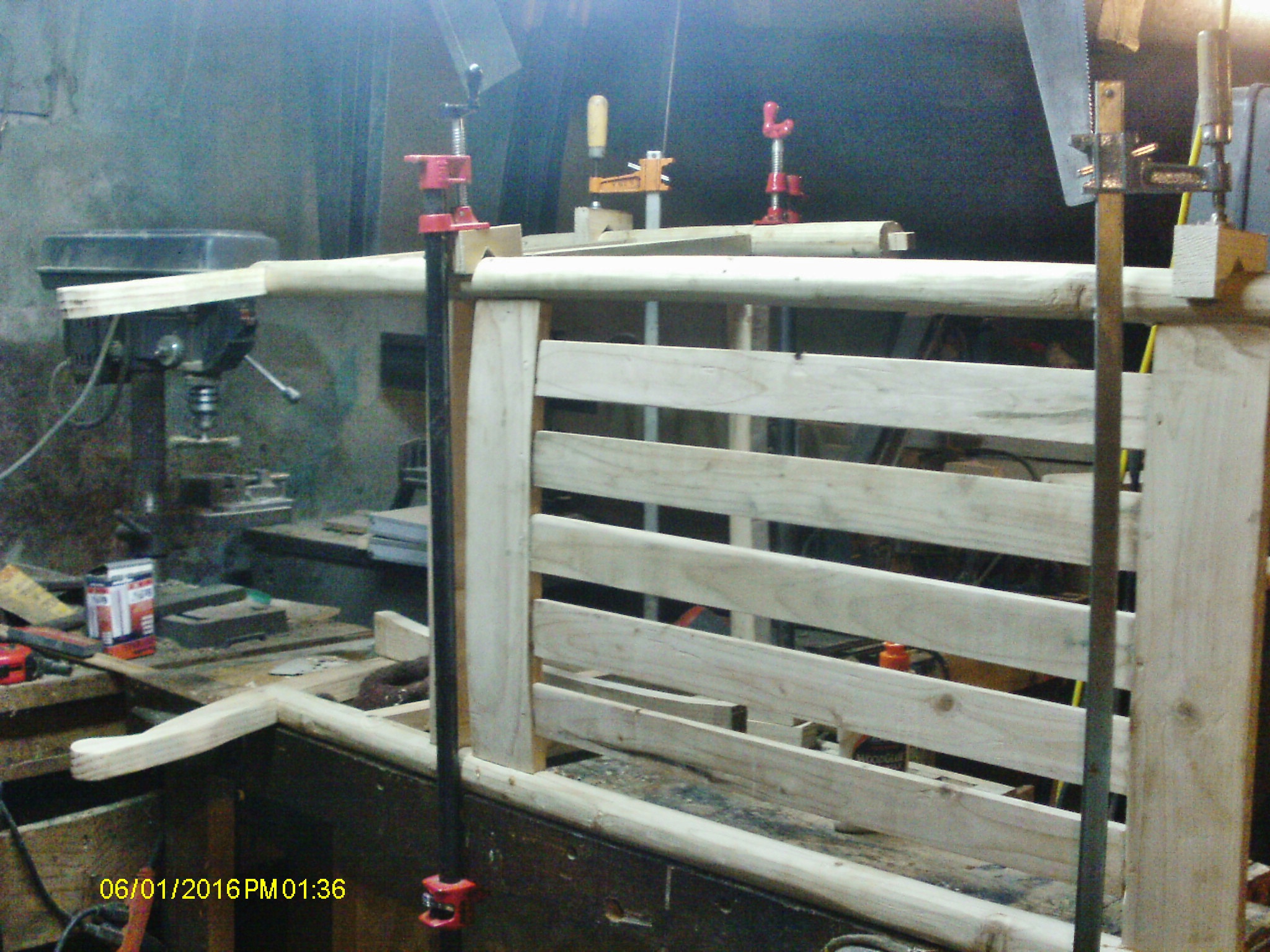

Rocker update! We have glue -ups
One was...meh, second one was much better.    First, the "ugly one"
The side on the right was there to help clamp things up....didn't work out too well.   Went down to the shop today, cleared everything off the bench..

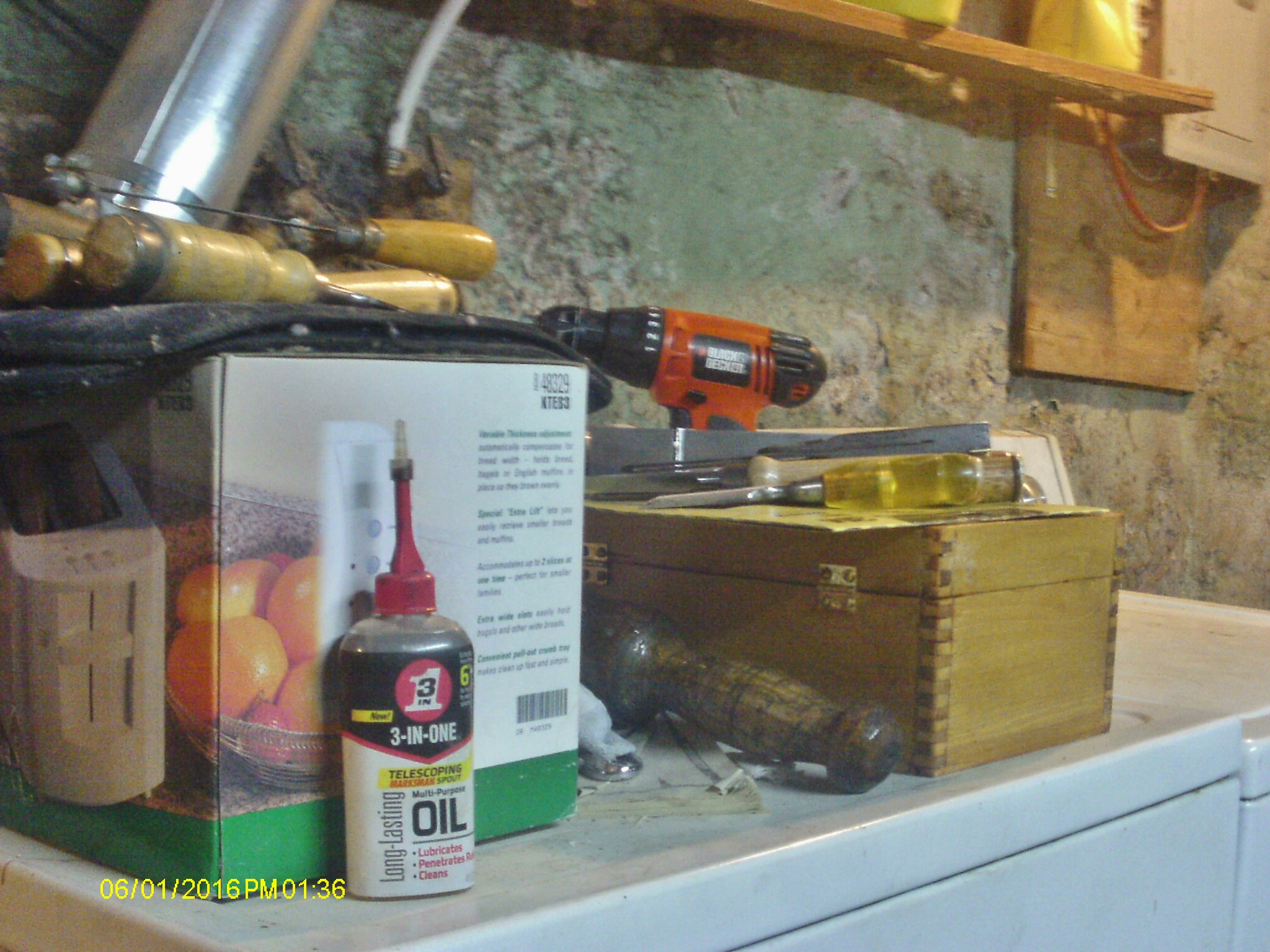

I'll get yelled at for putting my stuff onto HER dryer.    Then I made up a bunch of blocks...

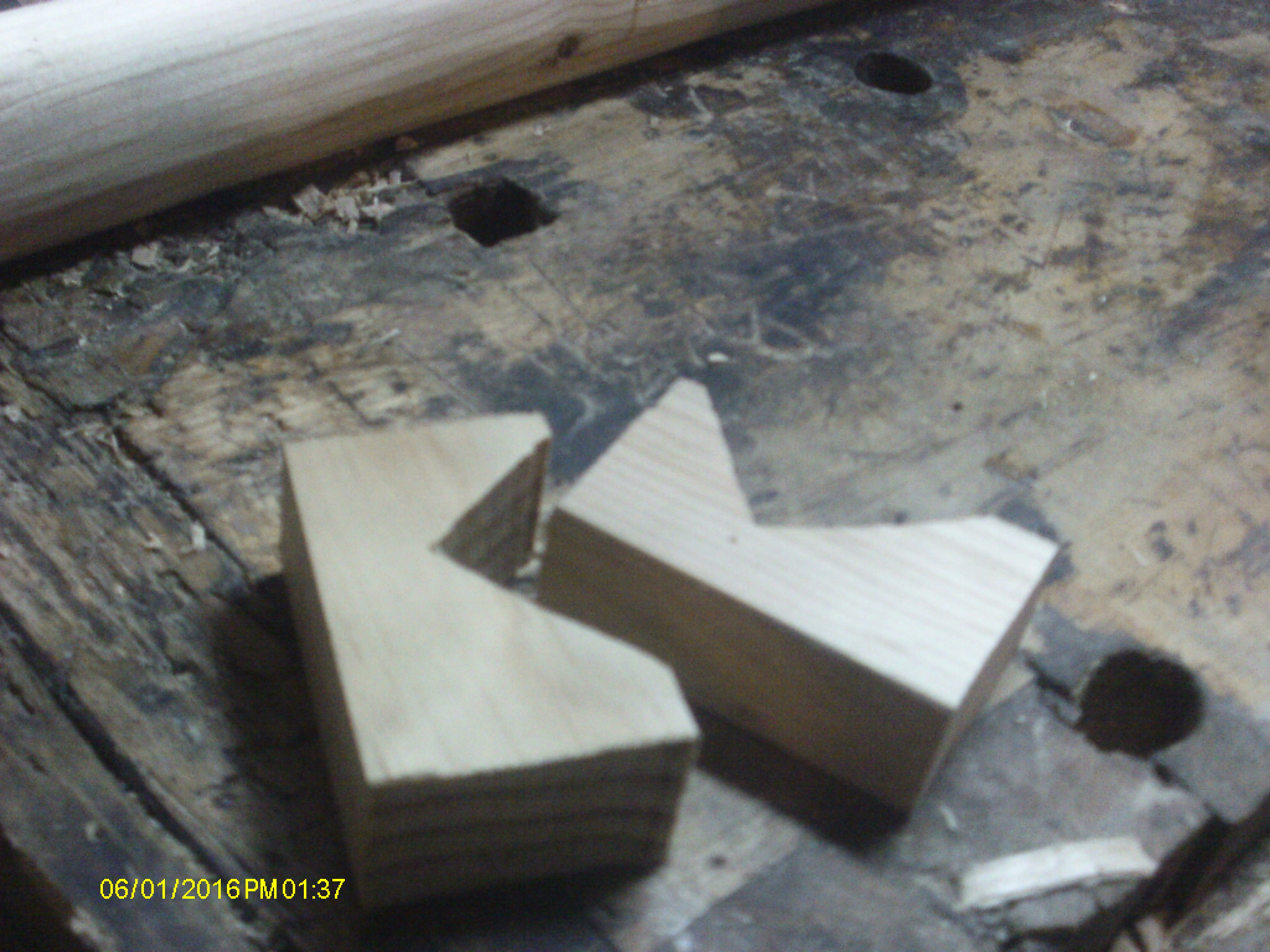

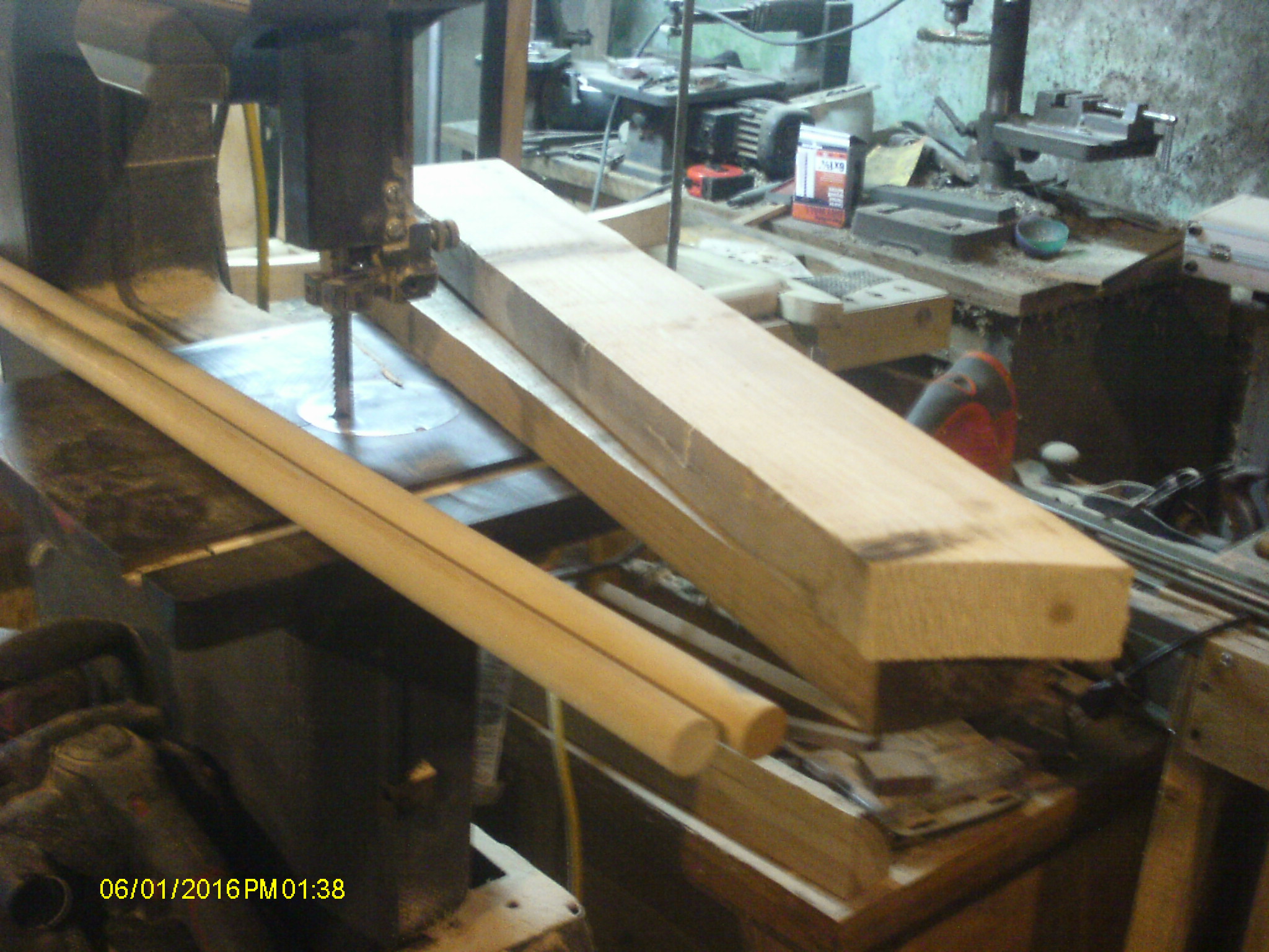

had some scrap sitting around.   bandsawn to sit onto round posts.     Might NOT have to fight & cuss clamps this time around...

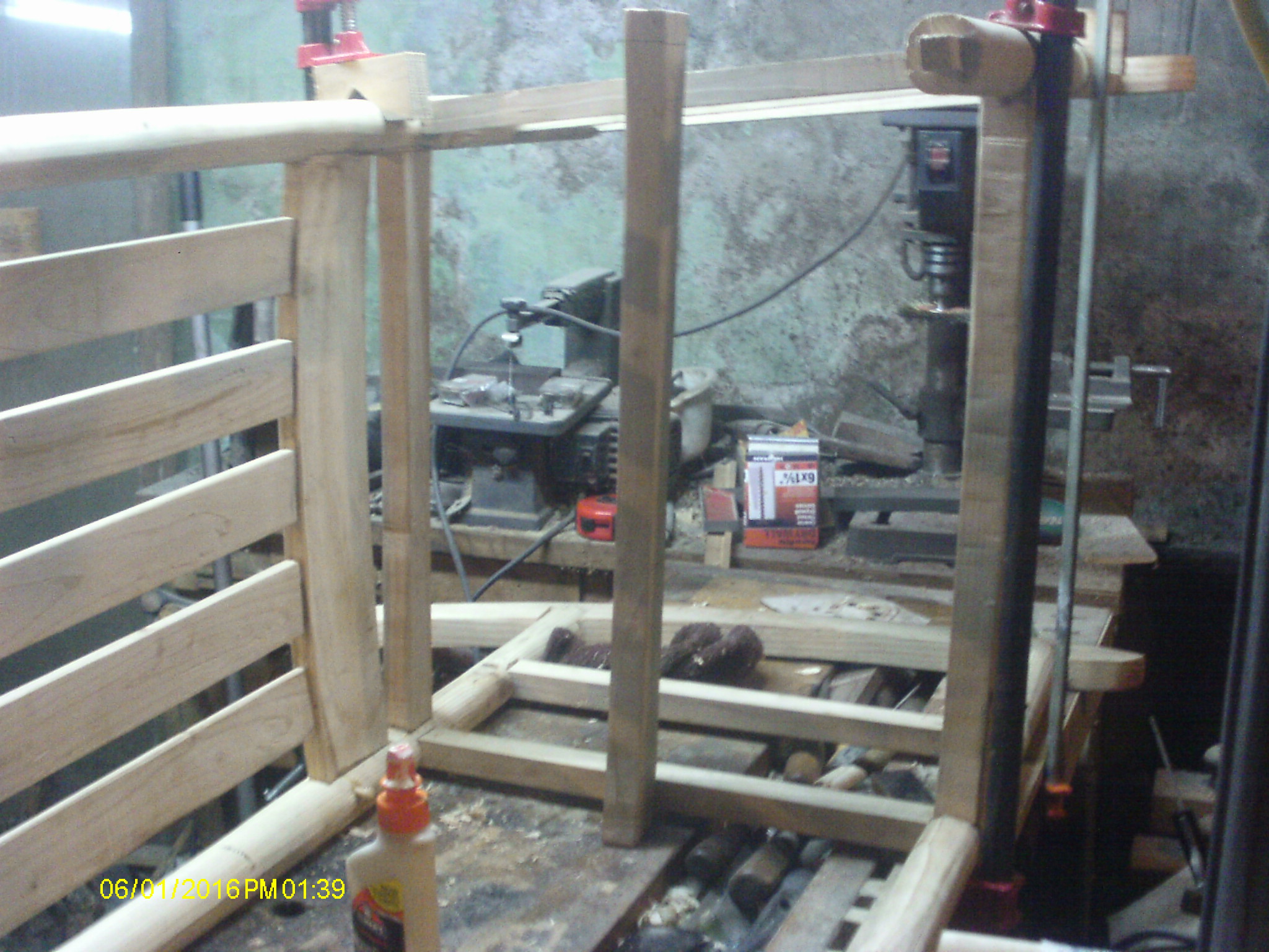

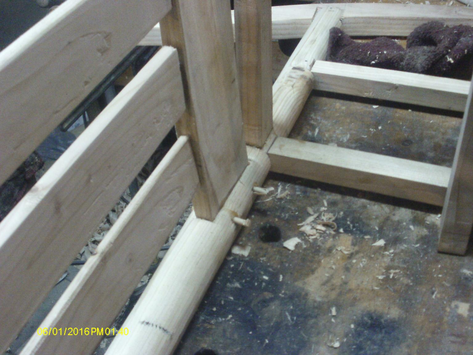

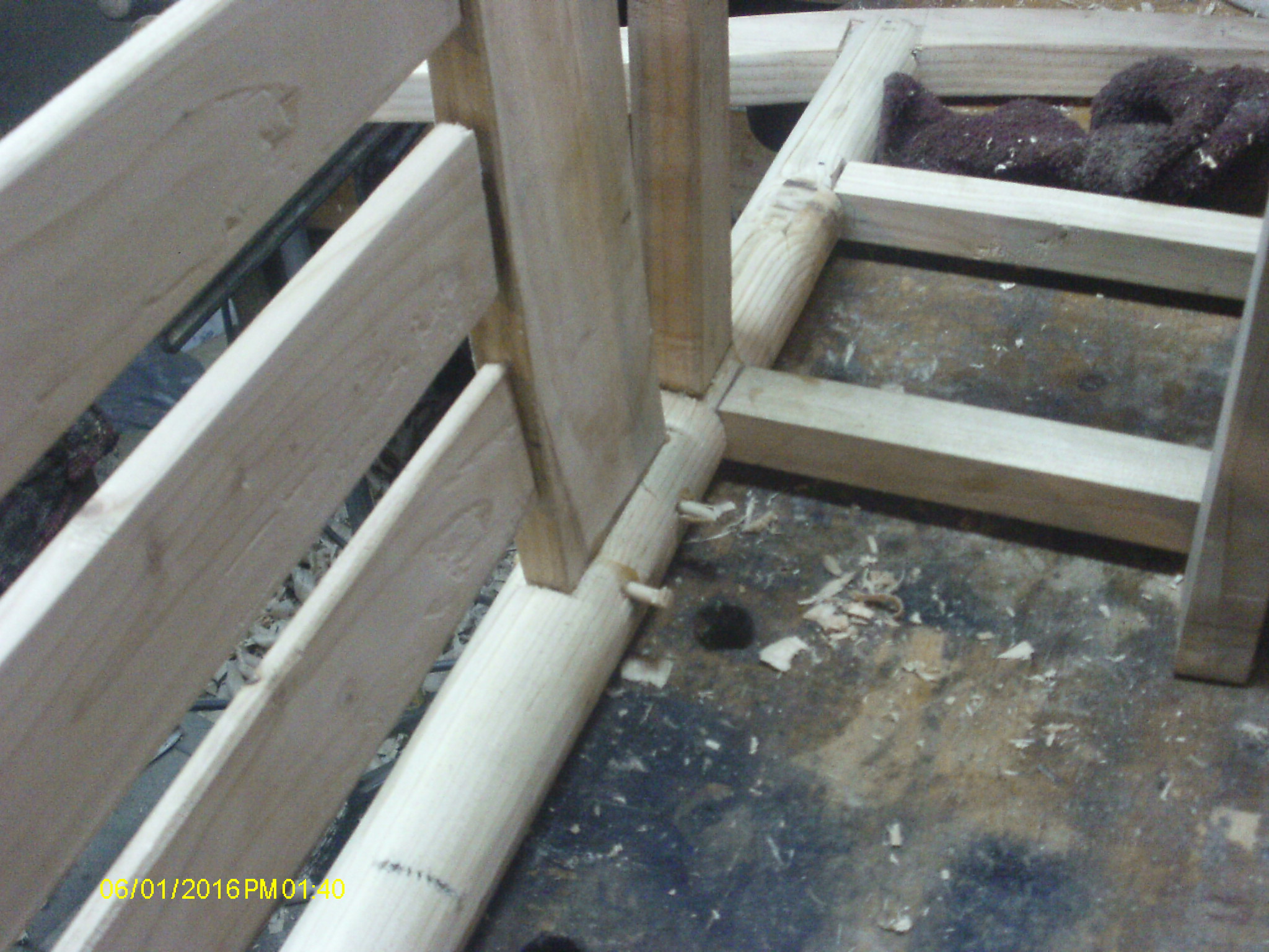

Some needed the blocks, some didn't, or weren't quite long enough.   While this thing was sitting like this, I drill for some small dowels to pin a few joints...

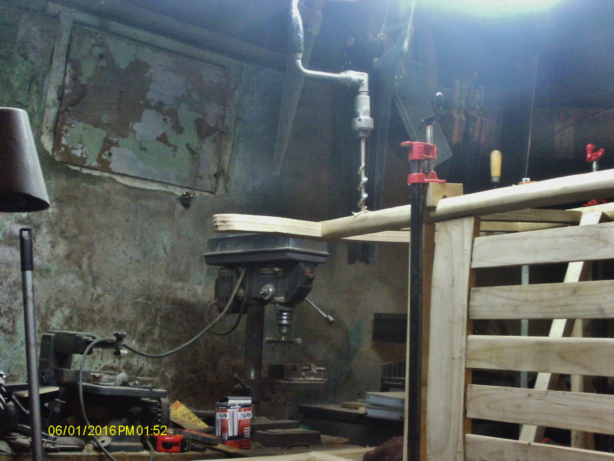

These are from earlier.   Not the prettiest, have to sand a lot anyway.   I also had one BIG dowel to install...
Bit is 7/8", brace is a PEXTO 12" sweep.    Good thing I'm on the tall side.    This was to install a rung in the back..

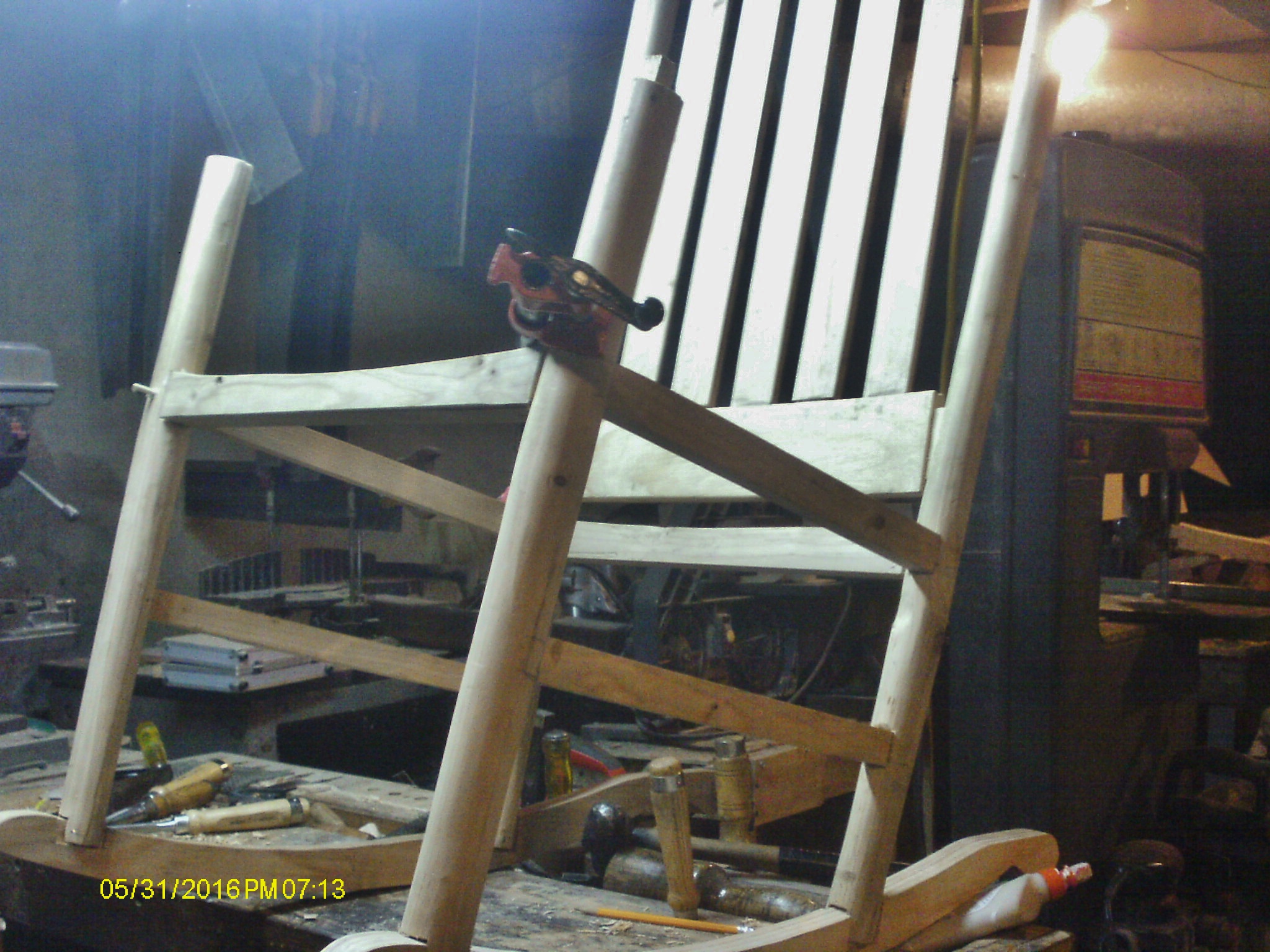

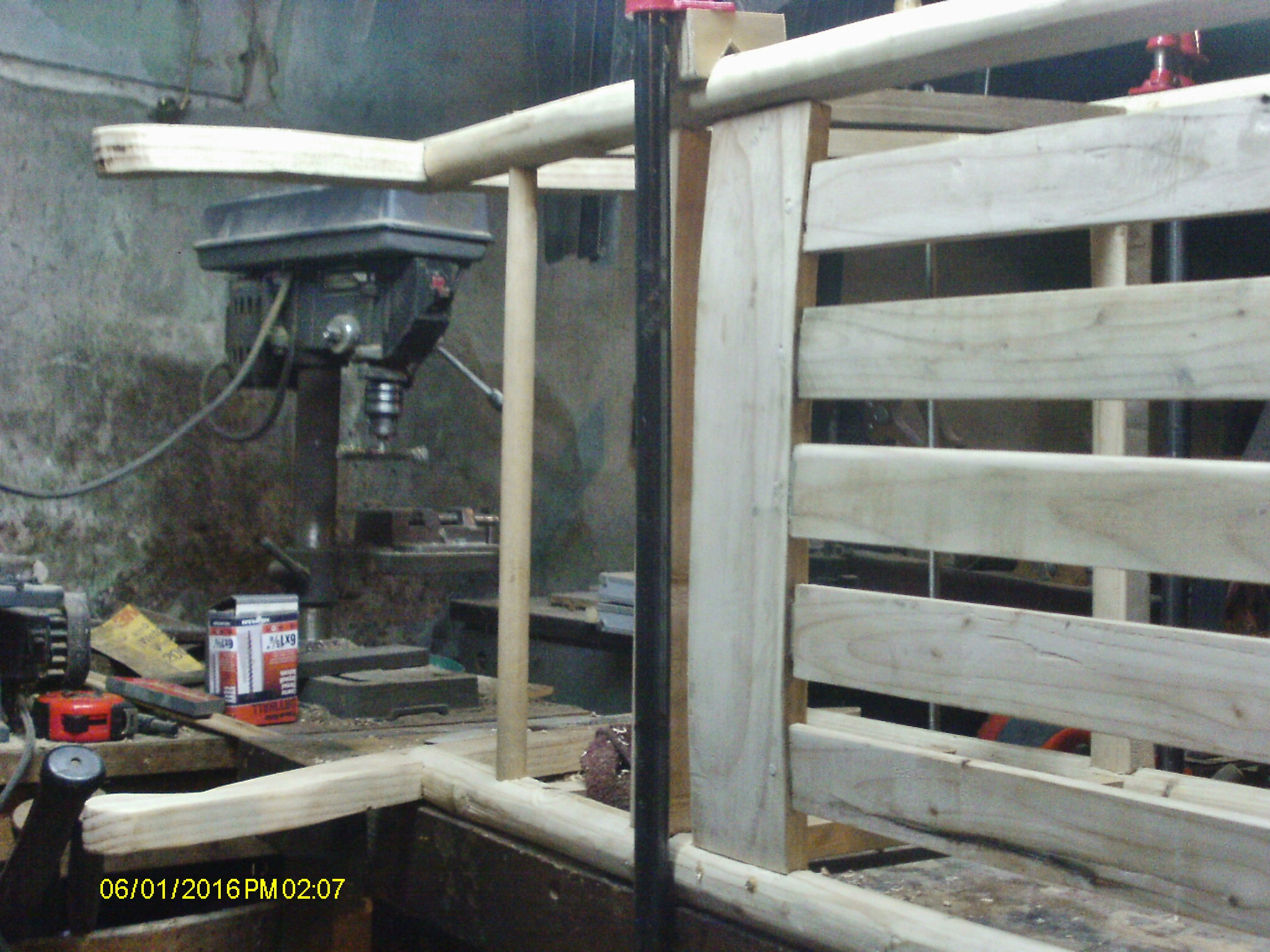

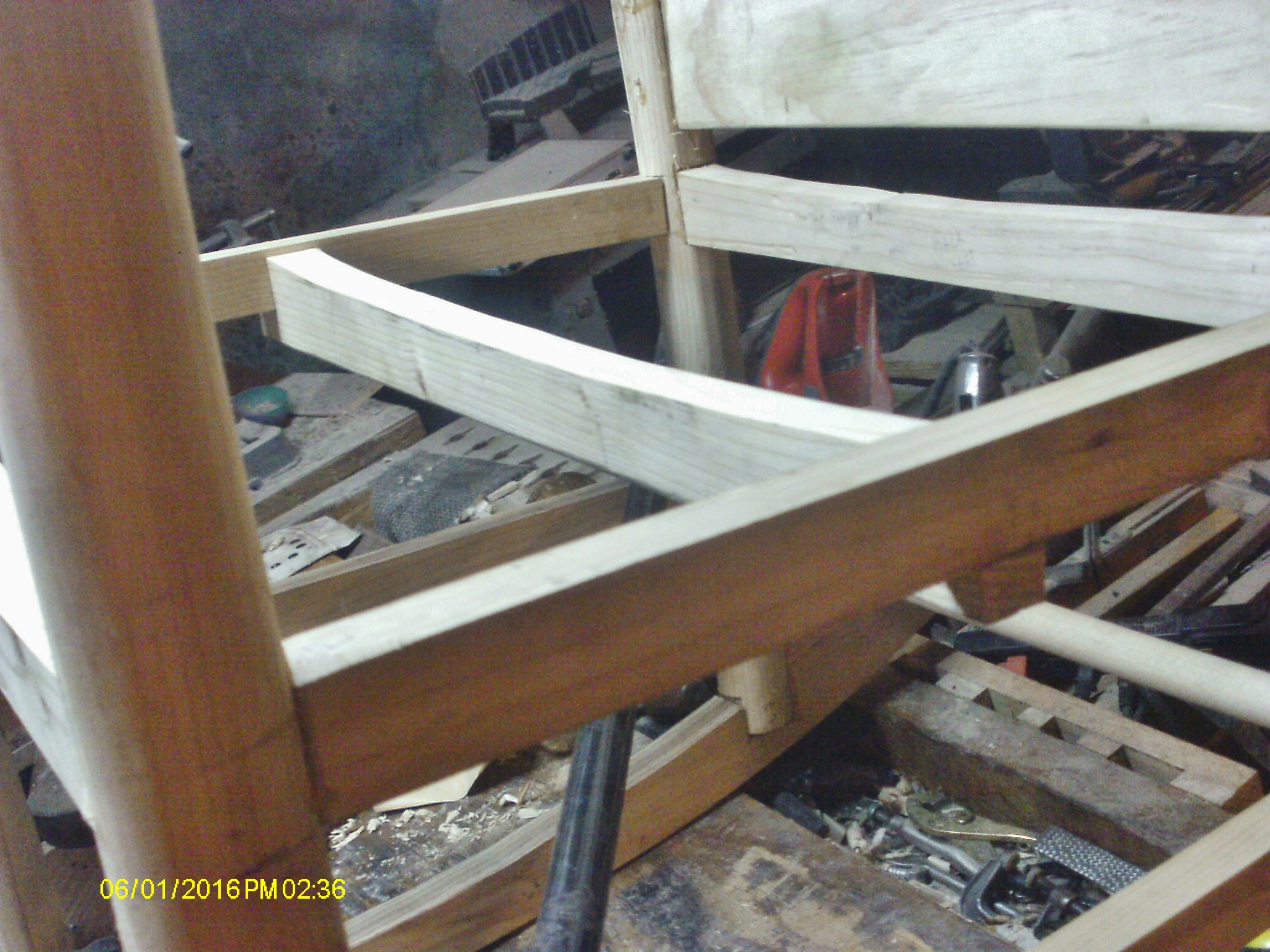

Still have to do one out front.    Joints pinned.   I have a clamp pulling the  chair into almost square.....Figured I could at least work on a seat

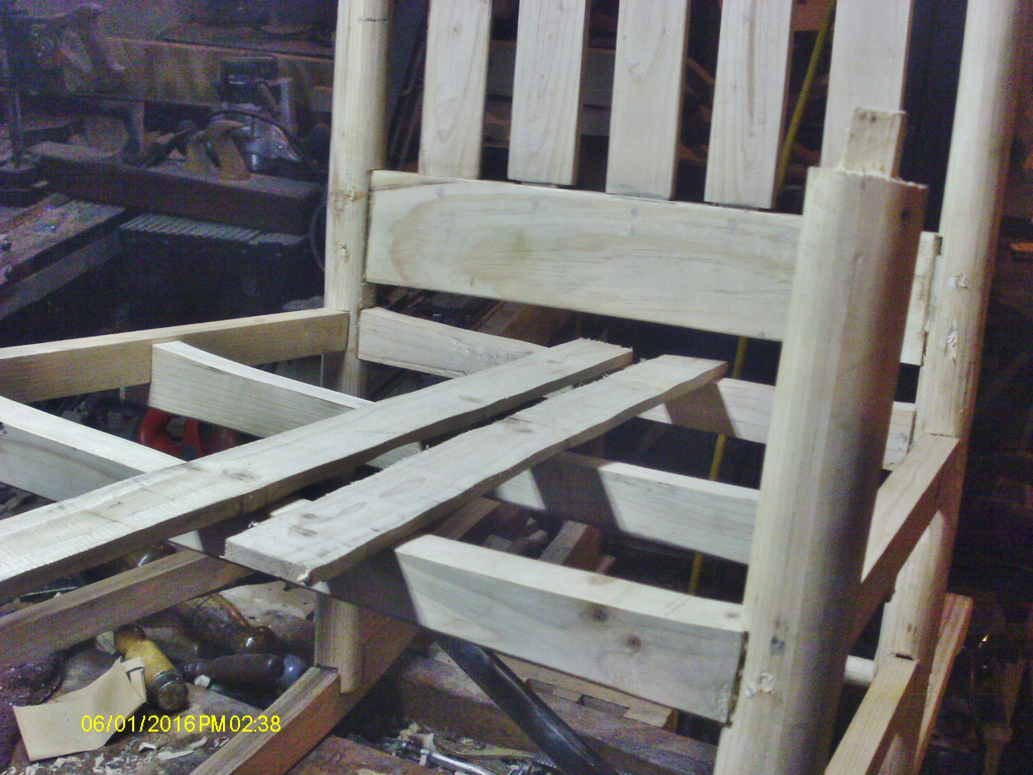

Couldn't quite get things marked right this way.    Took the clamps off as they weren't needed, glue had set.   Now  I could mark the seat support better.   Then some fancy cutting on the bandsaw, and sit the support thing in place...installed.JPG
I glued this in place, later I'll pin from the outside, and add a screw from underneath.. You can also see the clamp to pull things back into square.     Had a couple scrap slats, so a look at the seat..
I need to start cutting seat slats, get them smoothed out, ends rounded.  Center sits a bit lower than the front, by design.   I also laid out a couple blanks for armrests
If dryers (or in my case a freezer) weren't meant to store shop stuff on, they wouldn't have made them with flat tops.
