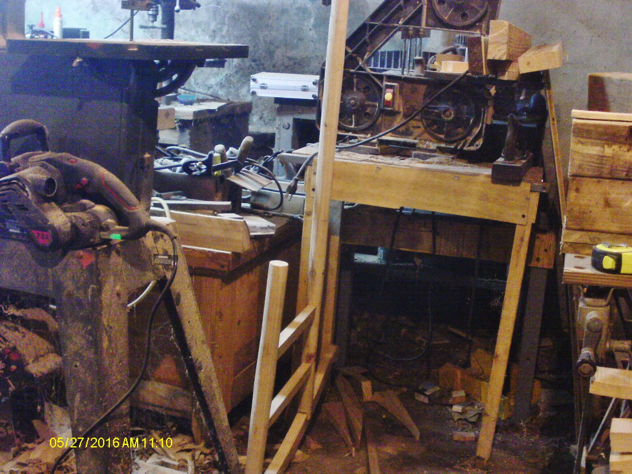

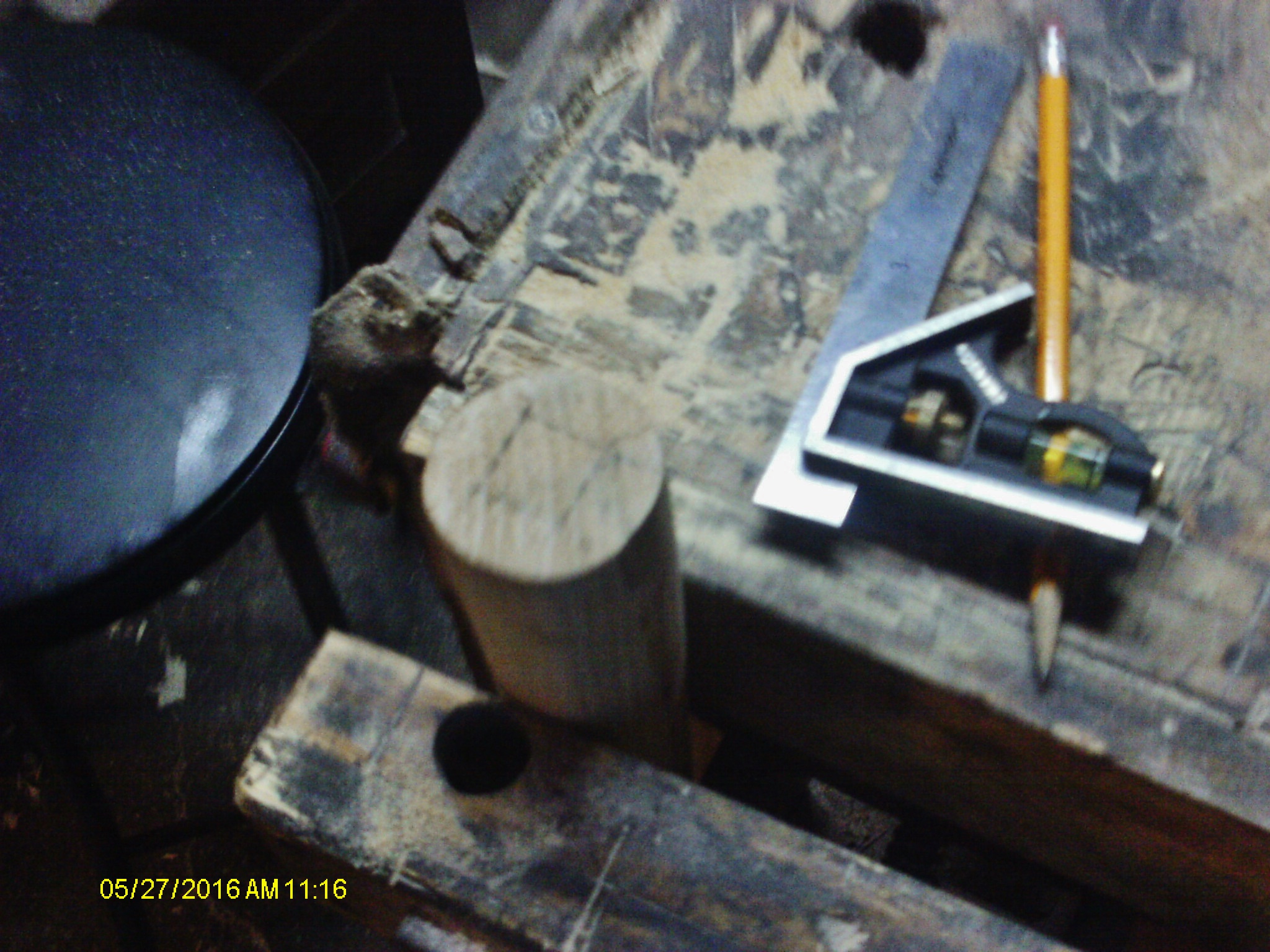

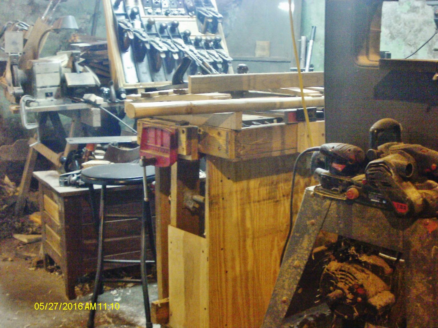

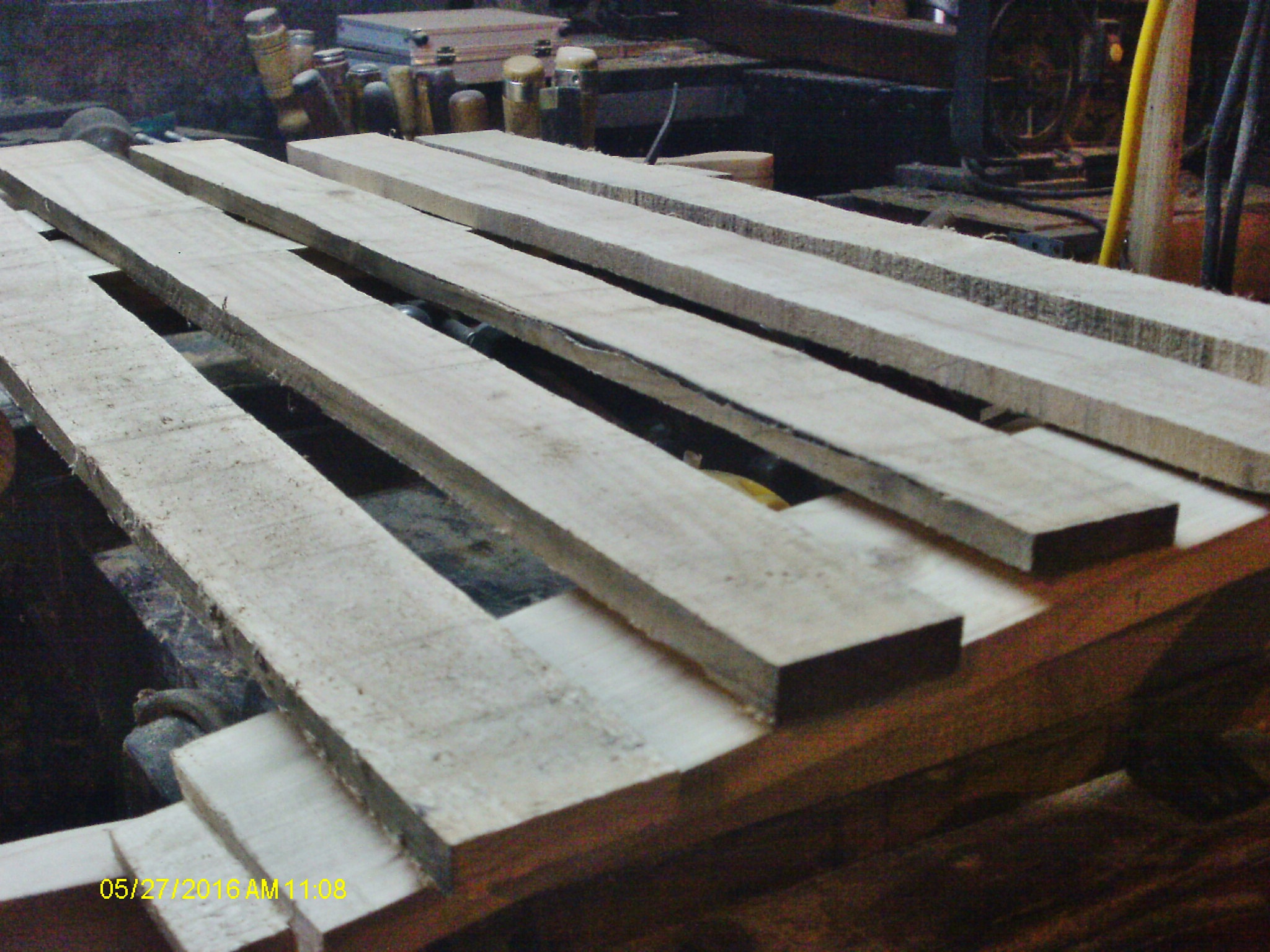

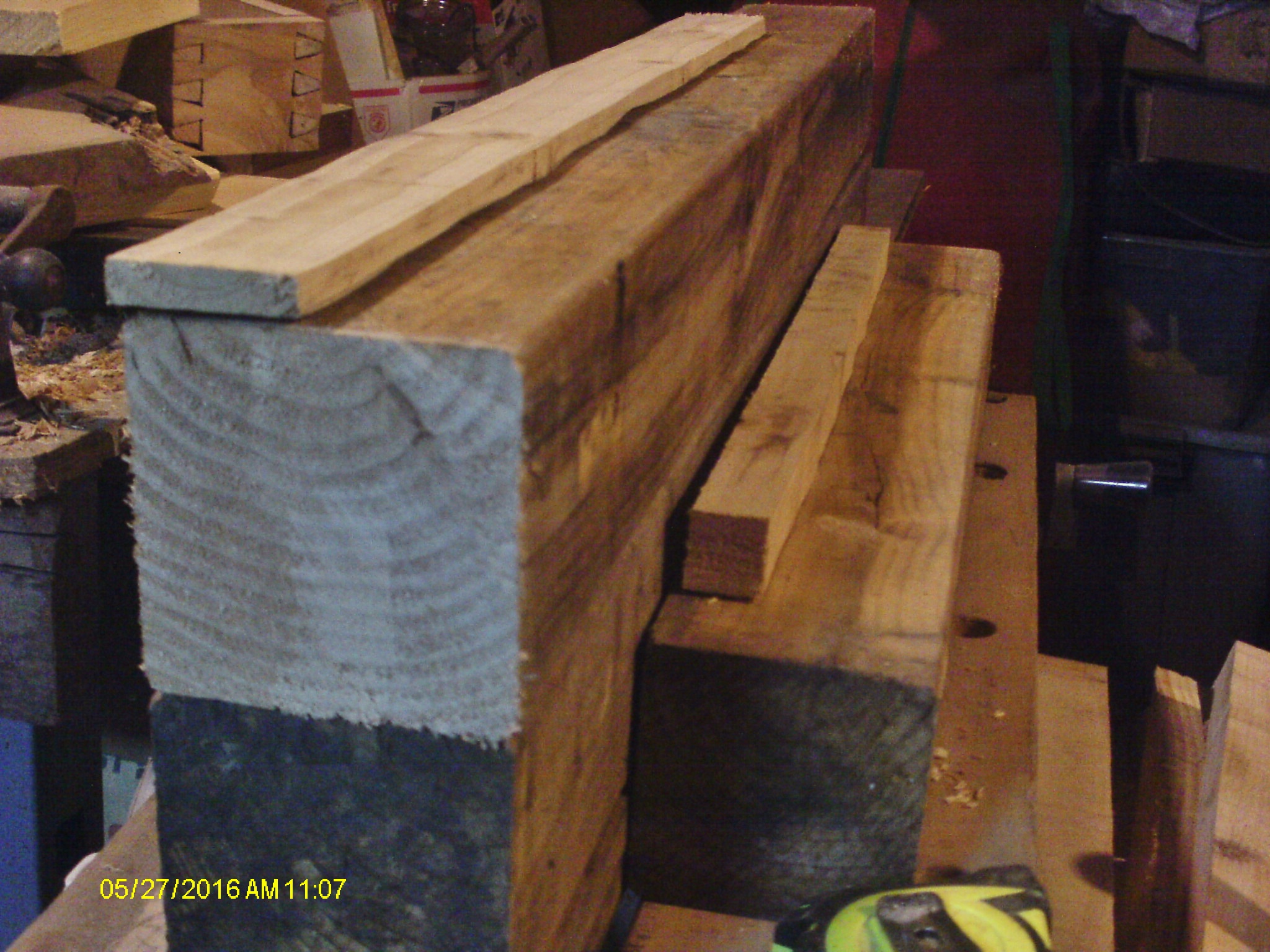

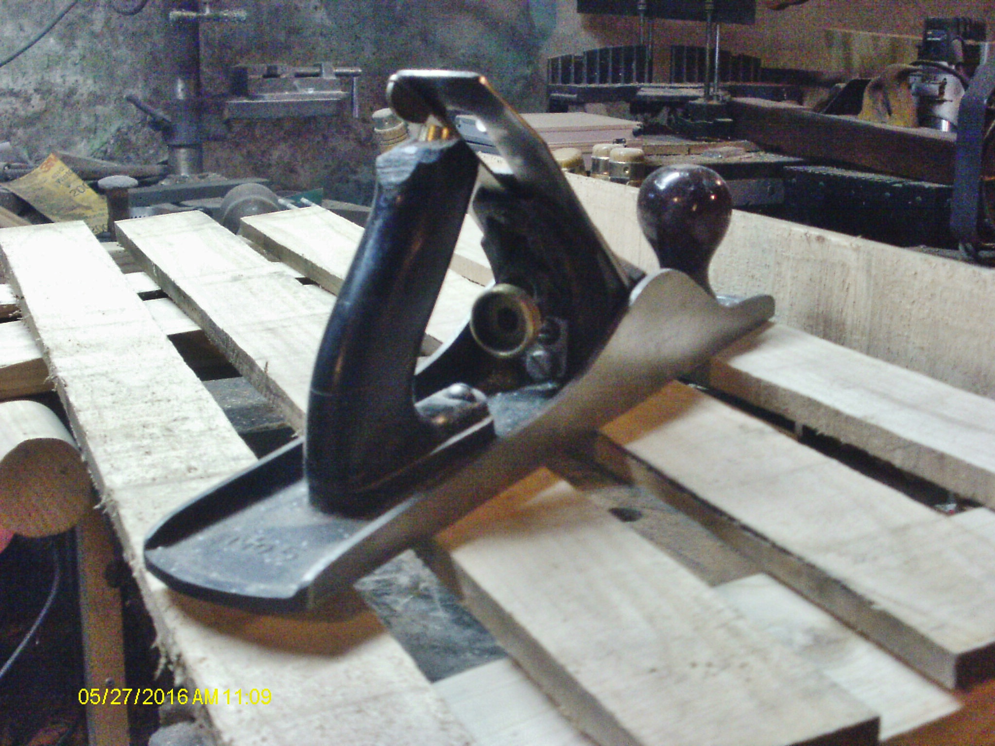

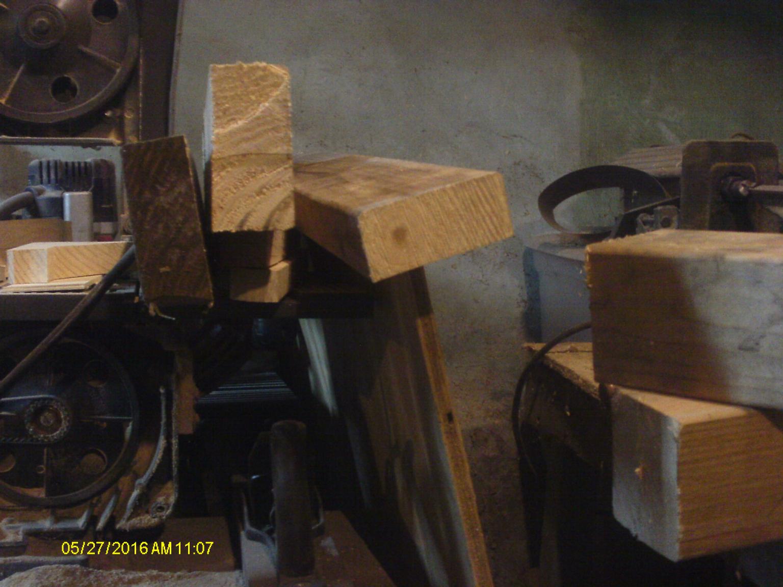

May 27, 201610 yr comment_66554 Had to resaw one of these things.. Cut one down to 26" long ( less to resaw) then marked it for a 2" or so wide cut. Set the extras aside.. After I had resawn the slab off. Then made a bunch of lines, to make 1/2" thick slats. I had one of the sides to the rocker on the bench, to lay out mortises for the back rails. I left the rails sit in place, as a spot to lay the slats as each came off the bandsaw... A little rough? We do have ways to deal with "rough" I laid the slats out to get the spacings, and see just how many slats I would need to make. Need a lot of plane work at the moment, and some tenons cut on the ends of the slats. I had went and bought a couple of 3/16" dowels to pin some joints with. Why buy fancy pins, when the rocker is scheduled to be painted, anyway. I also laid out a tenon on the end of the front post As there will be a through tenon to hold the armrest in place......with wedges, too. As for working in this shop? Welcome to the Dungeon Shop! This is about it for work space. I can walk around the bandsaw, to access other items.. I can move things around in here, as needed, and the lathe is to the right of the picture, buried as usual. When I need to run the lathe, I can move things around again. This space also allows access to a few handsaws.... There are a few "out & about" at the moment, these are in case I might need a saw. Might have enough? Maybe later, IF the bench can be cleaned off, I can go back into tenon-mode.....we'll see. Stay tuned to this "Batty Channel", same "Bat Time, same Bat-Channel" Report

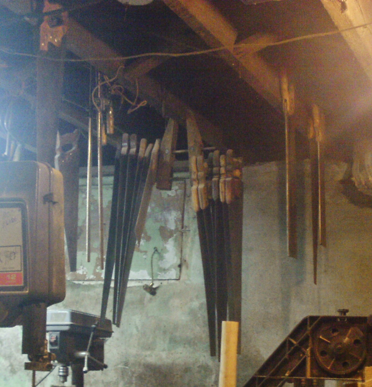

November 29, 20197 yr comment_210655 I see a lot of wasted space up in them rafters ... But some slats across the bottom of them and you can slide lots of different things up in them.... Report
