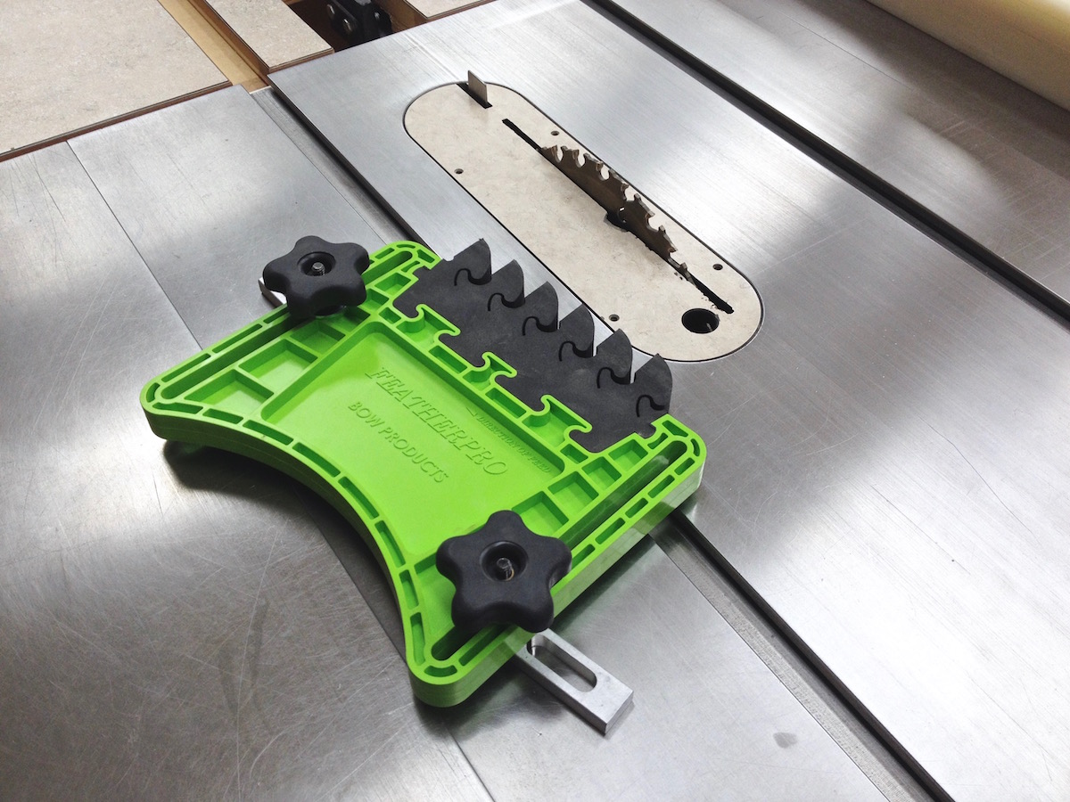

Allen Worsham Posted April 5, 2016 Report Posted April 5, 2016 I came across an ad for a new type of feather board and found it very interesting. So I thought that I would share it here on TPW. I have a few different feather boards with most of them locking into the slot on the table saw top and I have one of the magnetic ones (which I really like by the way as I can use it for wider boards beyond the table saw slot). http://www.featherpro.com/ Joeb41 1 Quote

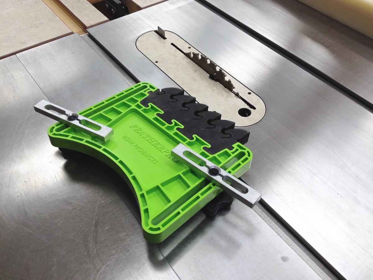

Todd Clippinger Posted April 19, 2016 Report Posted April 19, 2016 And you can see they are not limited to a T-Track they can be used in the simple miter slot such as on my DeWalt job site table saw too. Quote

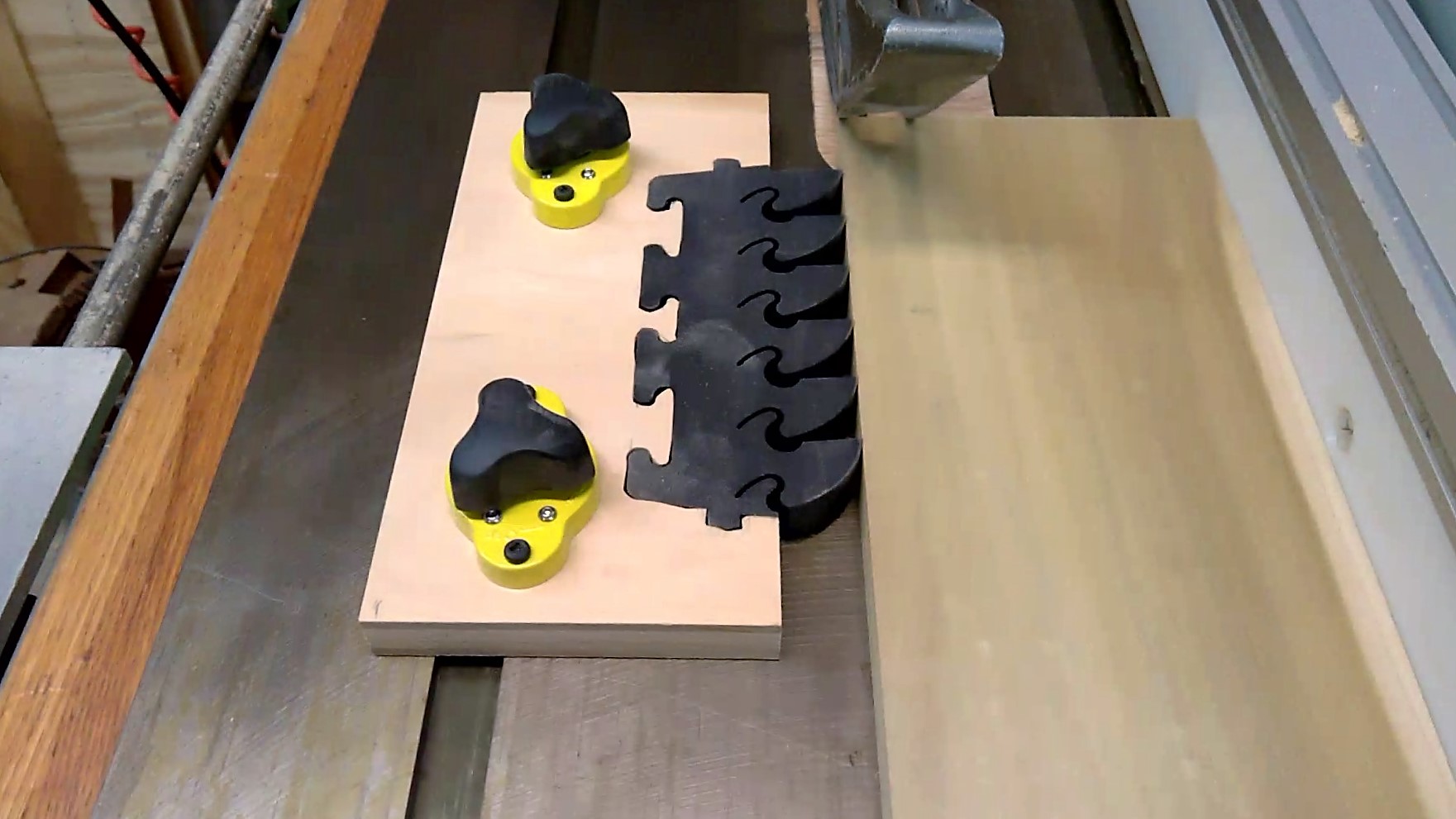

RJH30518 Posted August 21, 2016 Report Posted August 21, 2016 I received the featherpro inserts on Friday and went out to the garage to trace them out on a piece of 3/4 ply and cut out a holder. Then drilled 2 hole for the magswitches and mounted it on the saw to see how it would work. Fantastic -- they really hold a board --- the board easily slide easily forward, but I tried to pull the board backwards -- an it did not move at all. I did not try an actual kickback, but it should hold the board. Cutting the shape around the insert was pretty easy on a scroll saw -- you can see a few spots where you can see light through it, but it still holds the inert without any problems. For me, this is a lot easier to use with the mag switches than using a miter slot ... I may make it over with the switches on the ends of the insert so that a wider board can be used -- as you can see from the pics, it is limited on how much metal is there for the switches to work with. Quote
lew Posted August 21, 2016 Report Posted August 21, 2016 Nicely done! Agree with your assessment on the Mag Switch location and maybe a little longer piece of ply. Quote

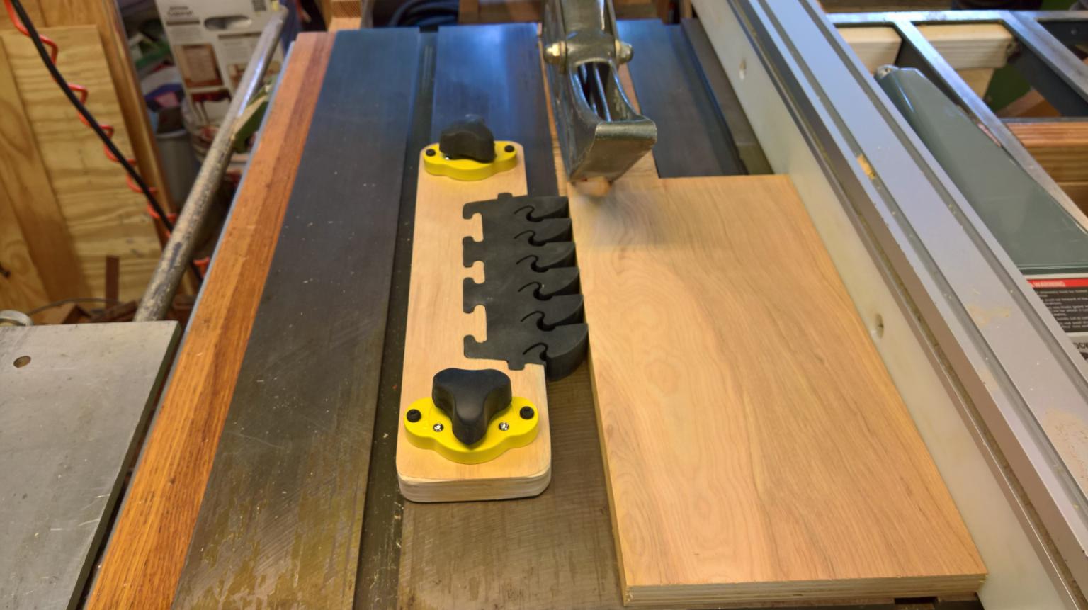

RJH30518 Posted August 21, 2016 Report Posted August 21, 2016 Here is the second one -- with the magswitches on the end ... I think that this will work better. Quote
Allen Worsham Posted August 25, 2016 Author Report Posted August 25, 2016 On 8/21/2016 at 2:54 PM, RJH30518 said: Here is the second one -- with the magswitches on the end ... I think that this will work better. I like that custom Mag Switch idea very much! I have a Mag Switch feather board with the plastic fingers that I use all the time on my Jet Table Saw, but I could really use 2 feather boards for longer boards and I like the the ease of pushing the wood through the foam feathers. Joeb41 1 Quote
