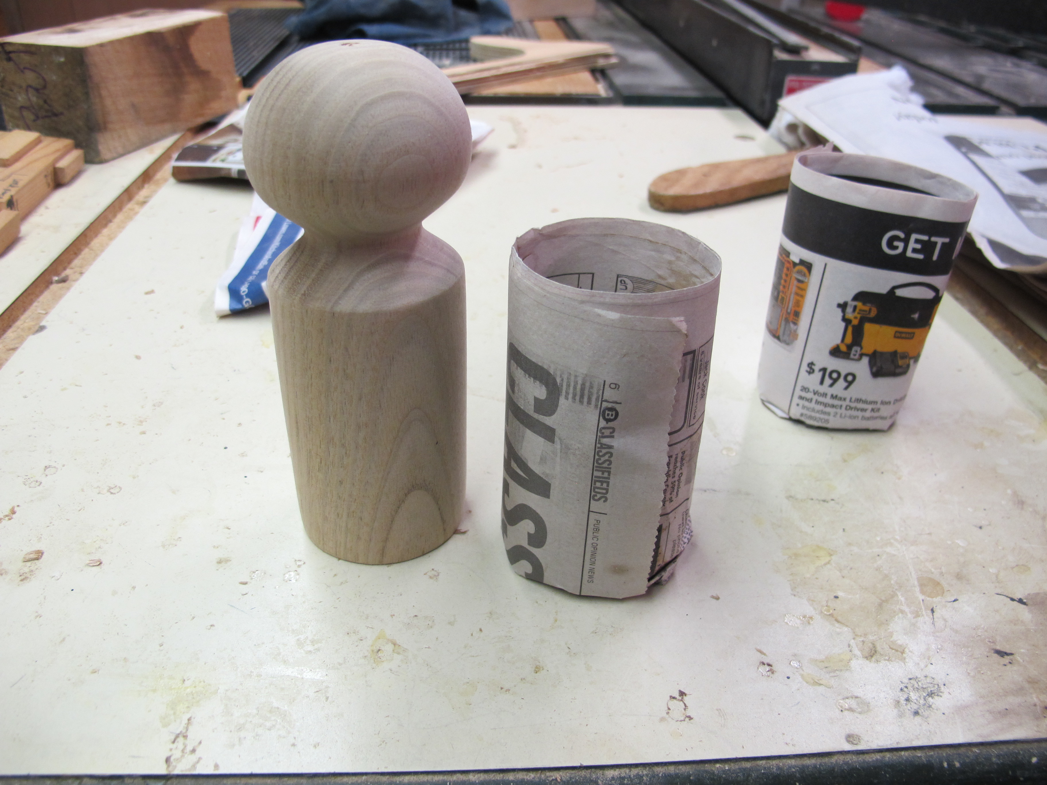

Recently, my sister sent me a picture of a seed starter pot maker. She thought that it would make a nice gift. I'm not sure if that was a hint, but.....
56f3273d95116_seedpotmaker.jpg.ee294493f
I spent a little time searching for dimensions and drawings but couldn't really find too much. How tough could it be?!

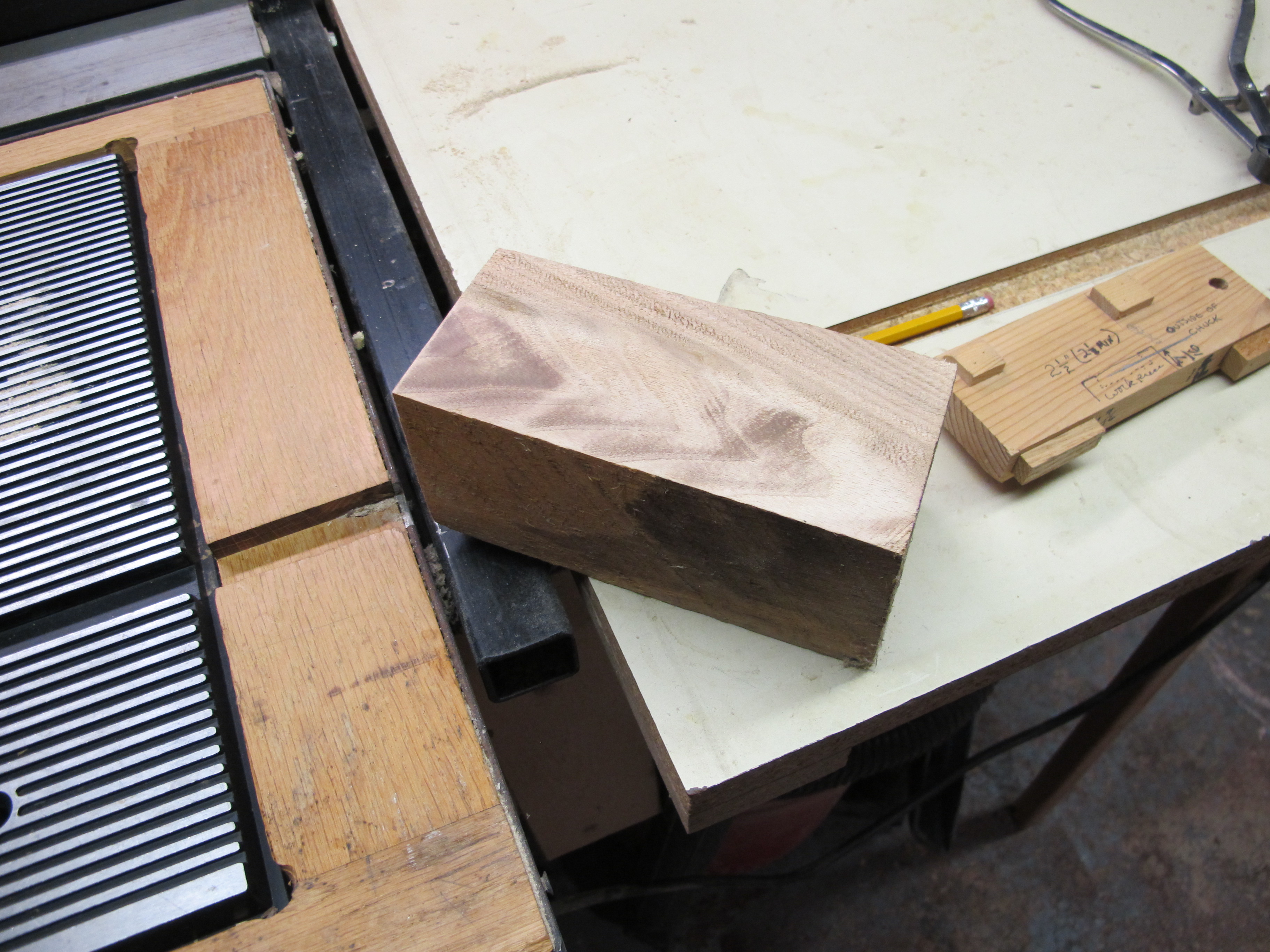

I had a cutoff chunk of butternut left over from a bowl turning and made it into a squared blank.
56f3268c826cd_Butternutblank.thumb.JPG.6

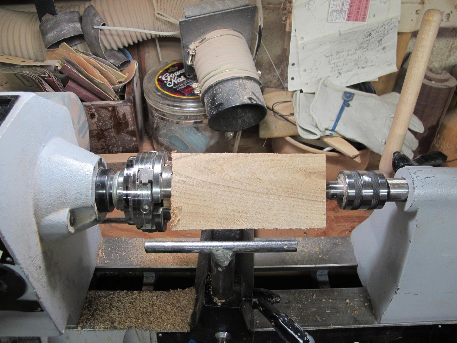

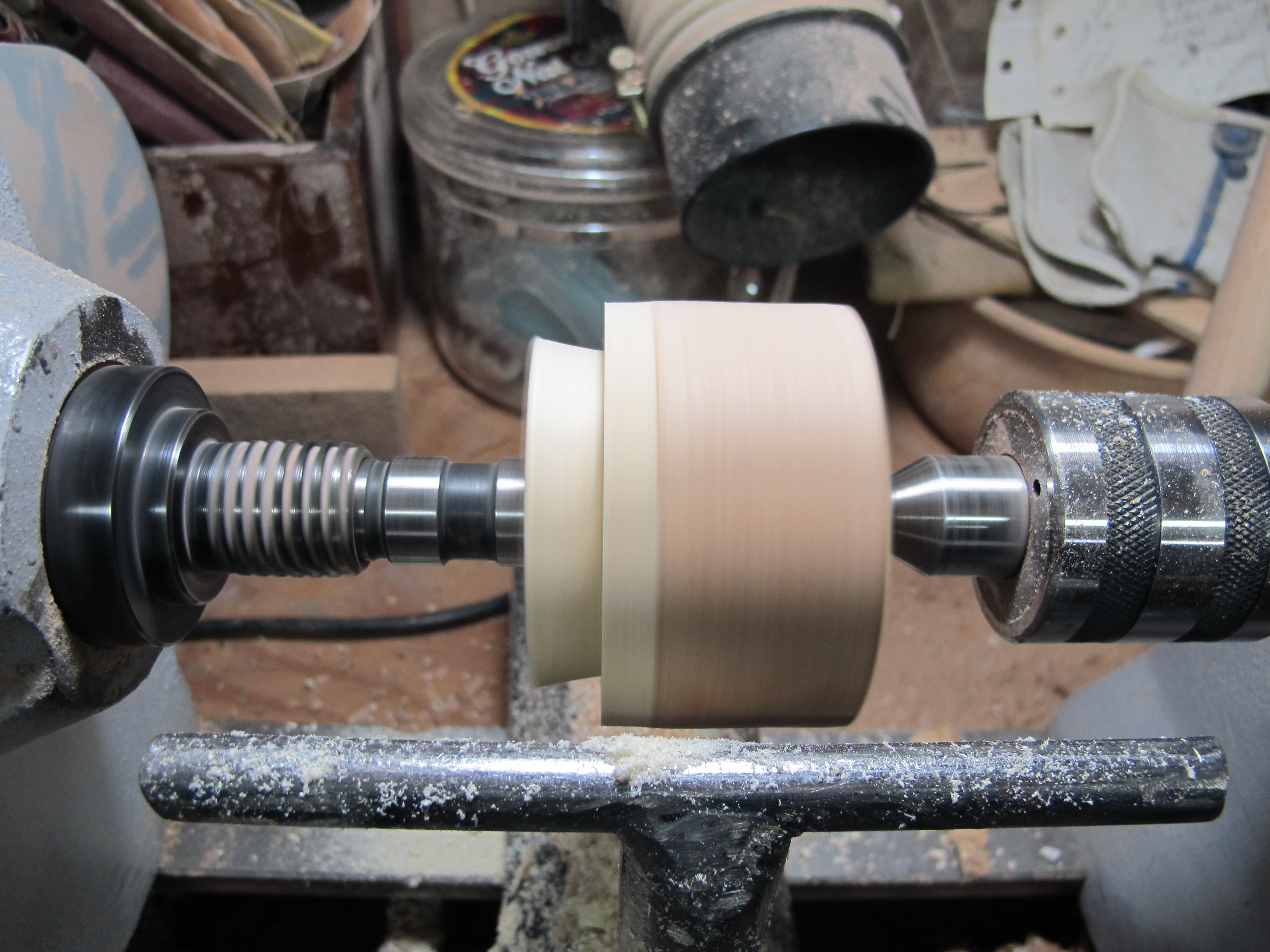

Mounted it on the lathe
56f327187171b_onlathe.thumb.JPG.3f1fe136

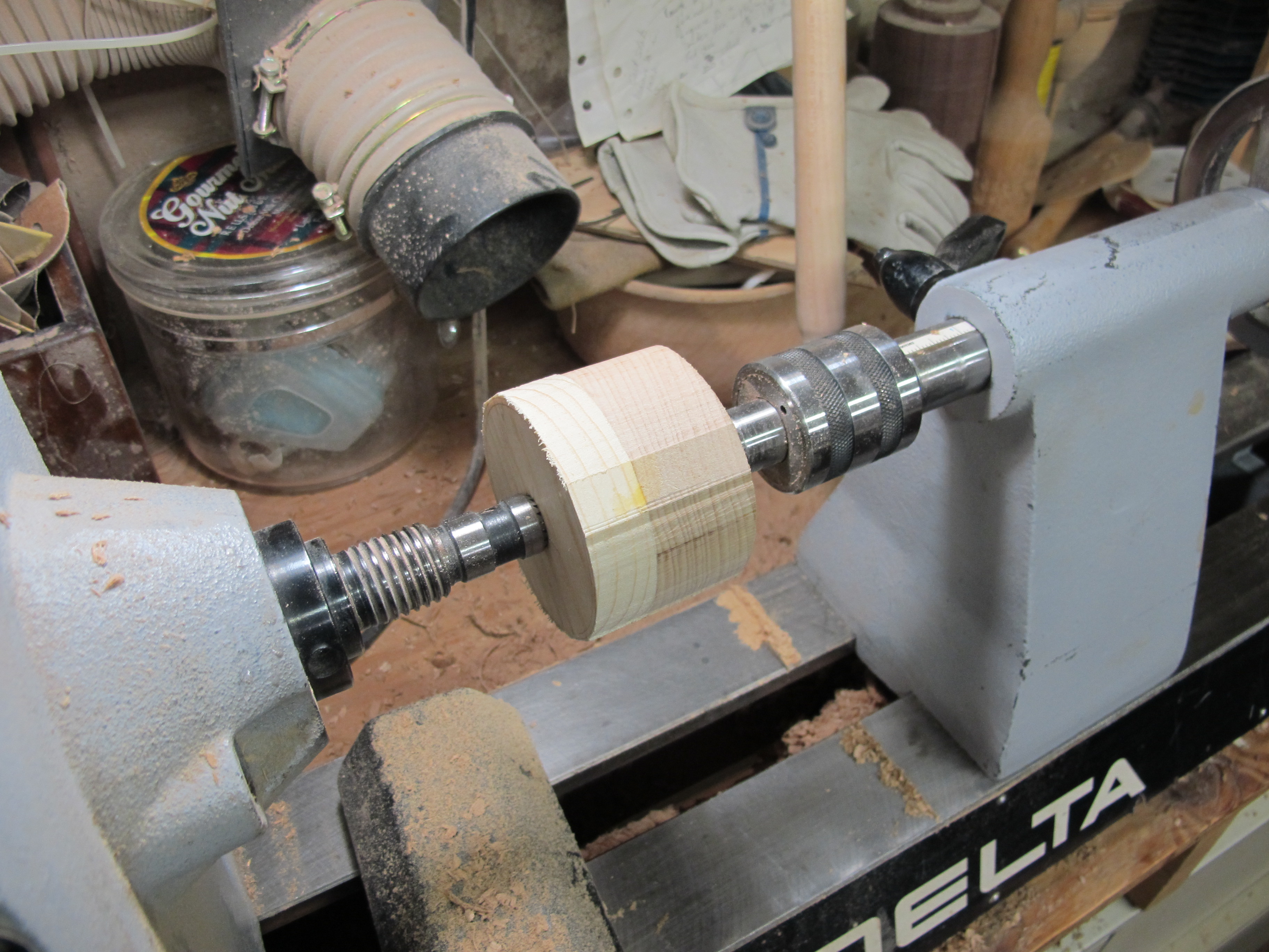

remounted the blank
56f326cc19a2c_inchuck.thumb.JPG.22d43265

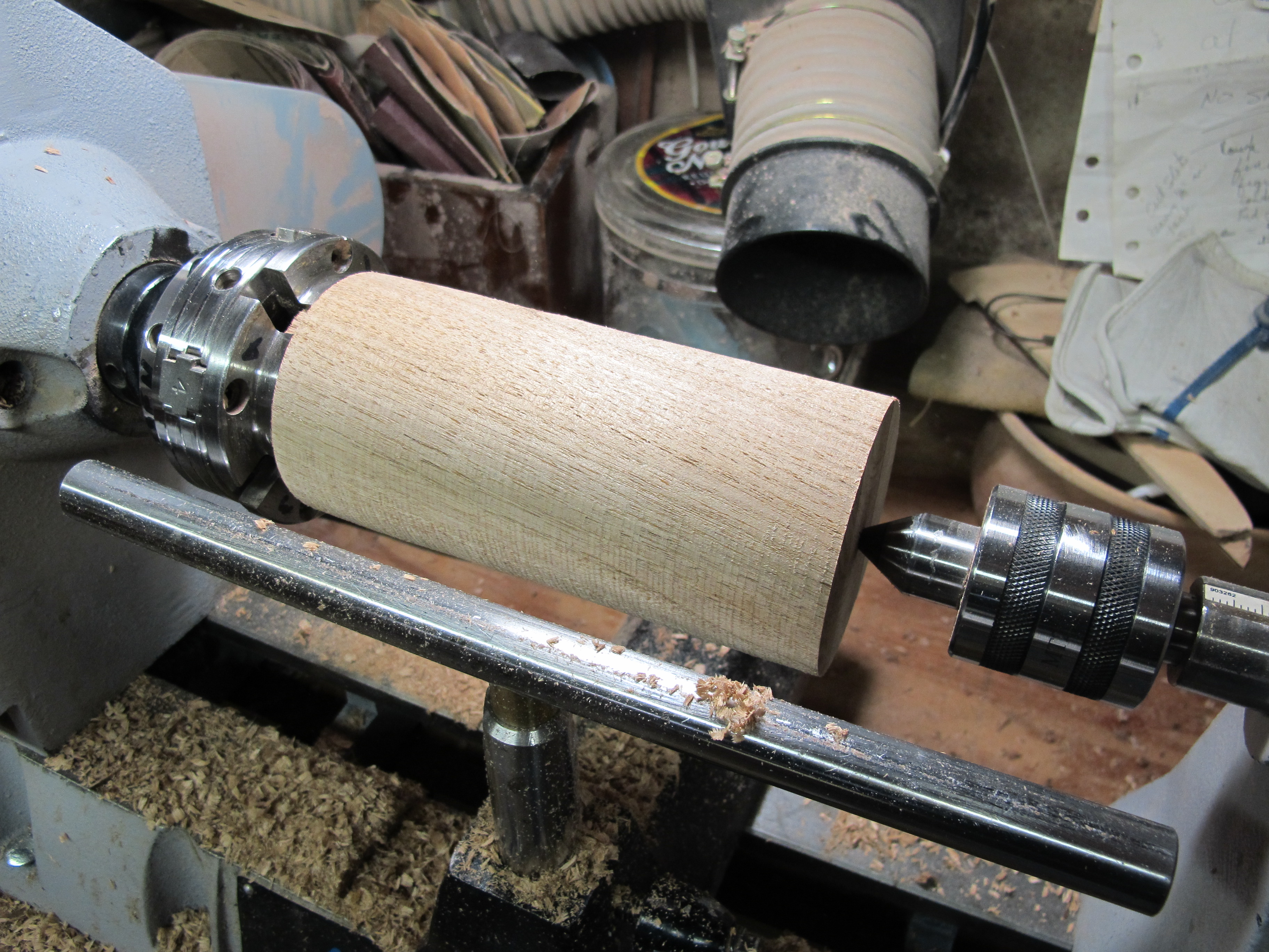

Turned it round
rounded.thumb.JPG.481da30a6409f26d456a5e

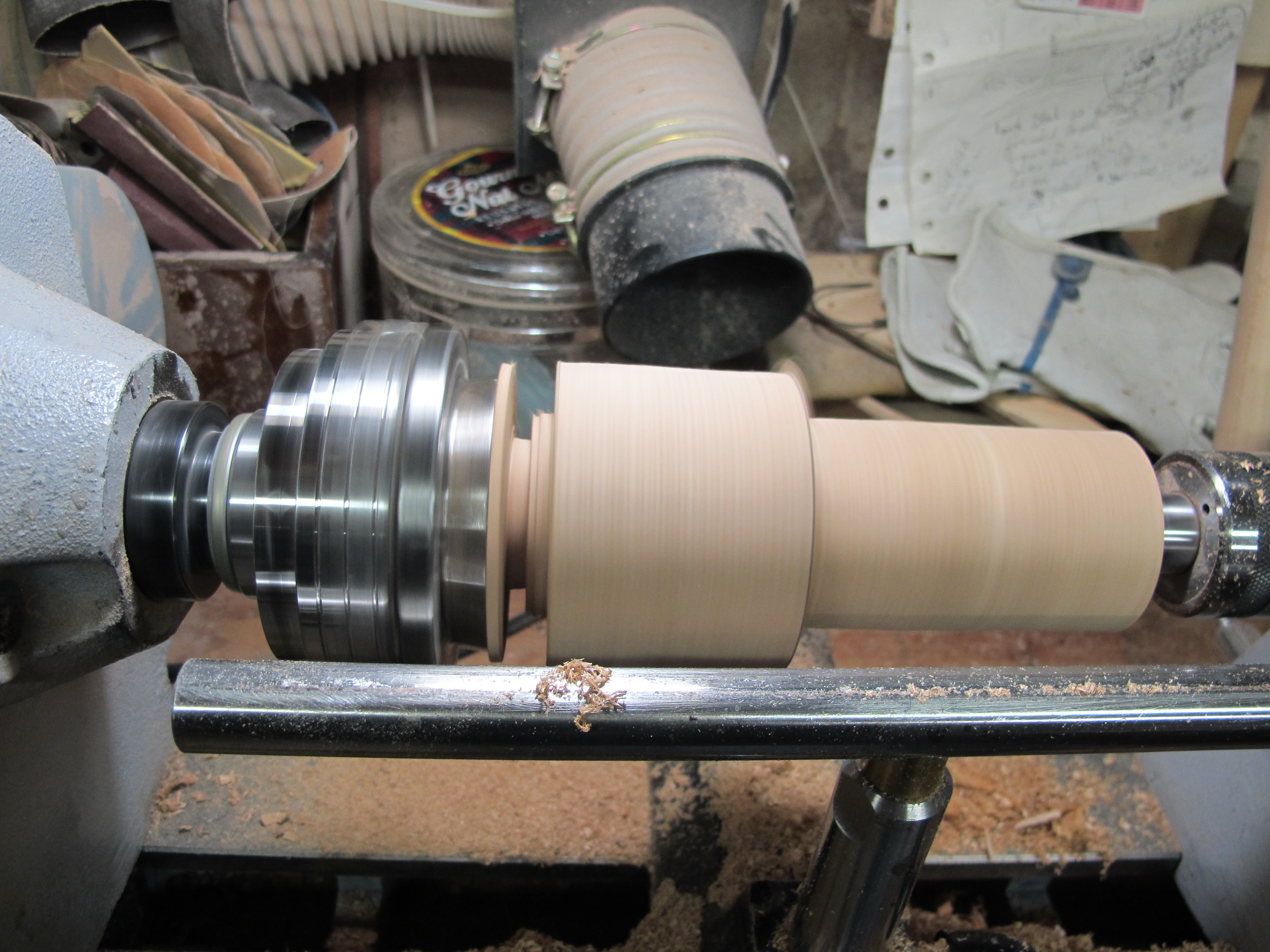

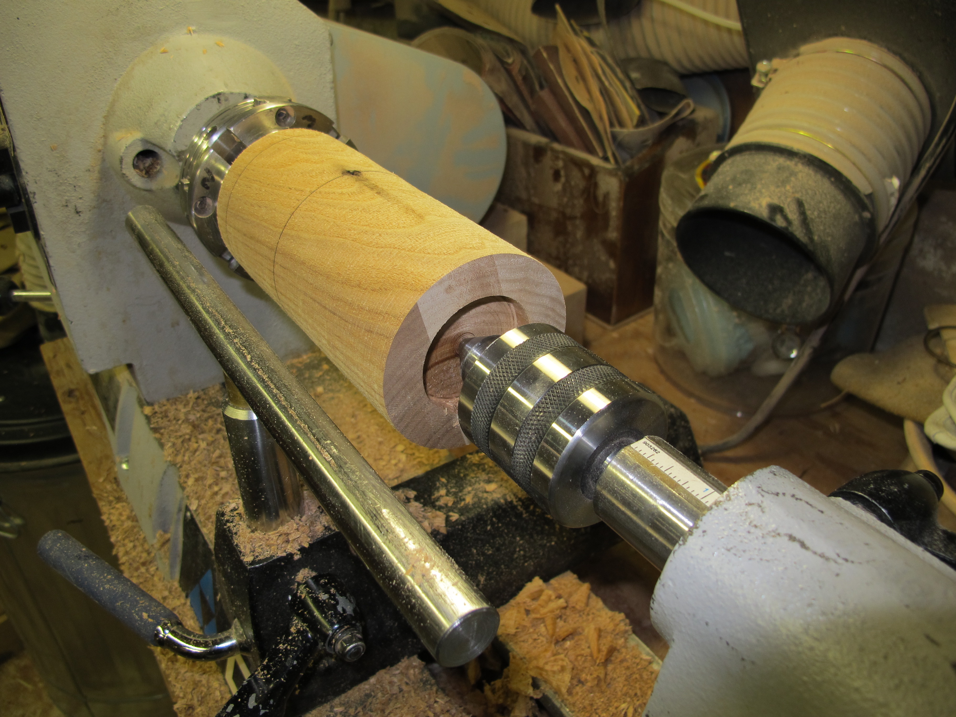

Used a 1 3/4" Forstner Bit to drill a recess. Just guessed at the depth needed. Close to 3/8"
56f3269ccc935_drilledrecess.thumb.JPG.57
56f3269a3b012_drilleddepth.thumb.JPG.10b

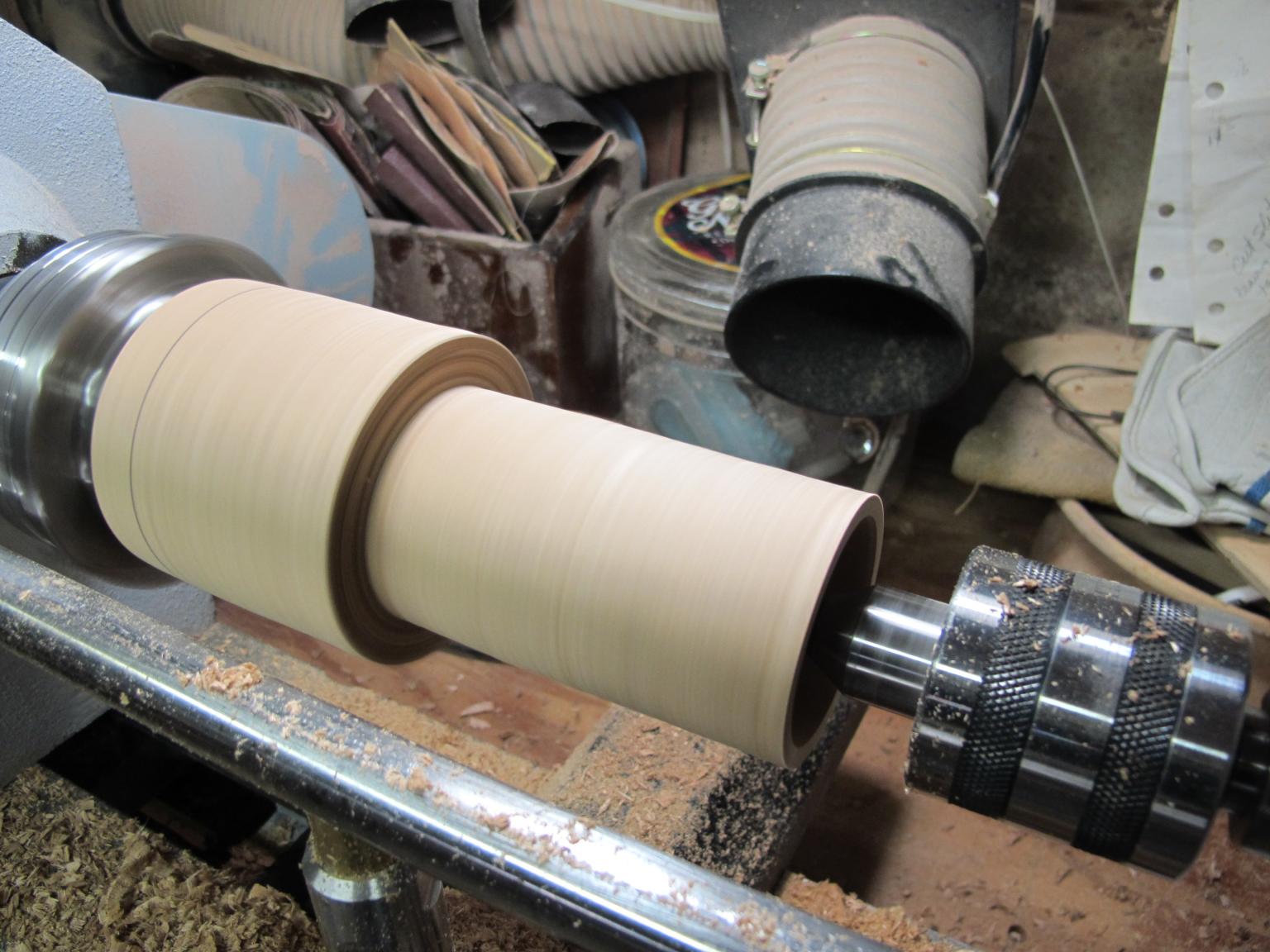

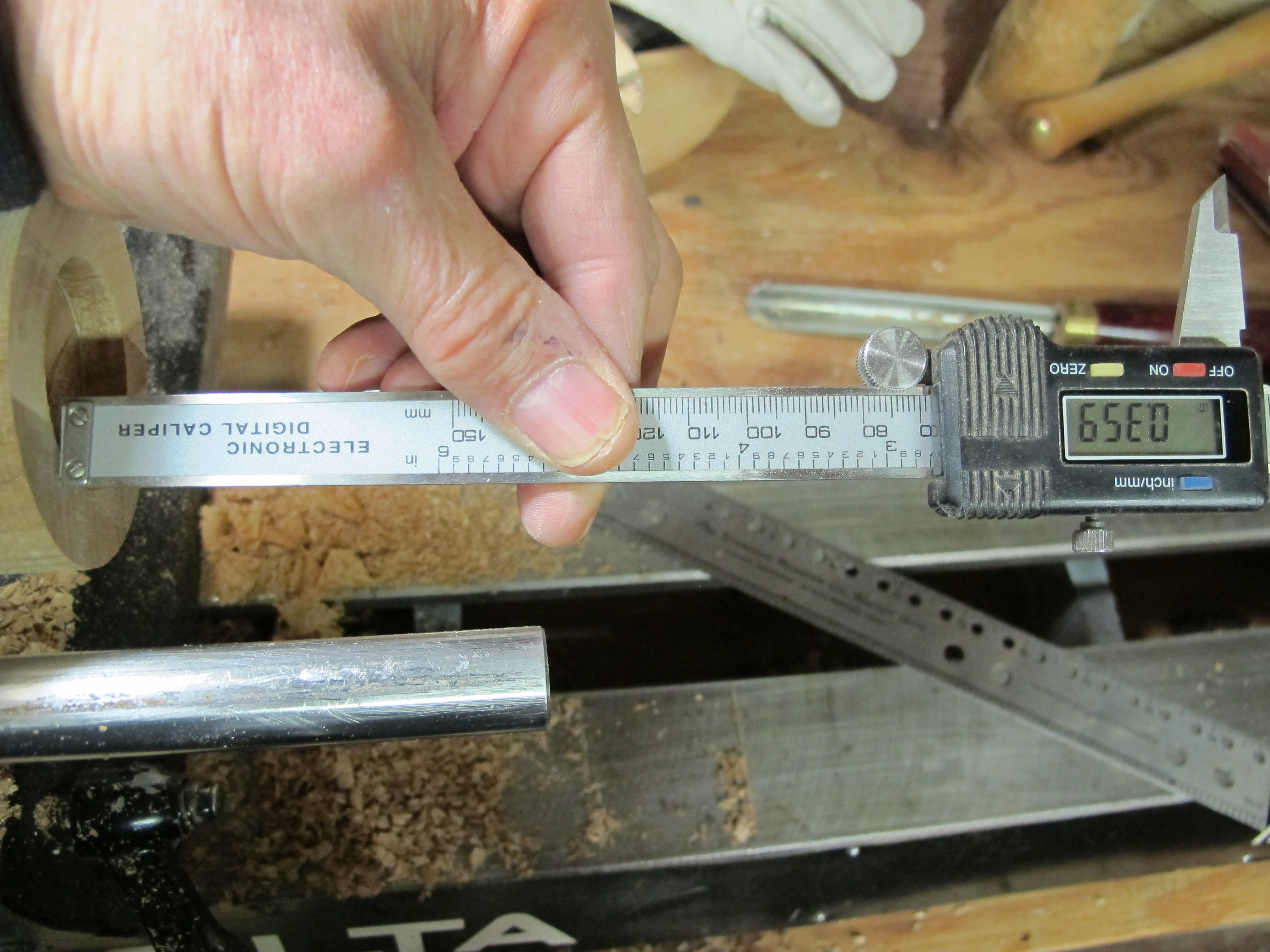

Set the depth for the diameter of the finished "pusher"
56f3274023abe_settingdiameter.thumb.JPG.
Reduced the diameter to the desired amount ~ 2"

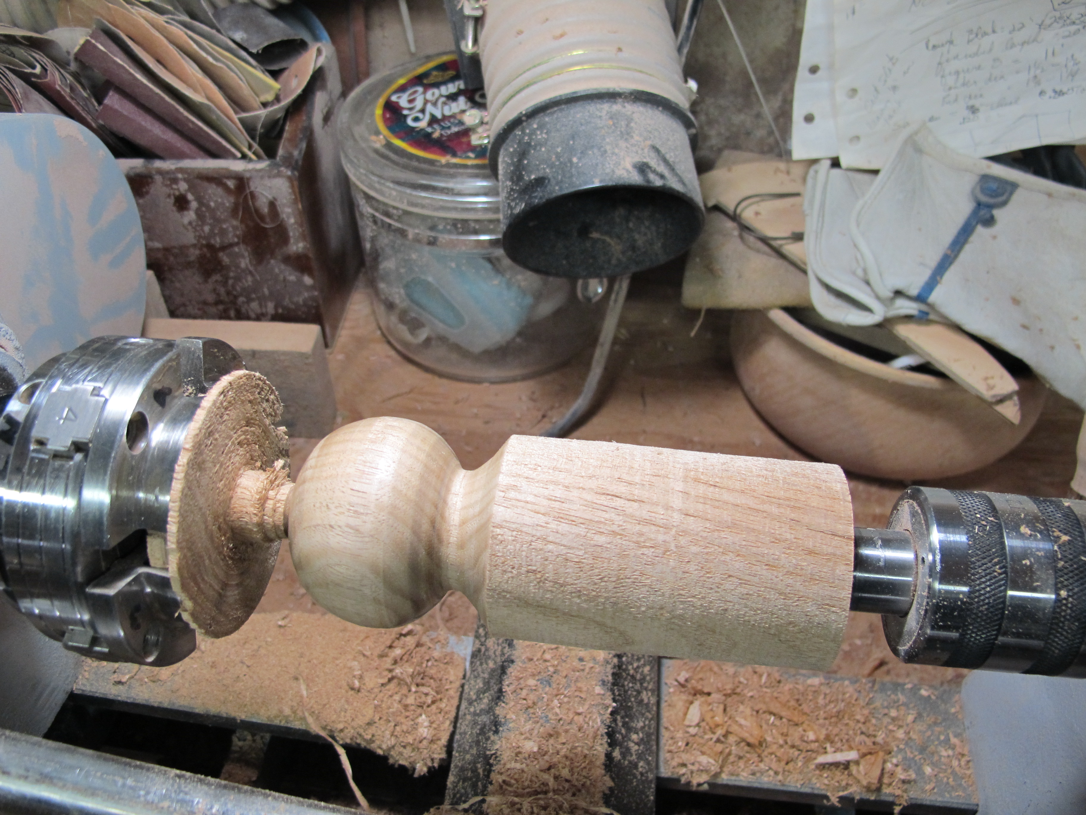

Created a "knob" head to make it comfortable to apply pressure
56f3272fbc6fb_prepingfortop.thumb.JPG.3e
56f32728ca0fd_toproughed.thumb.JPG.d8499

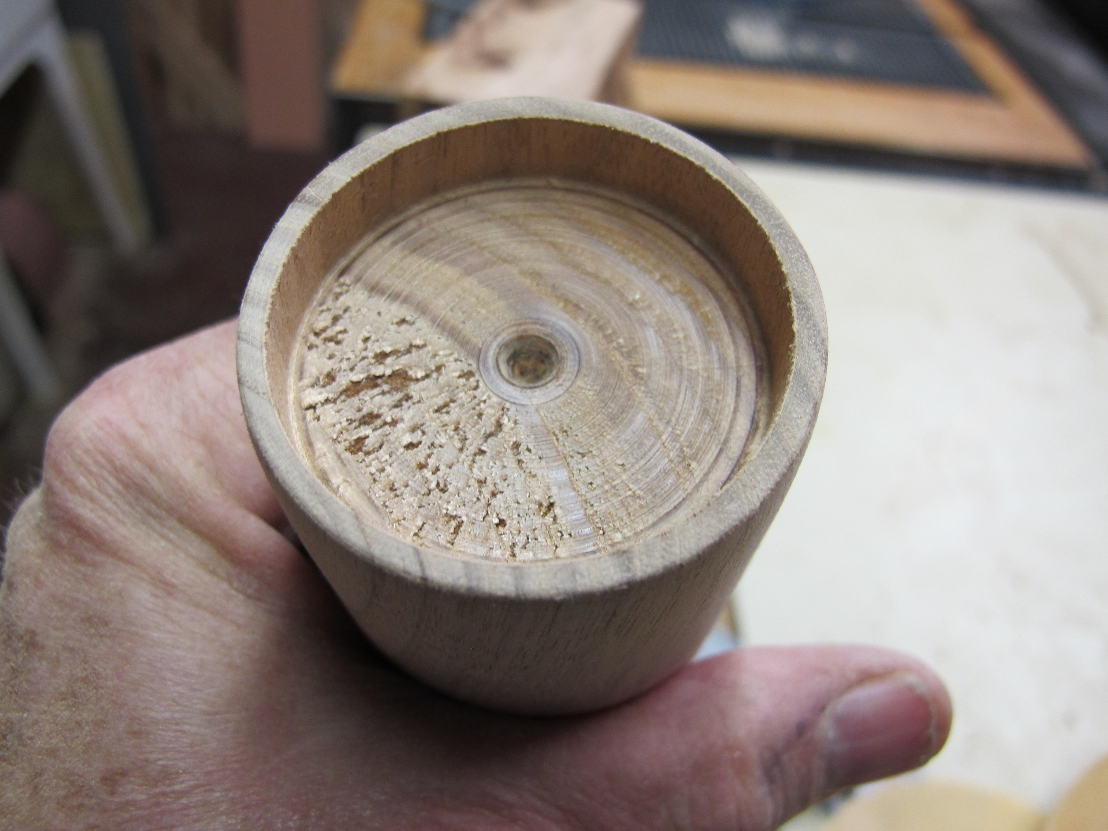

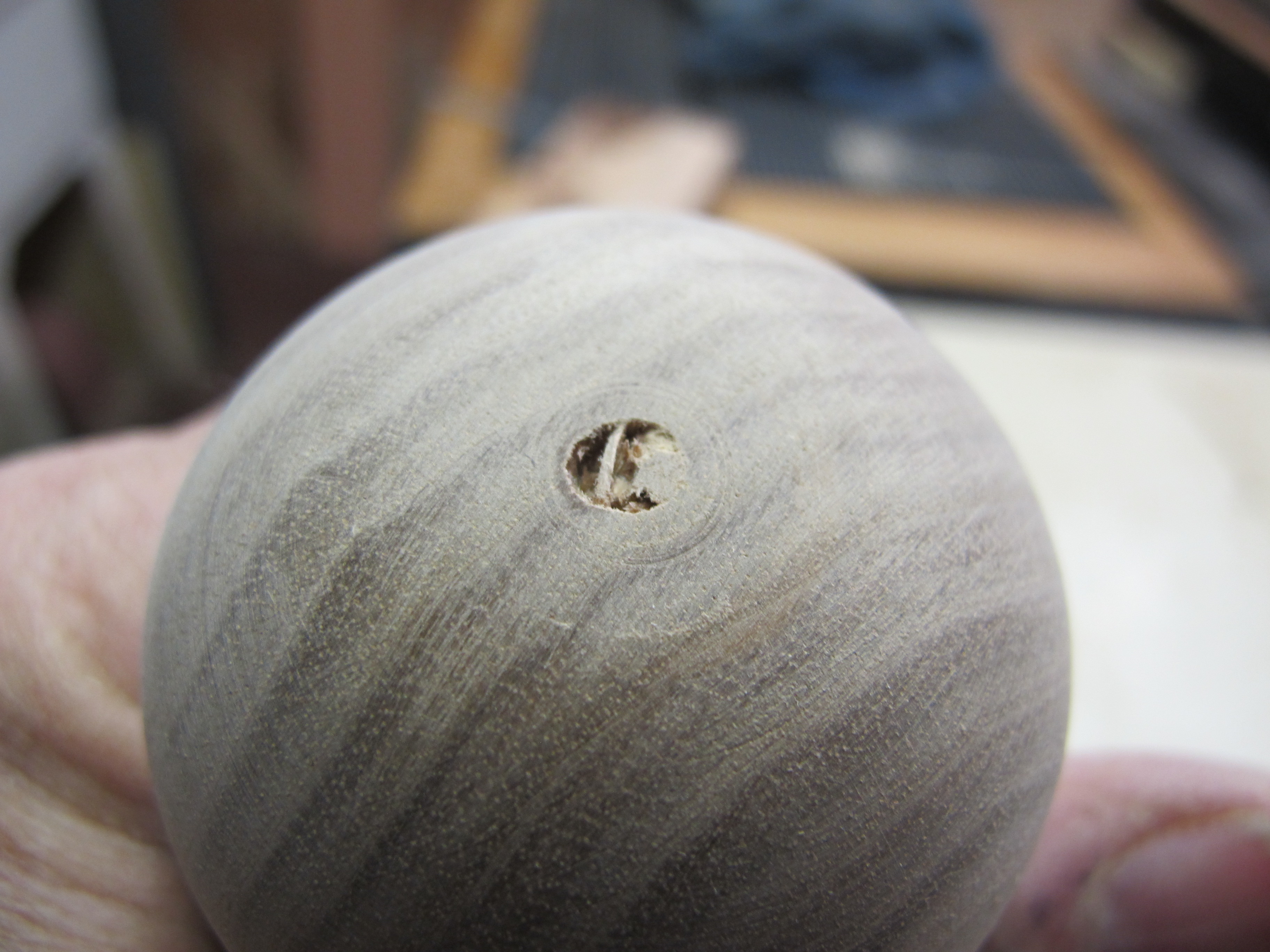

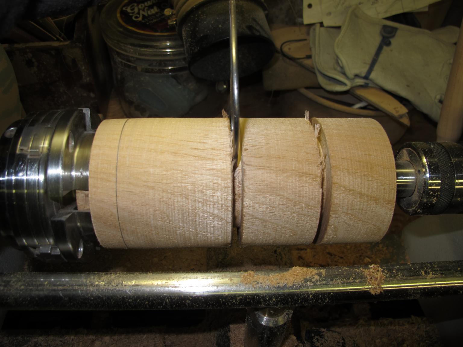

Final sanding and parted off this piece. Butternut is pretty soft . As I was parting it and holding the piece- to catch it when it released- I squeezed a little too hard and the wood fibers twisted off before the cut was complete.
56f3274477e77_softwood1.thumb.JPG.171e11
Even the Forstner bit used to drill the recess, tore some of the fibers
56f32747173ce_softwood2.thumb.JPG.e02551

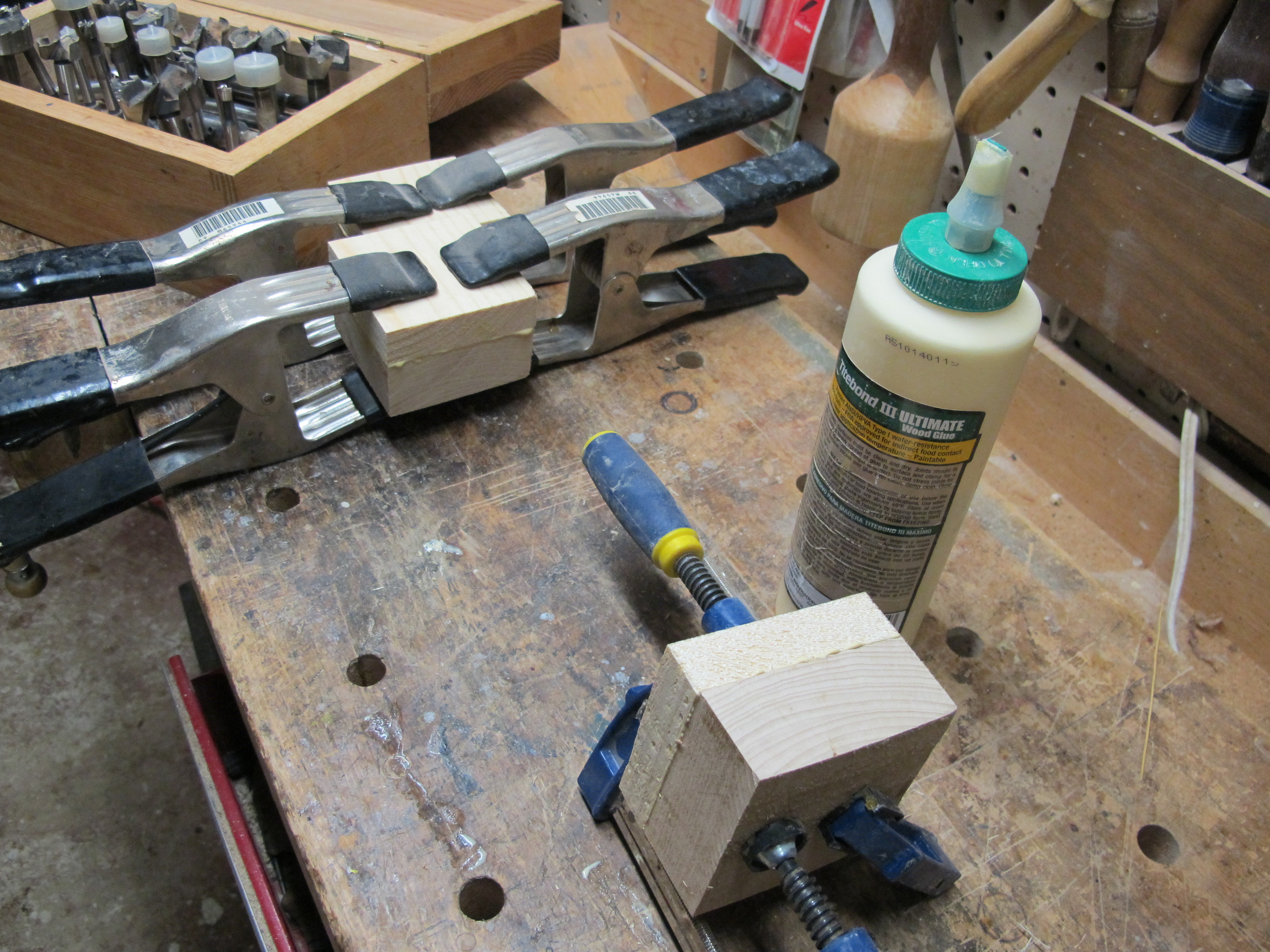

I still needed to make the base. I had some hard maple scraps left from a rolling pin and some pieces of pine from another project. I used the pine for a waste block, glued to the maple.
56f32686ad21d_baseblank.thumb.JPG.b22465

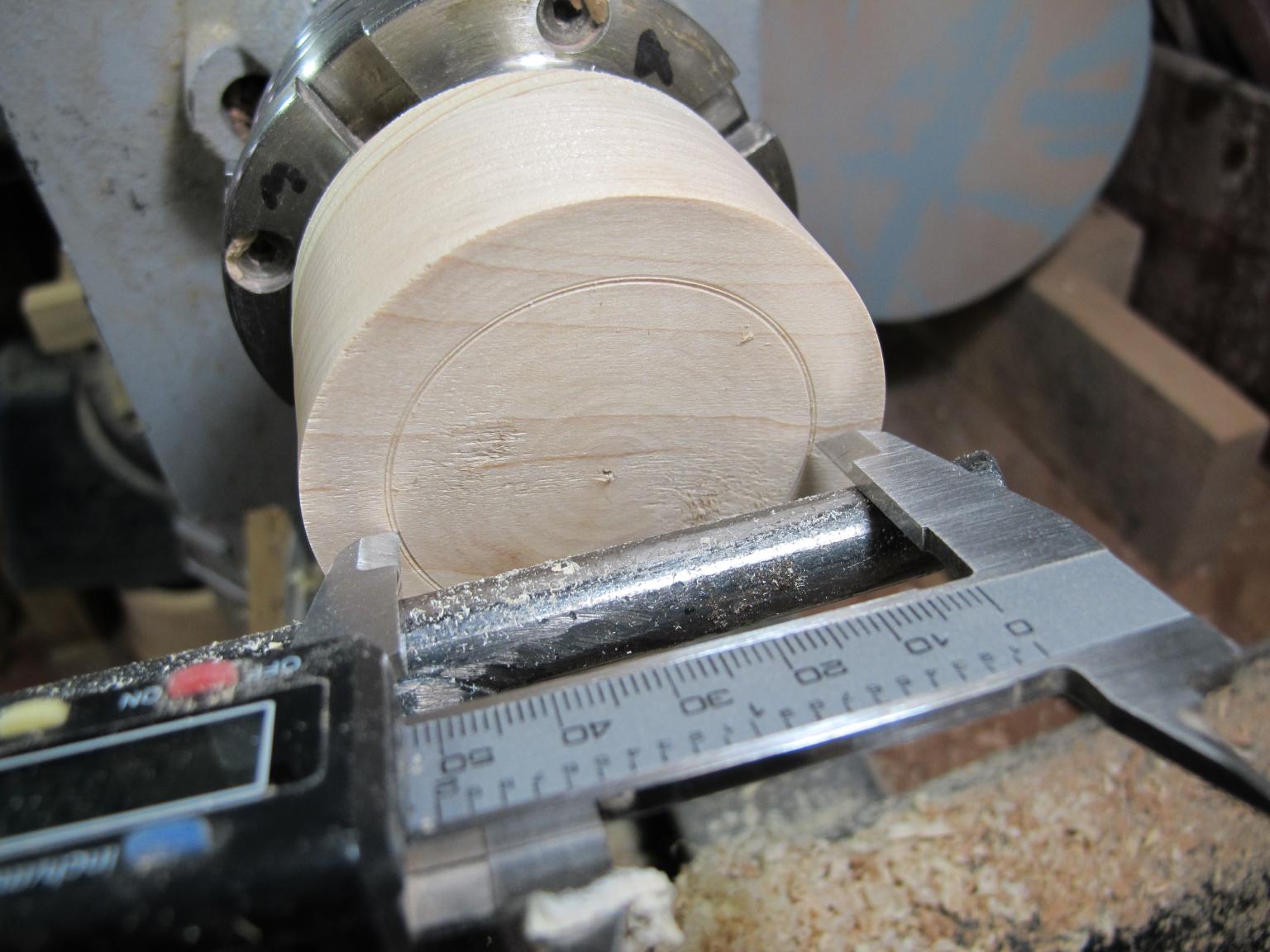

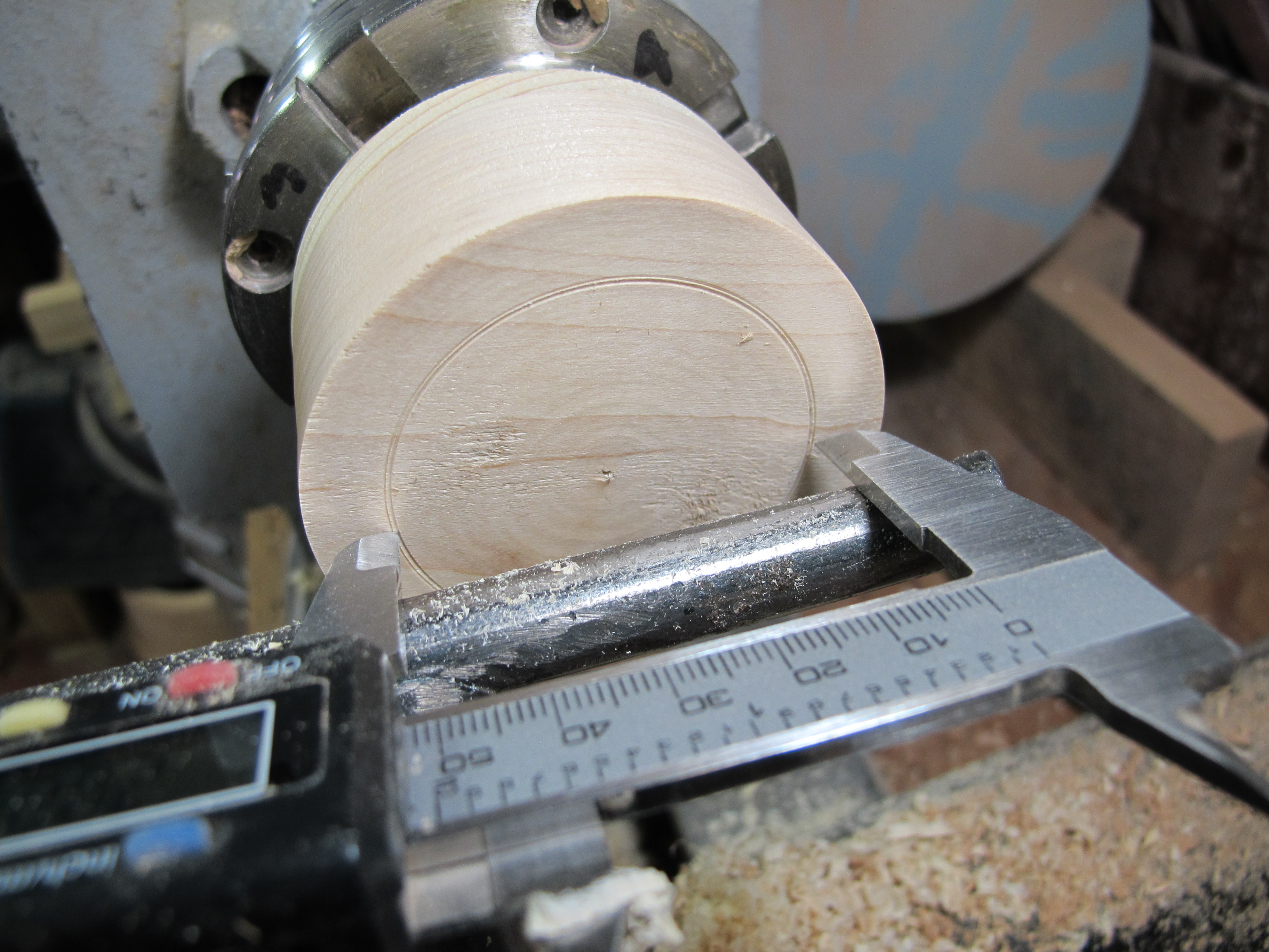

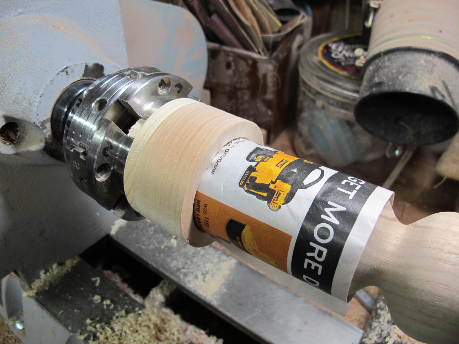

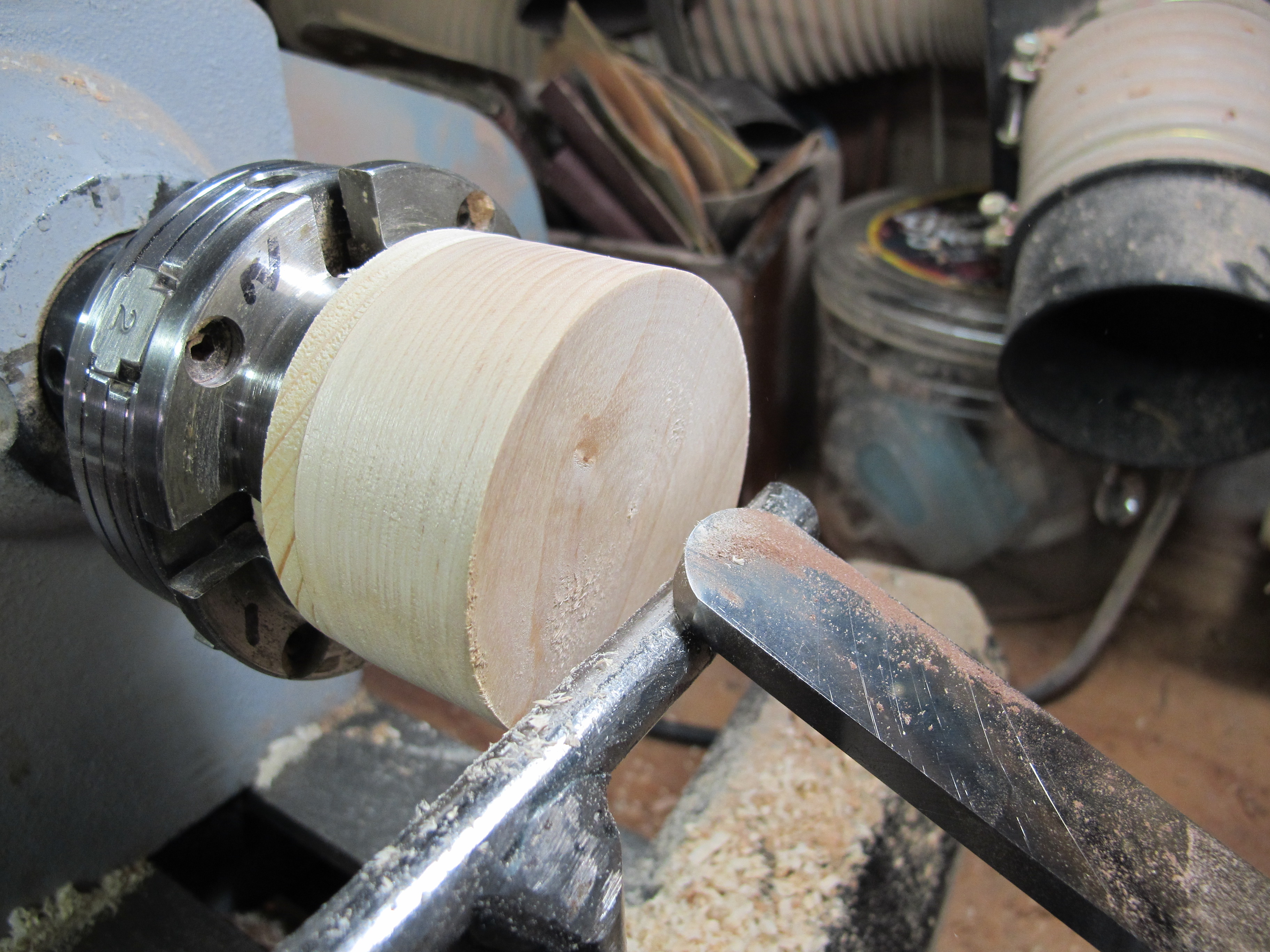

Remounted the base in the chuck and flattened the face
56f3267eb05bc_flattenface.thumb.JPG.24ff

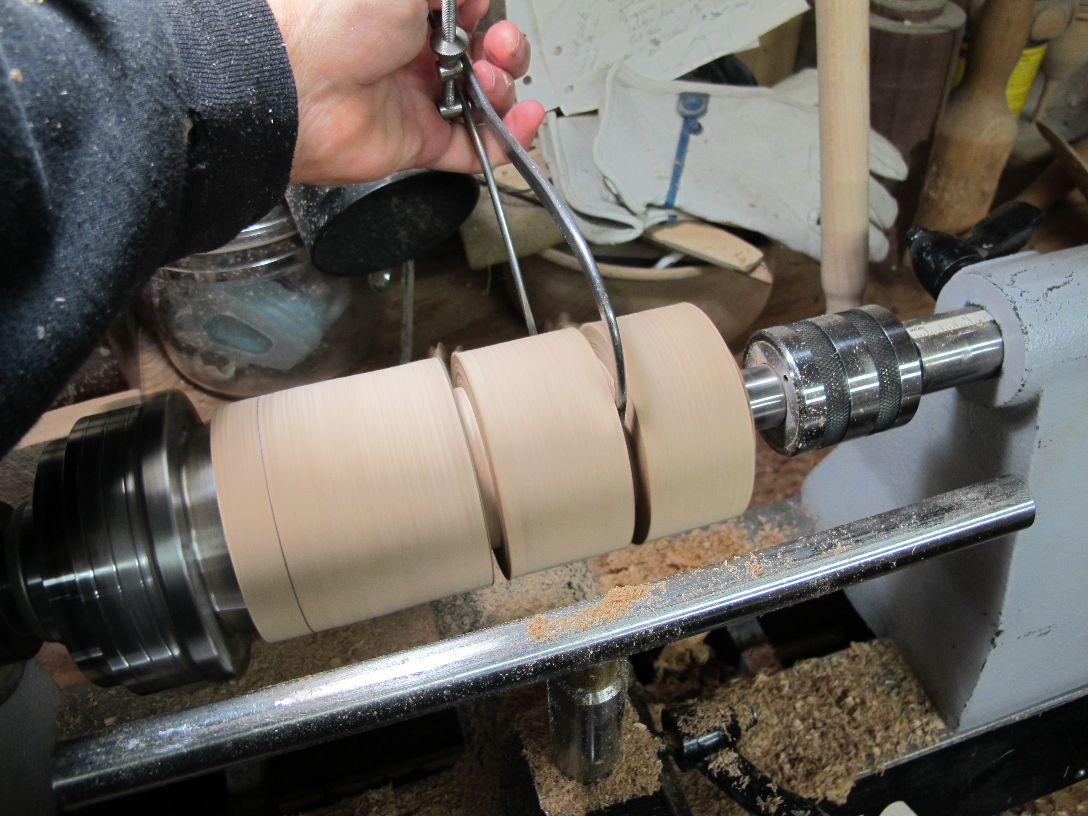

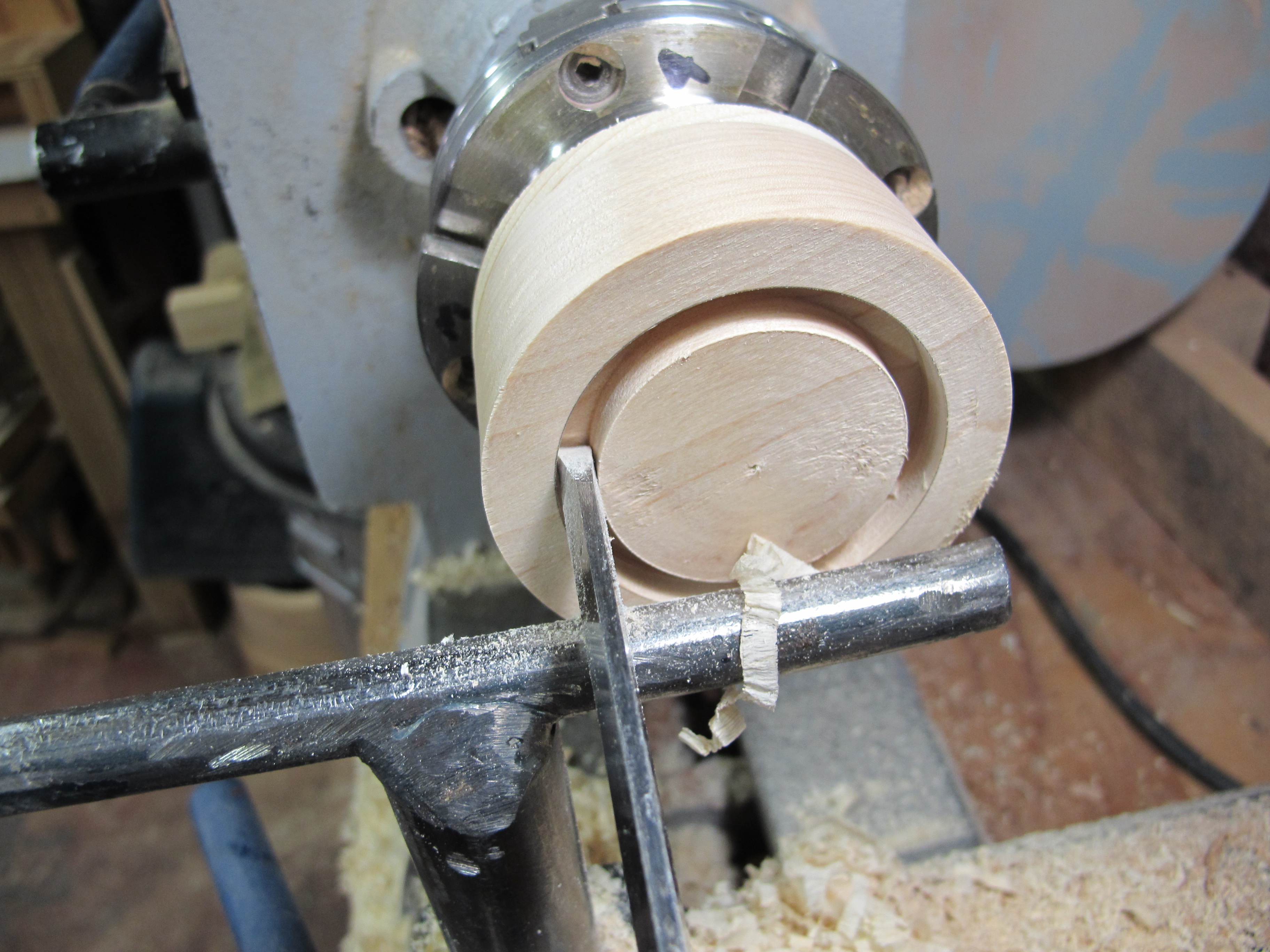

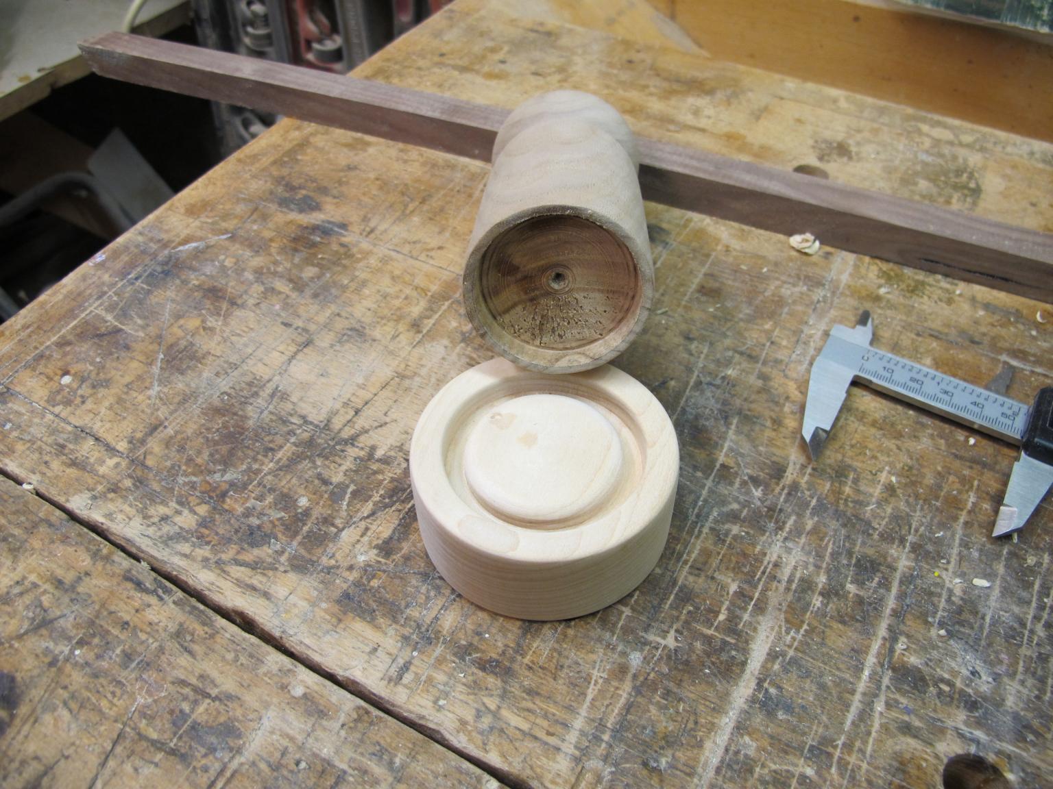

Next, I laid out and cut a groove into the base. The groove is slightly wider than the "rim" at the base of the pusher piece.
56f32736bc1a0_recesscut.thumb.JPG.2f8911
Added some chamfers to knock off the sharp corners
56f32739ed8a5_recessfinished.thumb.JPG.f

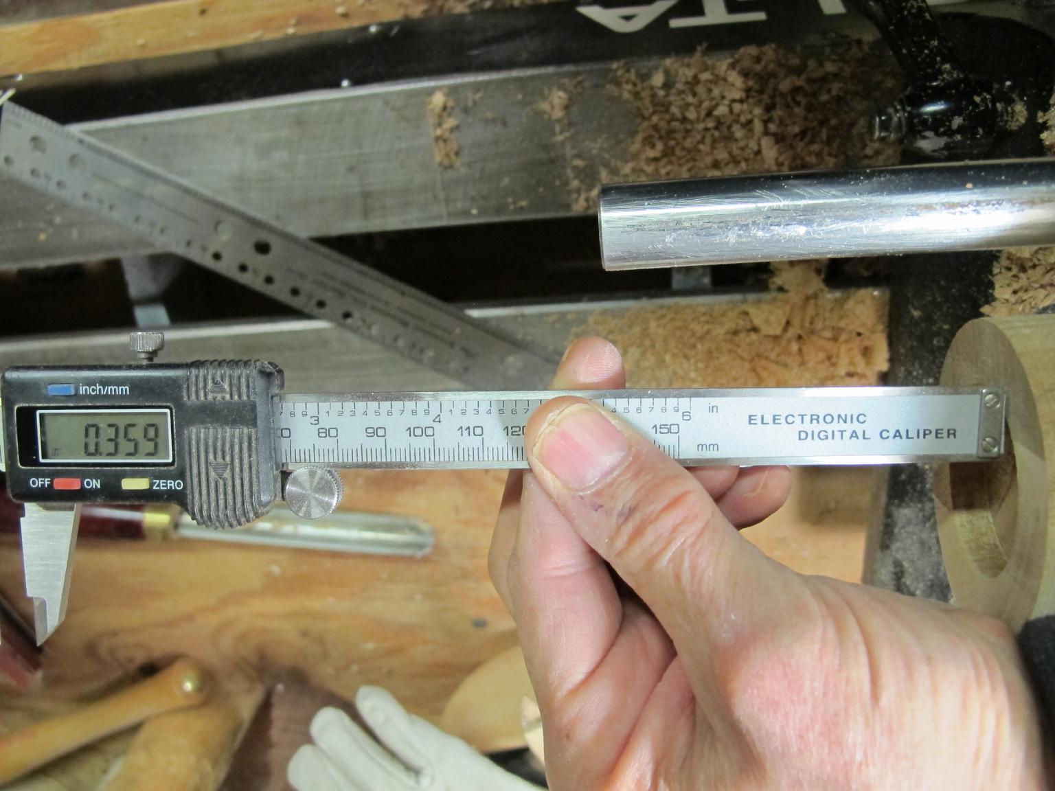

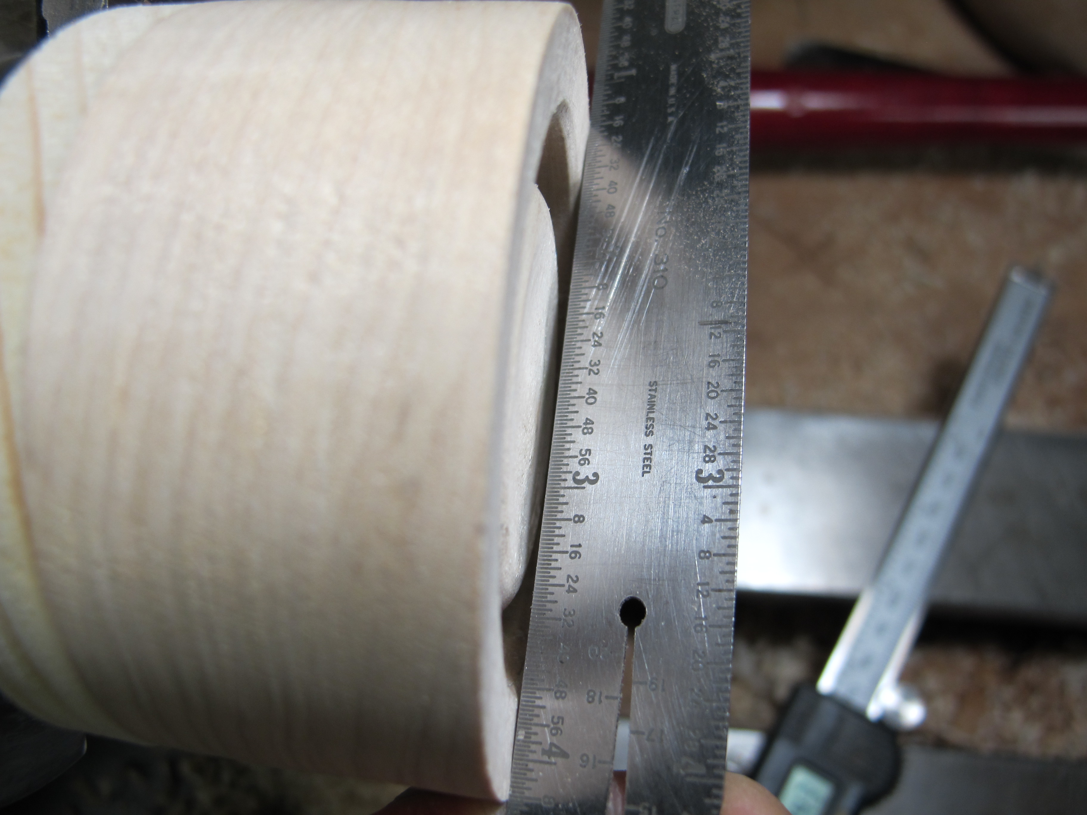

I went back and reduced the height of the "crimping" area to allow for the thickness of the newspaper at the bottom. I guessed at the correct spacing. Made it about 1/16"
56f32ce8e8929_resetdepth.thumb.JPG.9da4a

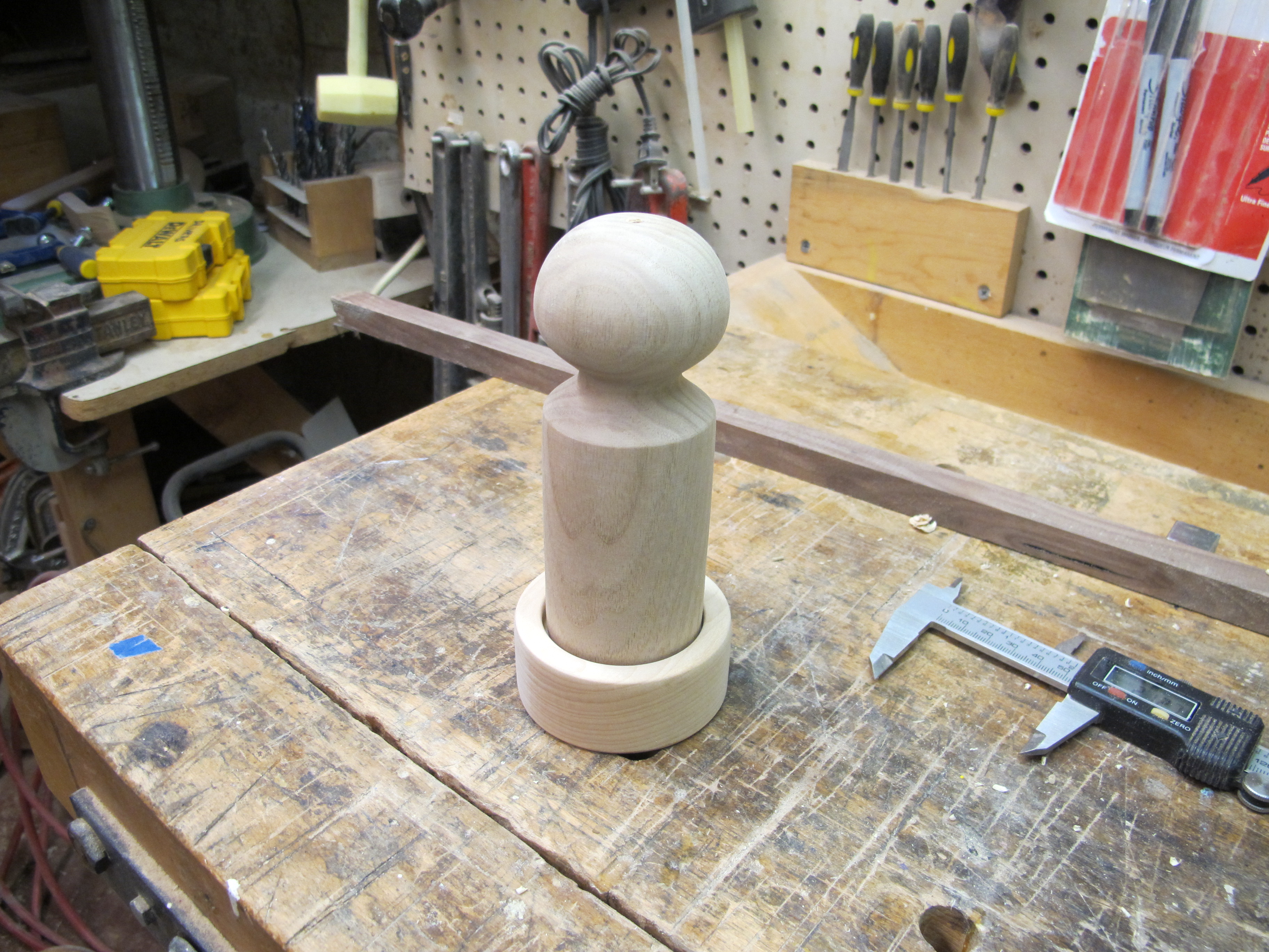

Sanded and parted off the base from the waste block. The completed "Seed Starter Pot Maker"
assembled.thumb.JPG.1e191d2902138d693903

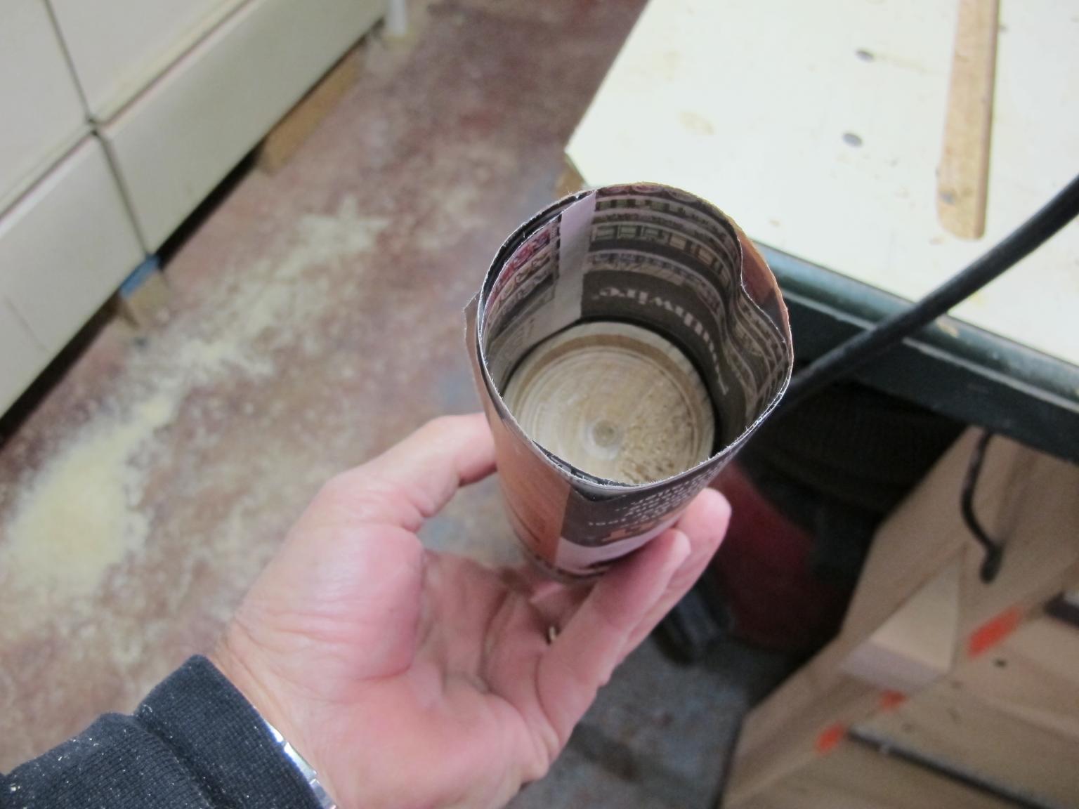

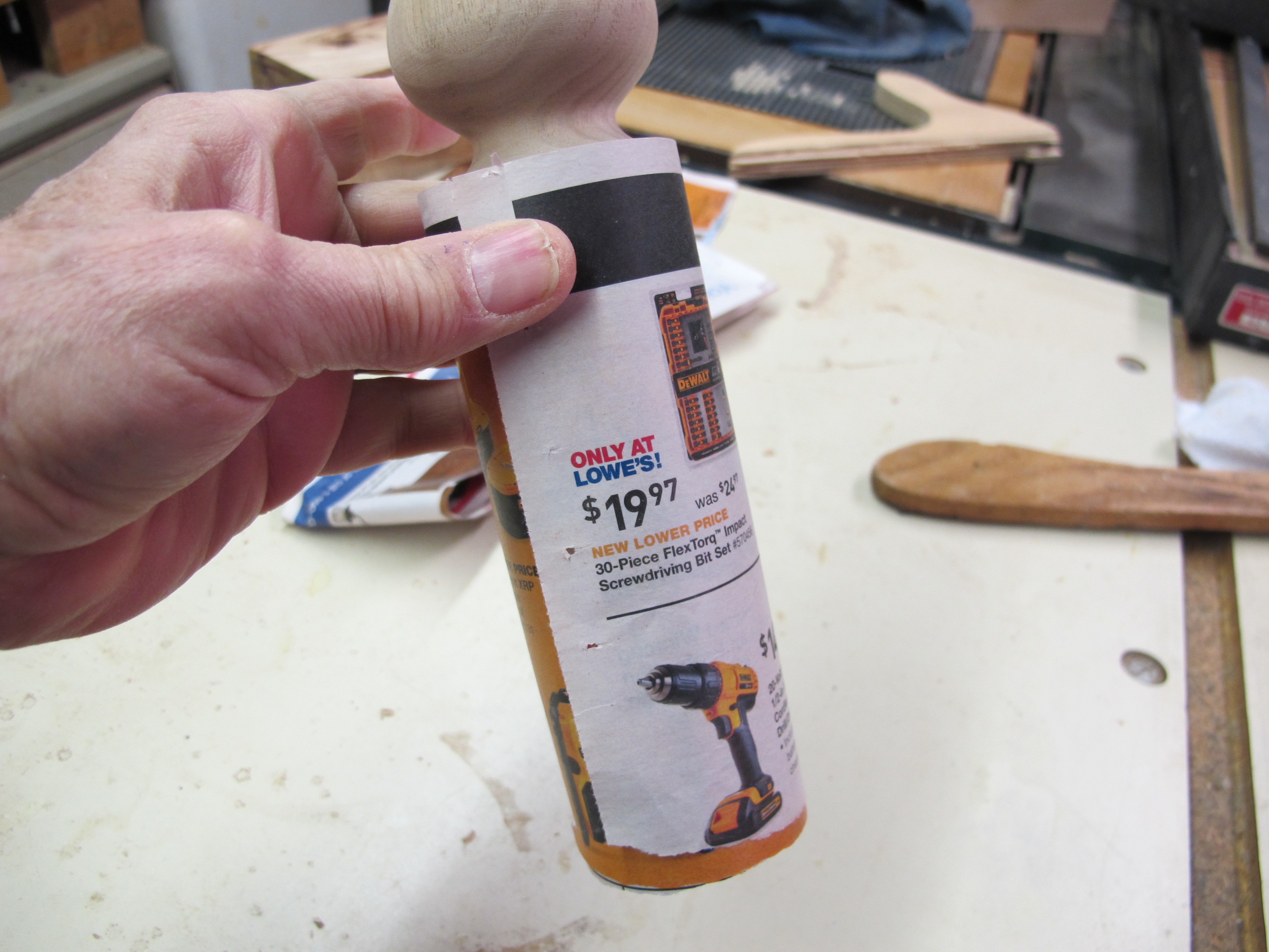

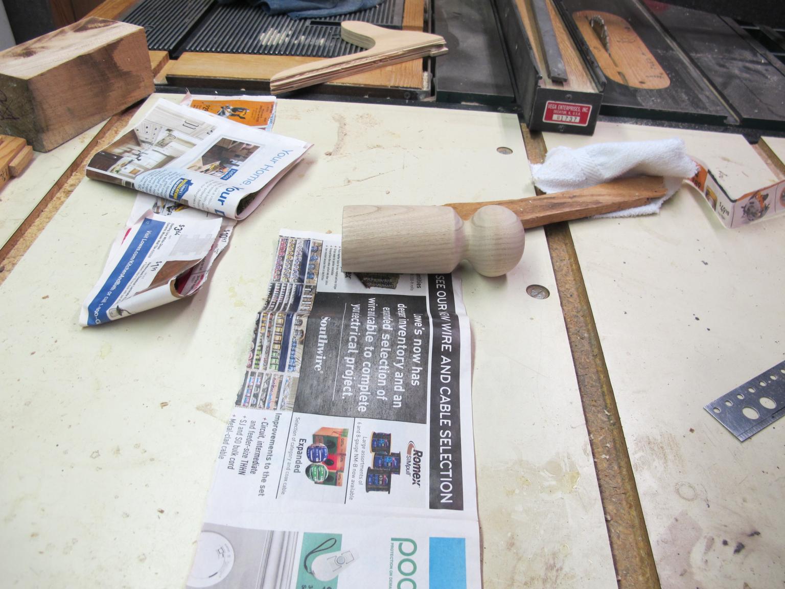

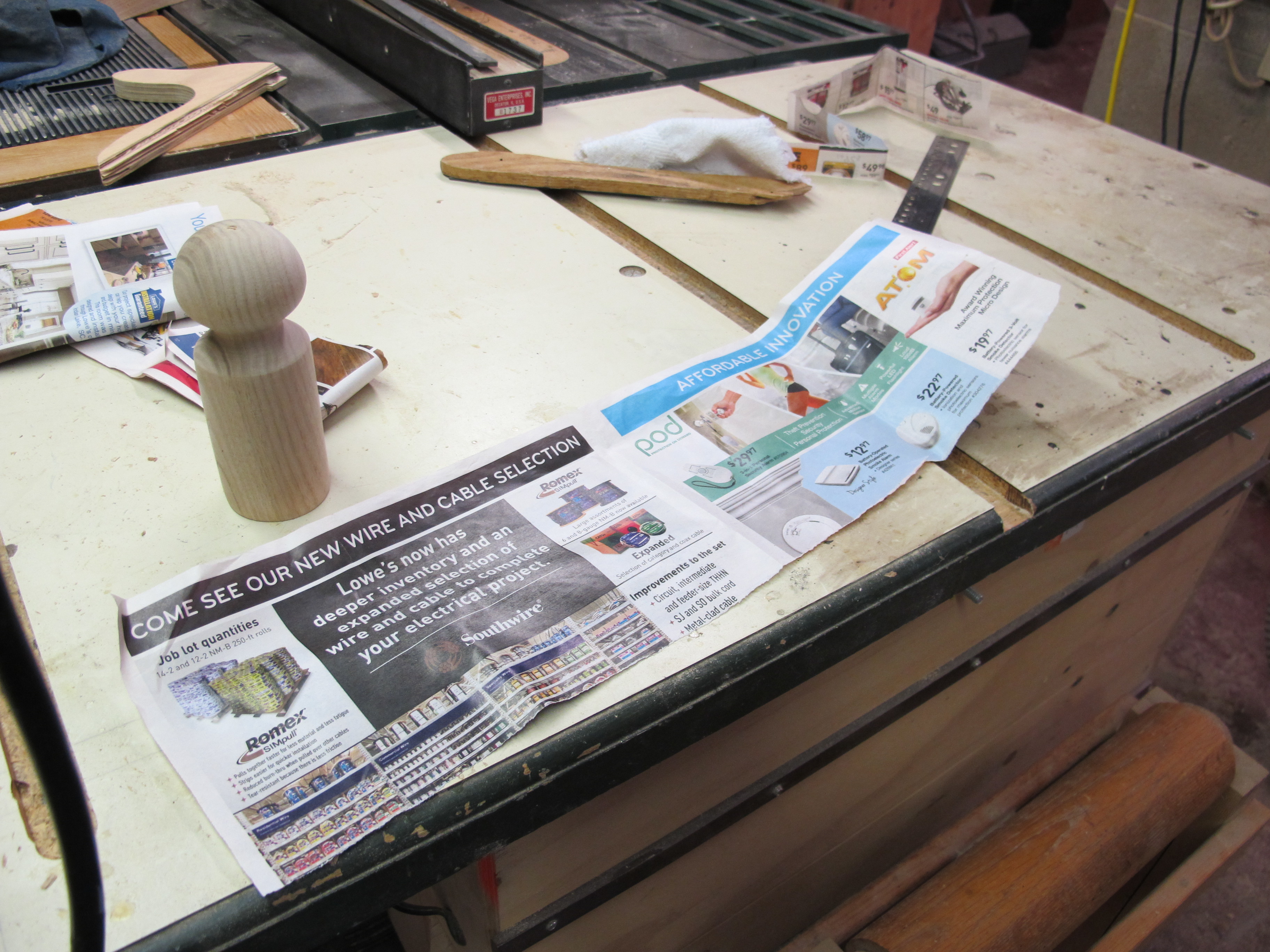

Using it is pretty easy. Tear off a sheet of newspaper (1/4 sheet works well)
56f326f62781a_makeapot1.thumb.JPG.c21d73
Roll the paper around the pusher
56f326f91e4c8_makeapot2.thumb.JPG.01ac76
56f326fbb000a_makeapot3.thumb.JPG.335bad
56f326fe2a193_makeapot4.thumb.JPG.7a57df

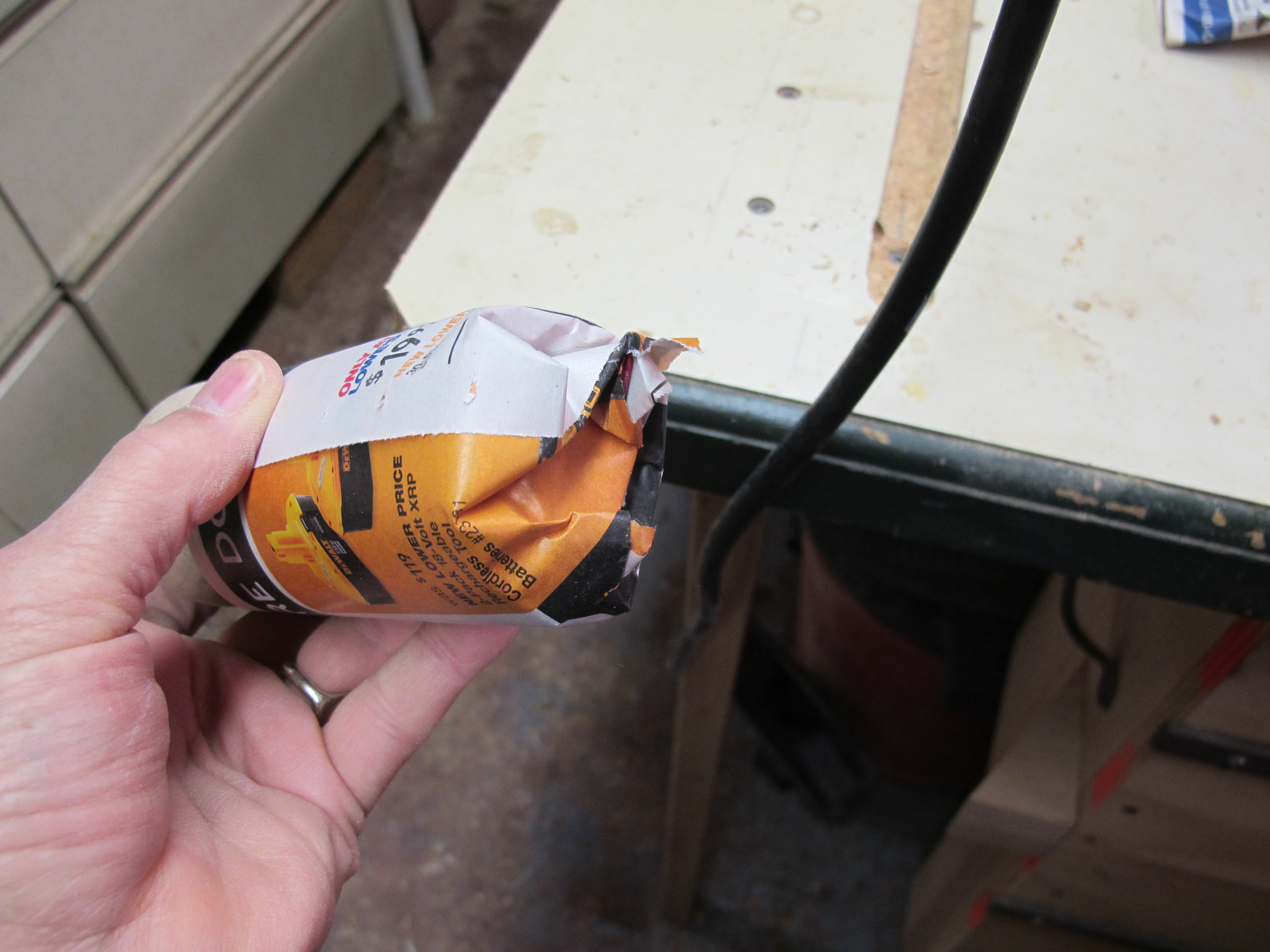

Fold the open end in on itself
56f32702591ce_makeapot5.thumb.JPG.415a0a
Press the pusher into the base (pix taken while testing for size)
56f327057f8e6_makeapot6.thumb.JPG.c7f06b
The paper is compressed and locks together
56f327081f448_makeapot7.thumb.JPG.7e84ee
56f3270b2ad7c_makeapot8.thumb.JPG.60e8a2

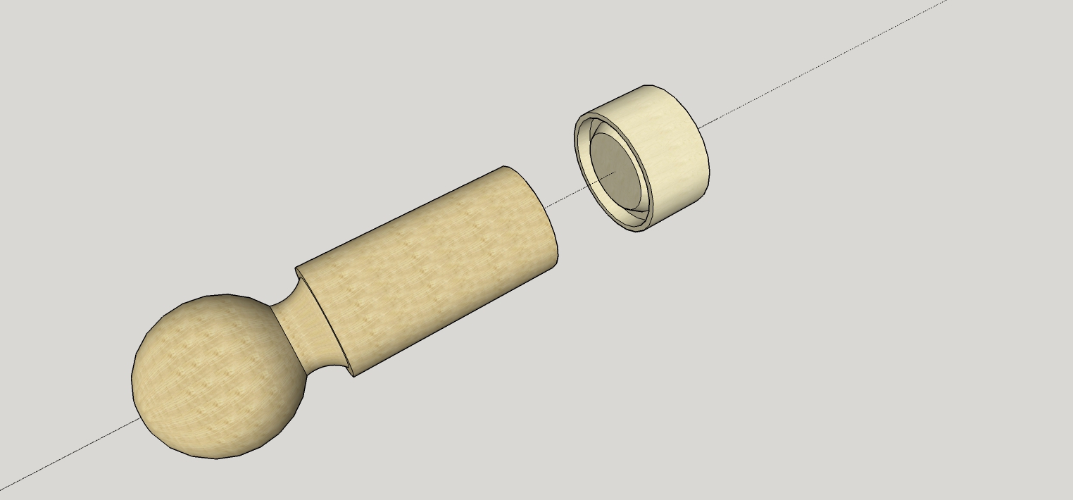

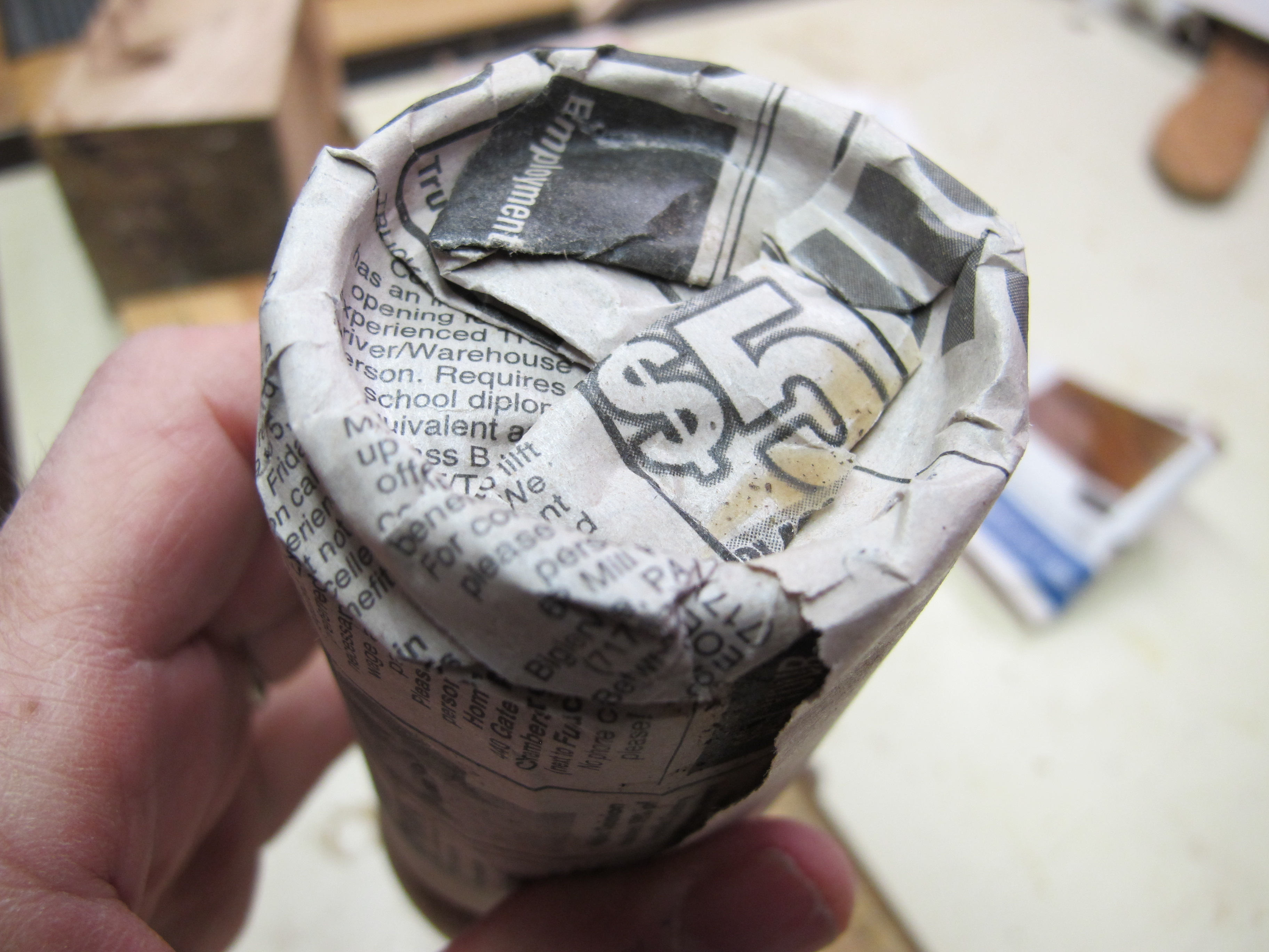

I found that I need to modify the base recess slightly. The pusher rim has straight sides as does the recess. When pressing the two parts together, the paper would sometimes tear at the bottom lip. I think that either making the recess in the base wider or adding a taper on the inner edge may eliminate the tearing.
Here's a JPEG of the SketchUp drawing (and the Sketchup file). It has the taper mentioned above
Modified seed mold.skp

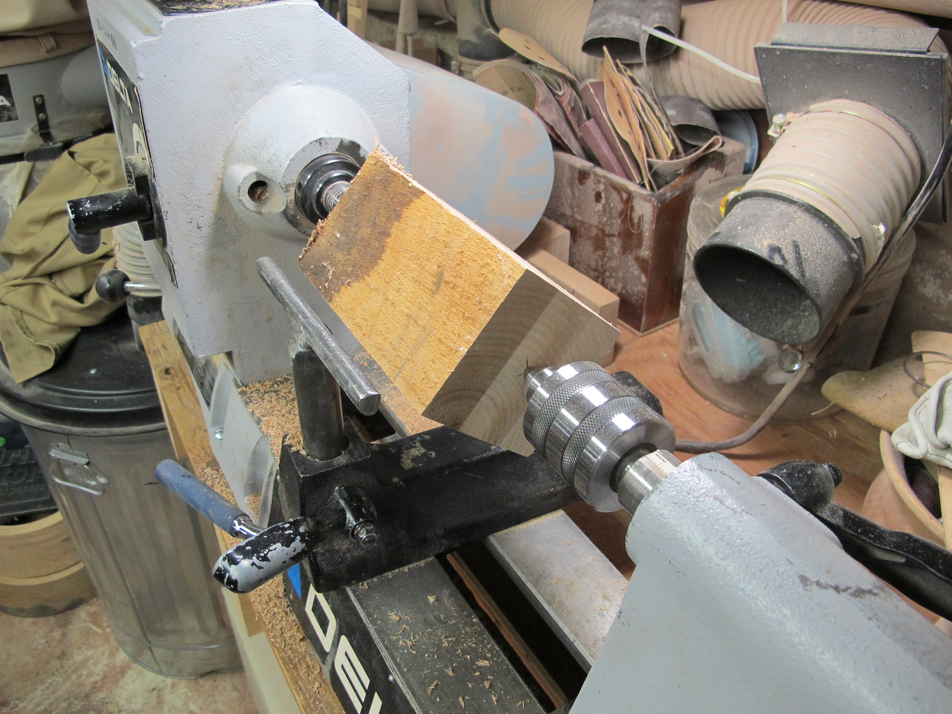

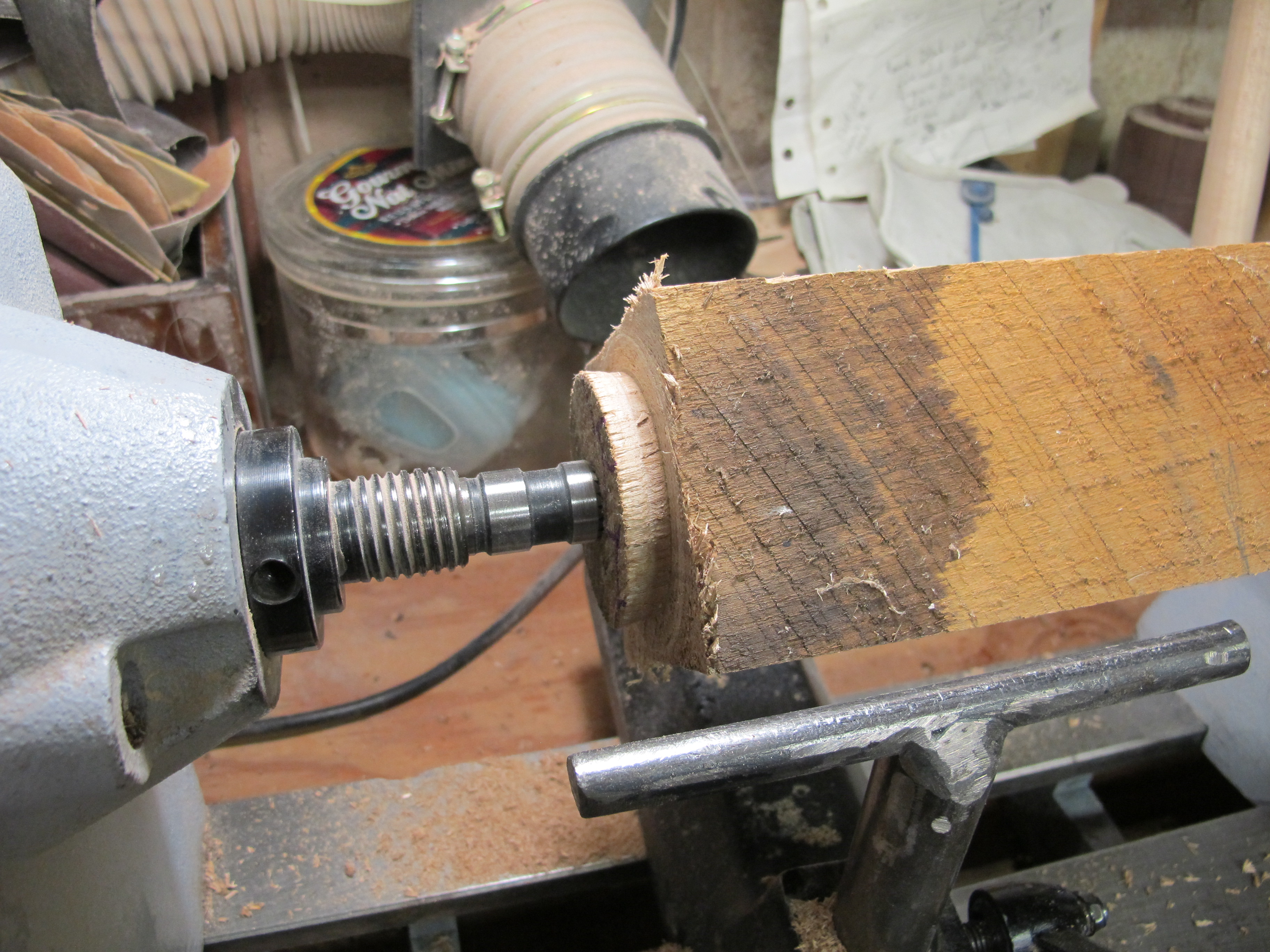

And here's a nifty little setup for holding smaller diameter stock in your lathe
ts_dra_bar_col_chu_1-4.jpg.05617073d1765
Full details are at- https://www.woodturnerscatalog.com/p/101/6510/Turners-Select-Drawbar-Collet-Chuck?term=drawbar collet chuck
