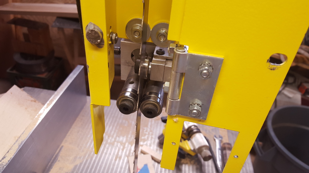

Been eyeballen' them thar Carter Guides
I have been looking at the Carter  guides.  They seem nice and the Euro ones I got on the saw have been showing some wear.
But I had it in my head that they were too spend-O-licious for what they were.   Yipper I'm a cheap Ba$%#$d.
So I set about figuring  how to build 'em.   Seemed easy peasy.
First I mocked it up from wood and hot melt glue just to get the feel of it
Cute huh?
I know what you are thinking - - - did he turn it on with wood  just hot melted together?  Is anyone that INSANE??
well sort of,  the video is  still uploading   so you'll have to wait to certify me insane.
But it looks like it's a do-able  thing
The DUTCH  ANGLE  for drama
saw%20guide%20Dutch%20angle_zps0kk8horl.
through the front door
saw%20guide%20%20front%20view_zpsjlpxlgk
From the side
saw%20guide%20%20side%20view_zps56tgn15h
An intimate view from the rear.
saw%20guide%20%20intimate%20view_zpslkcv
So after all this  I have  still to  turn the steel pillars for the lower guides.   I'm thinking maybe the Carter Guides  ARE worth the money coz it's been a busy couple days so far.   Wasn't so easy peasy as I imagined.  But it's sturdy and works great. I've already used them.

It's about $200  for my saw.   I thought it'd be a snappy quick thing  to make my own.  It wasn't.
I've come away from the experience  with the advice that   people should just buy the Carter  guides if that's what they want and not screw around trying to DIY them.  It can be done.  It can be done  very very well.  But the effort required is greater than I expected.   I just happened to have the half inch aluminum around and the 1" steel bar stock and a slew of 1/4-20 internal hex screws.  So I was 20% there at the beginning.  Add to that a $10 set of bearings from the flea bay and some shoulder bolts from Bolt Depot and  the rest was a lot of busywork grinding, milling,  drilling, cutting and turning.   And in the end I should have just ponied up the $200 bucks and let the mail man do all the hard work.
But still  you know how it is when you do a thing and it's done well.  It feels good.
Edited by Cliff
