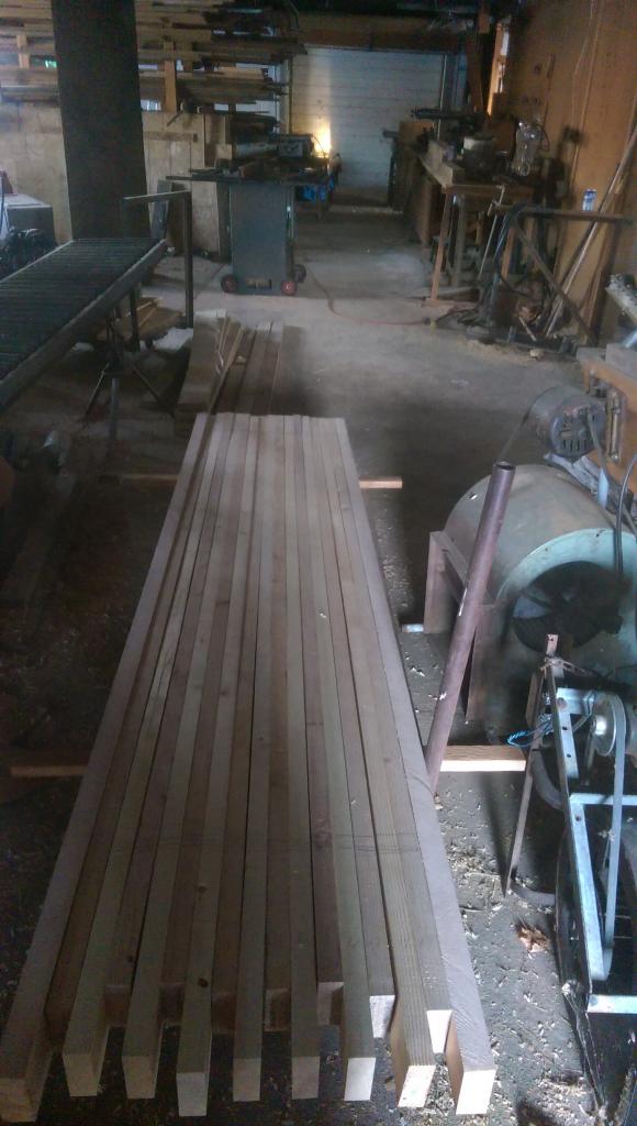

Im in the prosses of building a work bench.
2x4" pine laminated with maple outside edges.
My question is, do to the bench being in a non temp. controled environment here in Wi. will glue on its own work well or would I be better off running threaded rod through the "stood on end" lamenated lumber to keep from splitting.

I can only tell you what I would do. I live in SO. California and weather is pretty stable. That being said, I would most definitely run all-thread through those bench lams and plug em. Here in CA, I would do it. Your only talking a couple more hours in labor, and in the context of the importance of a flat and solid bench, why not go that extra mile. The fact that you questioned it, means you need to do it, you'll feel better about the longevity of the bench if you do. Pictures please!!!!
So far ive planed the bords and did a lot of moving things around.
Ill be bolting together, thank you.

Wood expands mostly across the grain- in your case(bottom to top). You are using the same type of wood for all of the pieces so the expansion rate for the entire piece should be pretty much equal. Rods will certainly add stability. The only caveat I can see would be that, with my luck, the rods would be exactly where I'd want to create a dog hole or mount vice hardware.
The outside edges of the top are maple.
But yes, that was exactly why i didnt want to run bolts through.
The only thing with this operation that raises a red flag with me, is the pine, I'd opt for the rods just because of the pine, if it were a complete solid maple top, I may dismiss the bolts.

It looks like you have some mass going on there Stout, so perhaps I am blowing smoke by stating you should need rods, but I am only telling you what I would do.
Here is the entire article: http://www.popularwoodworking.com/techniques/rules_for_workbenches
Your top is pretty beefy, even in the aforementioned article it is stated that Pine should be fine. This could be a toss up!
