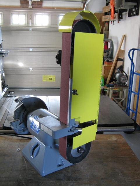

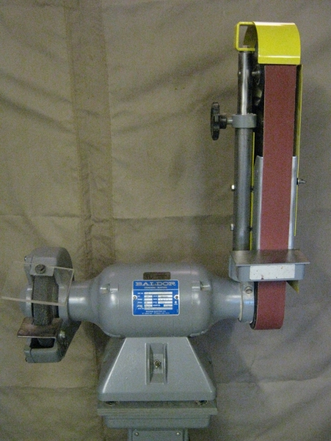

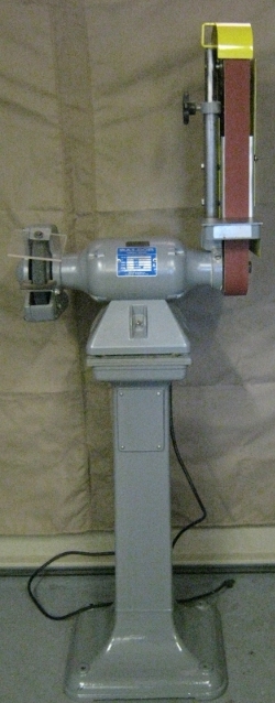

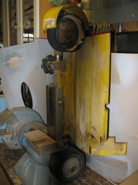

December 7, 201510 yr comment_63829 Picked this up at an auction. It is a 7" baldor grinder with what appears to be an aftermarket belt grinding/ sanding attachment labelled Kalamazoo Industries. Takes a 2" x 48" belt. I have never seen a grinder with such an attachment in person and only seen one ( a Rockwell) on the VM site.After some research I discovered that Kalamzoo industires is still in business and still makes this attachment. Unfortunately I arrived at the auction too late to dig around any boxes to see if the other grinder guard was hiding anywhere. I cleaned it up and repainted it up. Only real issue I had is that the belt did not want to track on the centre of the pullies. Fixed that by winding a few layers of electrical tape around the middle of each pulley. Tracks perfectly now. Very handy tool. As found After repainting I put it on my Delta pedestal until I get my 7" delta up and running then I may change the grinding stone out for a wire wheel. Edited December 7, 201510 yr by GerryinBelleRiver Report
