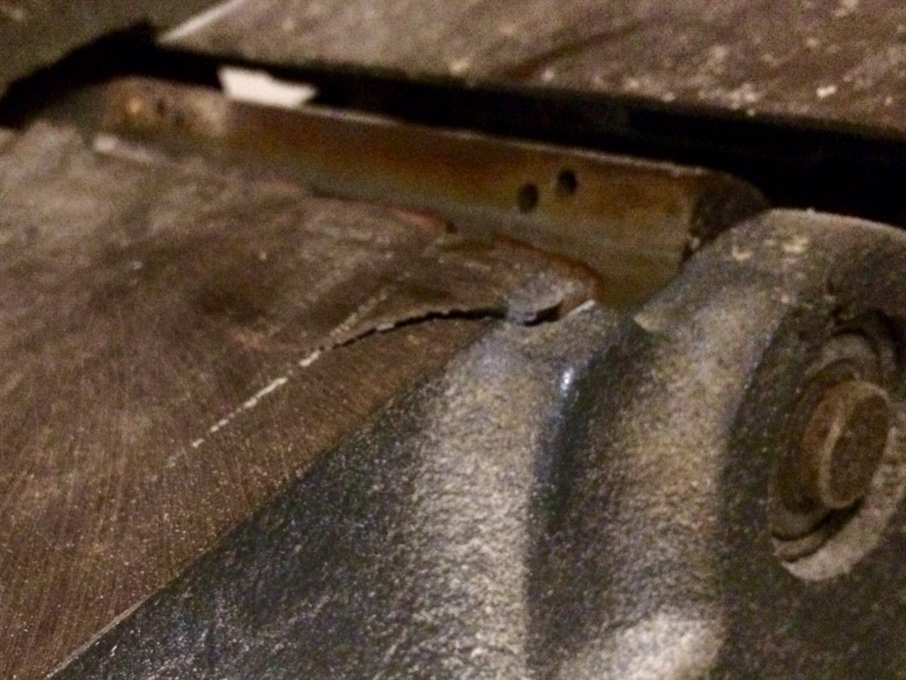

A couple nights ago after installing new blades in my old craftsman jointer I had a pretty scary experience. One of the blades worked loose from the cutter head, hit the cast iron top (instead of hitting me thankfully), and cracked the cast iron. I was lucky to find this jointer at $75 it will be some time before I am able to purchase another jointer since just started my woodworking journey earlier this year and funds are limited.

I have used a planer sled, and they can be made to work very well. The drawback is you are usually limited to shorter lengths of lumber. Shopnotes published a plan (issue 137, I think) for one that adjusts, and if you use it a lot may be just what you need. But a question: that looks like the jointer that has a fixed outfeed table (?). I had one, and mine also had a crack in the casting (little lower on the body).  But here's my question: if you file that spot smooth (cast iron files fairly easily) would you still be able to use the jointer? That piece has some mass, it's unlikely to explode. Of course, that would assume the cutterhead is undamaged....and you tighten the knives securely.

I agree with Fred on the planer sled because I made a small one and it works well.  As far as the crack in the jointer goes, do you know anyone who could braze the crack.  It shouldn't take much to fix it and the integrity of the piece would be maintained.  The bronze used to braze it could easily be filed flat.

Yes assuming I could get it even with The rest of the table. At its highest point it is raised about 1/4" where it cracked. It is an old craftsman model from the 80's and does have a fixed out feed. WAS a pretty good little jointer.
The cutterhead does appear to be fine but the wedge holding the blade in place has some minor damage. To be honest this shook me up pretty bad and I am a little apprehensive to fix this one up not being sure exactly how it happened. I am a safety engineer and emergency response team chief for a living working at a large chemical plant and try to protect people on a daily basis so I didn't deal very well with almost having a blade fly at me.

There's probably a welding shop in your town. Bet they could braze it and have it ready very quickly.

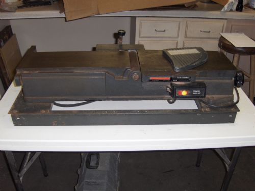

Ok Guys, & Gals,
This is the machine that Trey is looking for parts for.

So if you've got a parts machine in your rat-hole, here's your chance to gain back a bit of room. :lol:
why not take a file to that jointer table and flatten it?  I'd start out with a bastard file.
If successful, then take a drill to the crack and stop it from propagating further by drilling  a thru' hole just at the  very  end of the  crack.  So your jointer table will have a  1/4" hole in it and a shiny spot where you flattened it.
A I/4" uplift is a lot to file off and keep it flat this may even remove more than the thickness of the casting. Brazing will work but it could cost upwards of $100 for the work and may crack the jointer more. I would use a sled and shims until you can save your pennies to buy a different jointer.
I agree, the 1/4" is certainly more than I expected...that's grinding territory and I'm not sure how well you could smooth it out. May be time to say goodbye to the old friend.
