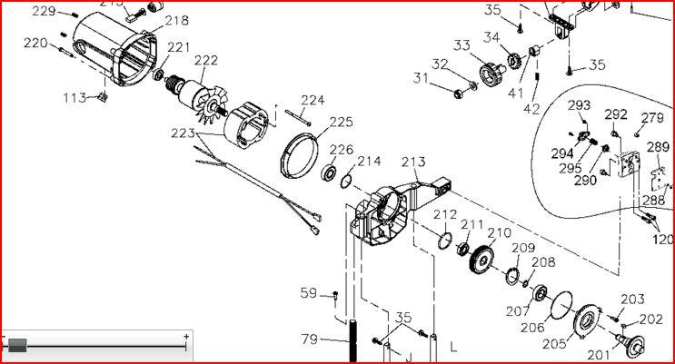

November 18, 201511 yr comment_63415 chrjk,The DWE7480 is not a Delta product, it is a Dewalt Compact Job Site Saw.Here is a link to the manual, and exploded parts diagram.http://servicenet.dewalt.com/Products/Detail?isId=true&productNumber=DWE7480&selectedType=25865#Unfortunately it uses a proprietary motor that cannot be replaced with a standard motor. Report

November 21, 201511 yr comment_63461 Cliff, What you have pictured is a Delta Uni-Saw motor. The motor for the DeWalt DWE7480 looks like this. It is built into the saw, and is a direct drive to the blade arbor. Report
