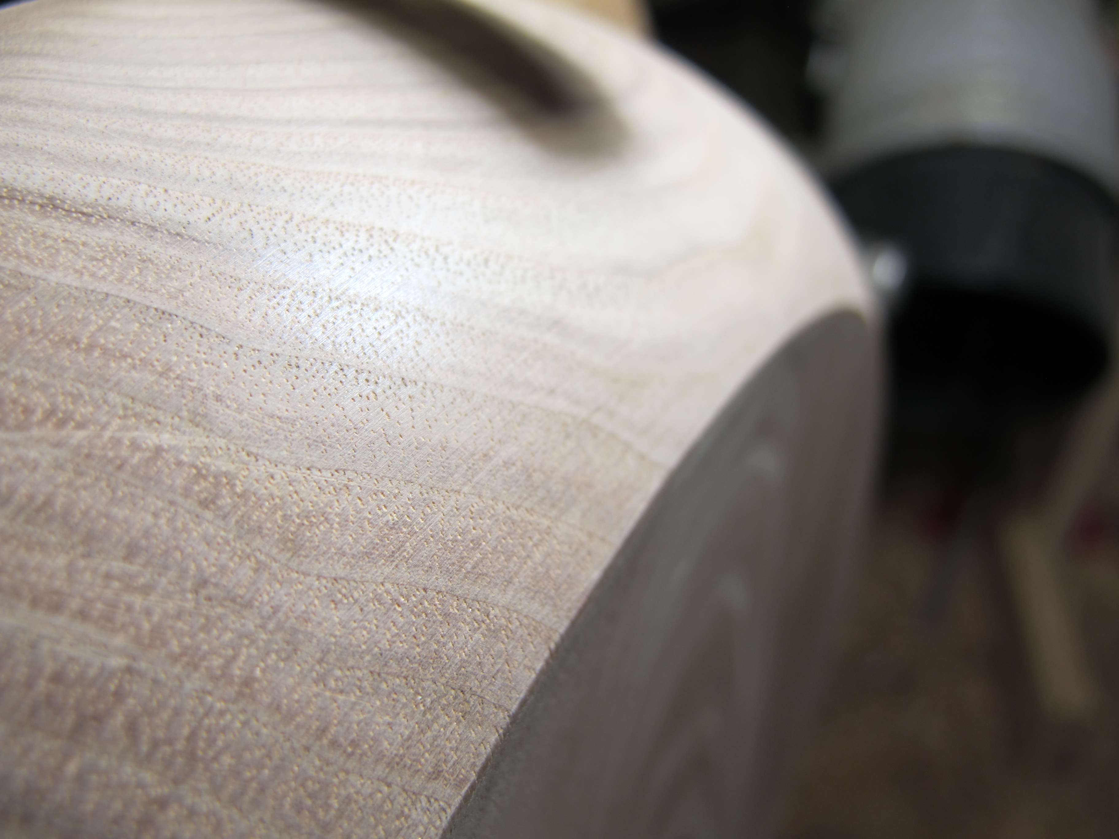

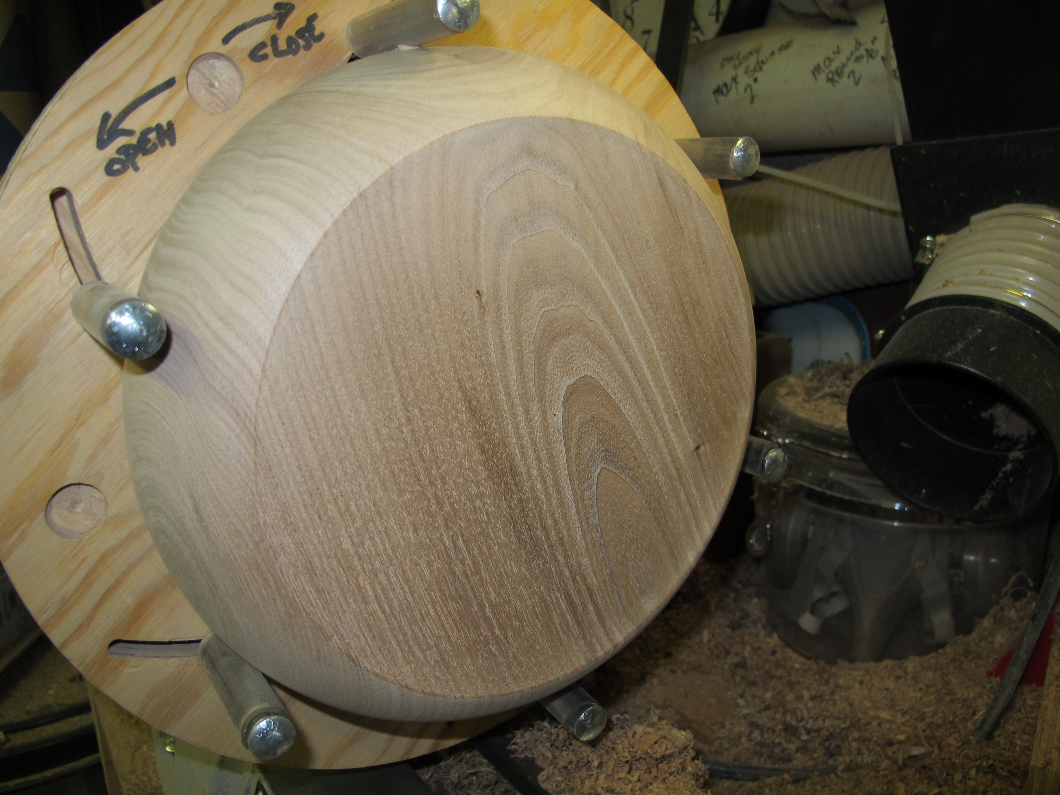

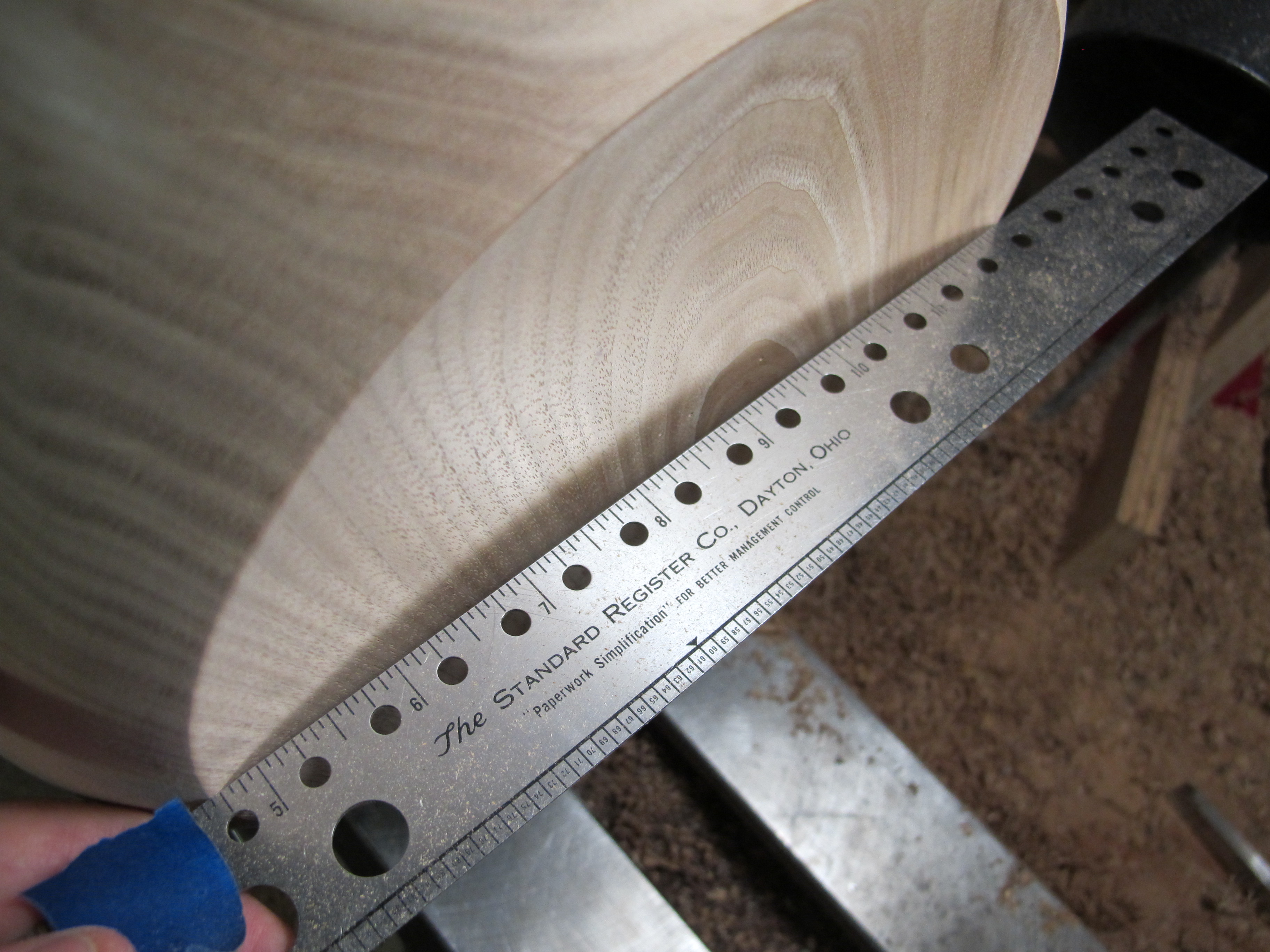

We are still making preparations for relatives- they arrive tomorrow- so I didn't get much turning done. I thought I had a pretty good handle on a Butternut bowl- until I repositioned my light over the lathe. I was finishing up the bottom
butternut_bottom.thumb.JPG.7088e16eab7eb
It is actually concave-
butternut_concave.thumb.JPG.781f1b9bec2c
I moved the overhead light and saw this-
lousy_sanding.thumb.JPG.a732d424986faf7c
Because the bottom recess was already removed, I couldn't re-chuck the bowl and re-sand. Looks like  some hand sanding is in order.

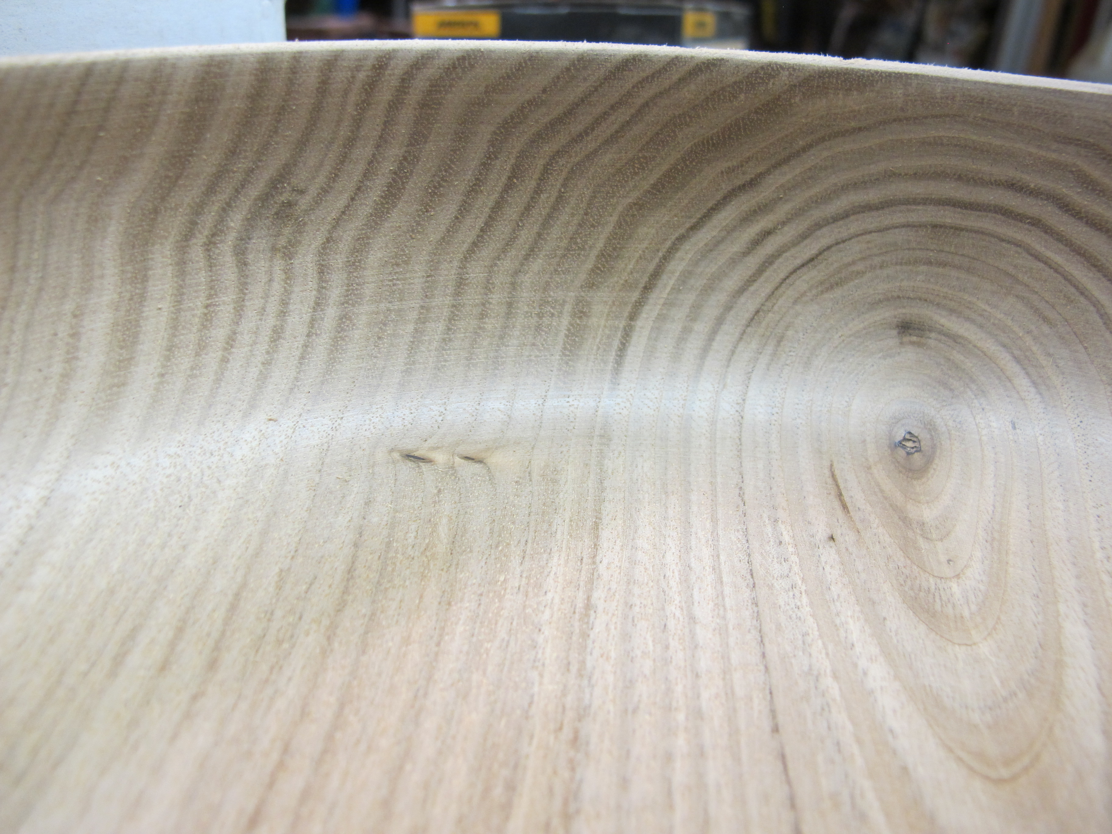

Then I saw the same thing on the inside-
Bad_sanding.thumb.JPG.575293801ffe4275f4
I really need to improve my sanding techniques. Especially since  a lot of my bowls get oil/wax finishes. There's no film buildup to "fill" these sanding faux pas.
