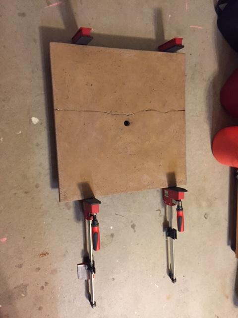

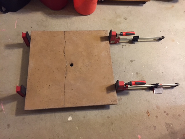

November 11, 201511 yr comment_63267 My daughter broke her gas fire pit cover. It is made of a cement like material and is somewhat lighter. After some research, I thought it would be interesting if I tried out some goop as the adhesive. It is suppose to hold to everything including cement. The piece area is large, but the thickness is only half inch. I'll wait 24 hrs before I release the clamps. I am not concerned about heat being a problem. They let it cool before they cover it because a vinyl cover goes over the whole thing Report
November 11, 201511 yr Author comment_63278 That may work also, but there is leverage involved and I would not be surprised if they both fail Report
November 11, 201511 yr comment_63280 If ya end up making a new one, use vermiculite and regular portland cement Lots and lots of vermiculite. 7 to 1 ratio with a galv' welded wire mesh in the middleI don't expect the goop will do the job, at least not for long, as it's pretty flexible and secondary bonds in concrete tend to be poor. Report
November 11, 201511 yr comment_63283 IF it does fail......drill some "dowel" holes into the break. Cut the heads off the longest nails you can find. Epoxy them in place. Use the same epoxy (Hilti makes a good one) along the crack, clamp up and let set an afternoon.. Report
November 11, 201511 yr Author comment_63286 The goof worked and it is very solid, at least for now. I've used it before in places I thought it would never hold or last. It is still there doing good. Report
