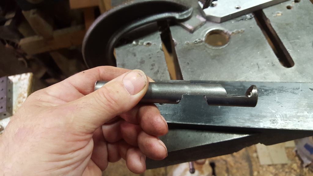

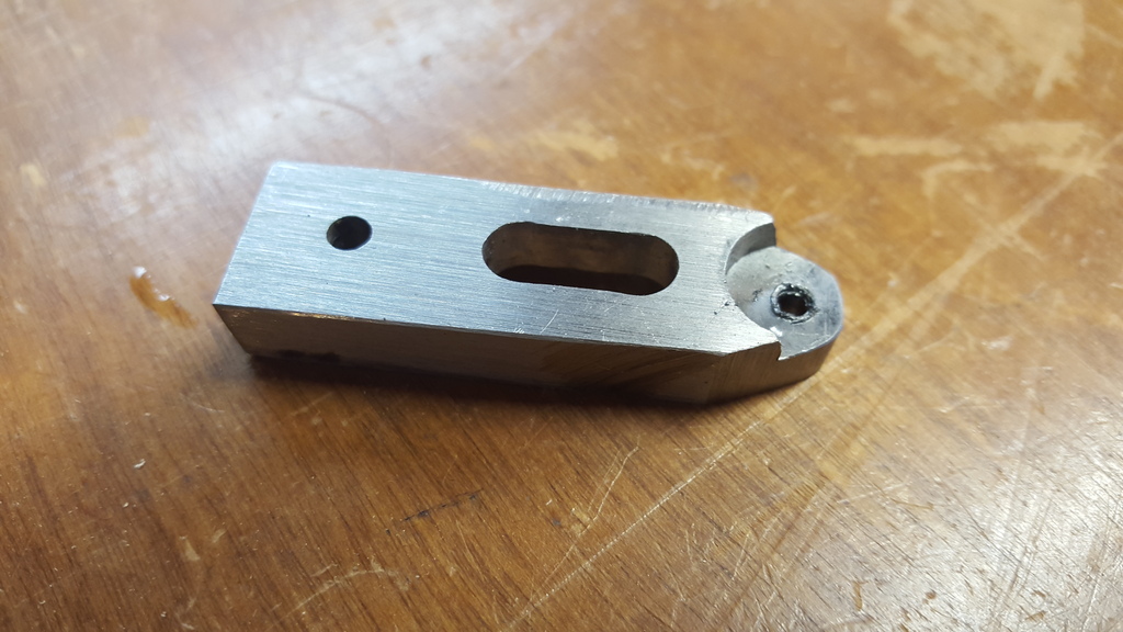

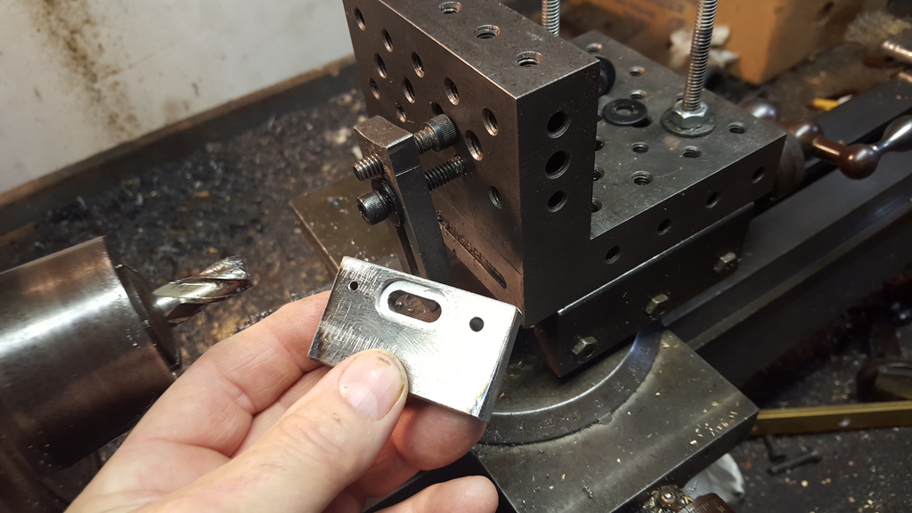

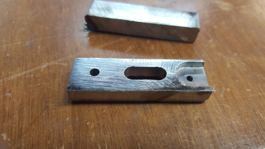

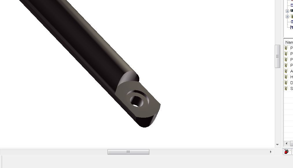

October 25, 201511 yr comment_62994 I wanted a shielded hollower. DARN those things are expend-O-licious and I'm a cheap SOB. I looked at a shielded hook and couldn't get with the idea of the replacement cutter cost and never found anyone who spoke about how long the cutter's last. I looked at the Sorby and The Rolly Munro. They ain't cheap. I can see the cost considering that serious mass production is not applicable so they are made in small batches and that costs money. Folks seemed to like the Munro tool a lot so I set my sights on that. Hmmm I can't try it our yet coz the tap I ordered to install the carbide insert won't ship till after this monday. The middle link Using my itty bitty Elgin lathe as a milling machine Is it a lathe or a miller? I can't decide https://www.youtube.com/watch?v=FAcQxmZIAE8 OOOPS Snapped a tap Gol Durn Metrics I never work metrics and read the chart wrong and drilled undersize Well I got the busted tap out. That's always a challenge. For a while there it was touch and go; more like hammer and whimper, but who's telling? And finally I hope to try it out this coming week. Failure remains an option. Report

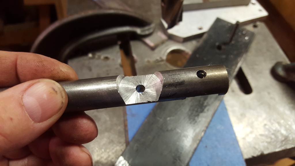

October 25, 201511 yr Author comment_63015 well I put that little spot face into the components and it REALLY makes a difference.My theory was ( based on the fact that everything deflects) that the big flat 7/8" diameter spot-faced steel in the immediate area in some diameter around the bolt was deforming in response to the forces applied by tightening the Allan bolt. It was bulging just a scosh. Assuming I was correct, this would cause pressure to be applied to the sandwiched steel surfaces unevenly across the broader area of the flats with the most pressure right around the bolt. So I relieved the metal there and VIOLA a little bit of tightening on the Allan bolt secures the coupling components much more securely. Before: I could tighten the Allan bolt very tightly and then easily loosen the coupling by hand, just tugging on the gooseneck. Not so much now. It's, lots more secure.This coming week promises to be a PITA I gotta go to funerals. I hate hate hate hate funerals. I don't want one. Just shove me overboard somewhere and feed the crabs. So I may or not get to try it out. Report

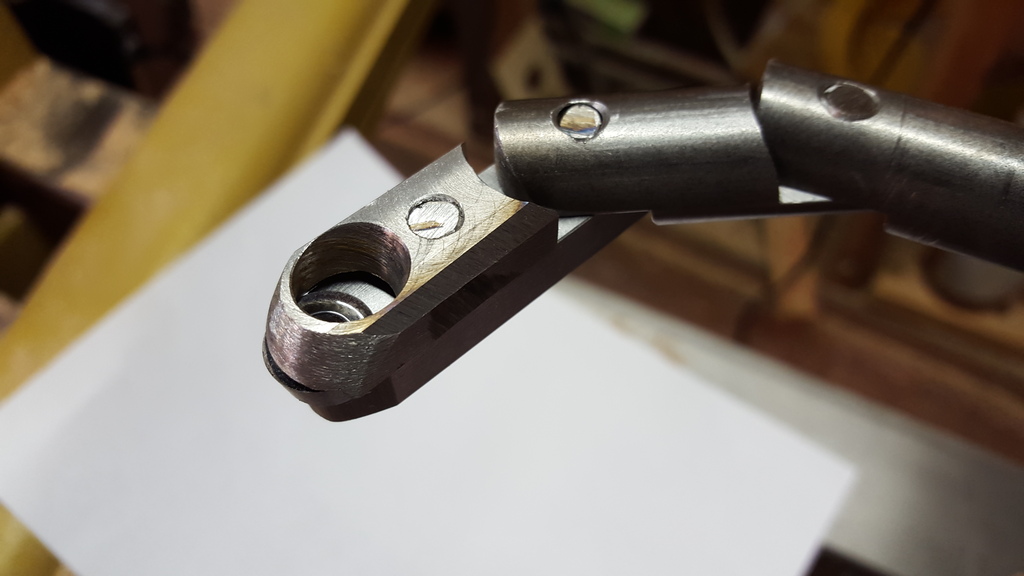

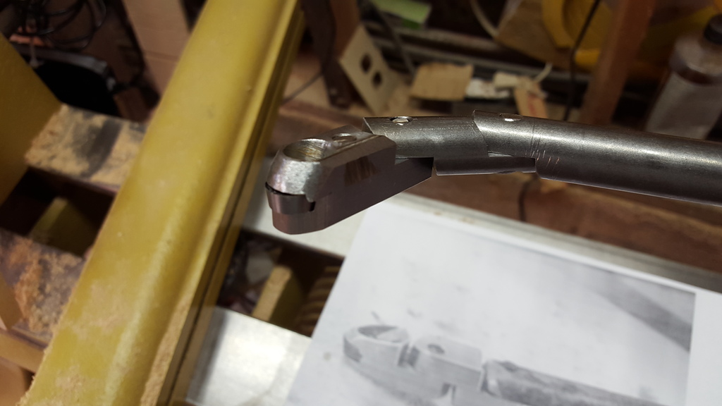

October 29, 201511 yr Author comment_63071 Finished This is the action of the shield or hood covering the carbide insert https://www.youtube.com/watch?v=-Ti-DoZoblI&feature=youtu.be https://youtu.be/-Ti-DoZoblI This is the very first cut. https://www.youtube.com/watch?v=bObHhUXazLs I just had a hunk of maple ( this is endgrain) in the lathe so that's what got cut. Here is a 4 or 5 inch diameter piece of maple on the lathe after I shimmed the hood further from the cutter Report
October 30, 201511 yr comment_63080 Nice work! Now I see how the "hood" functions. BTW, your video of the "very first cut" is labeled as private. Report
