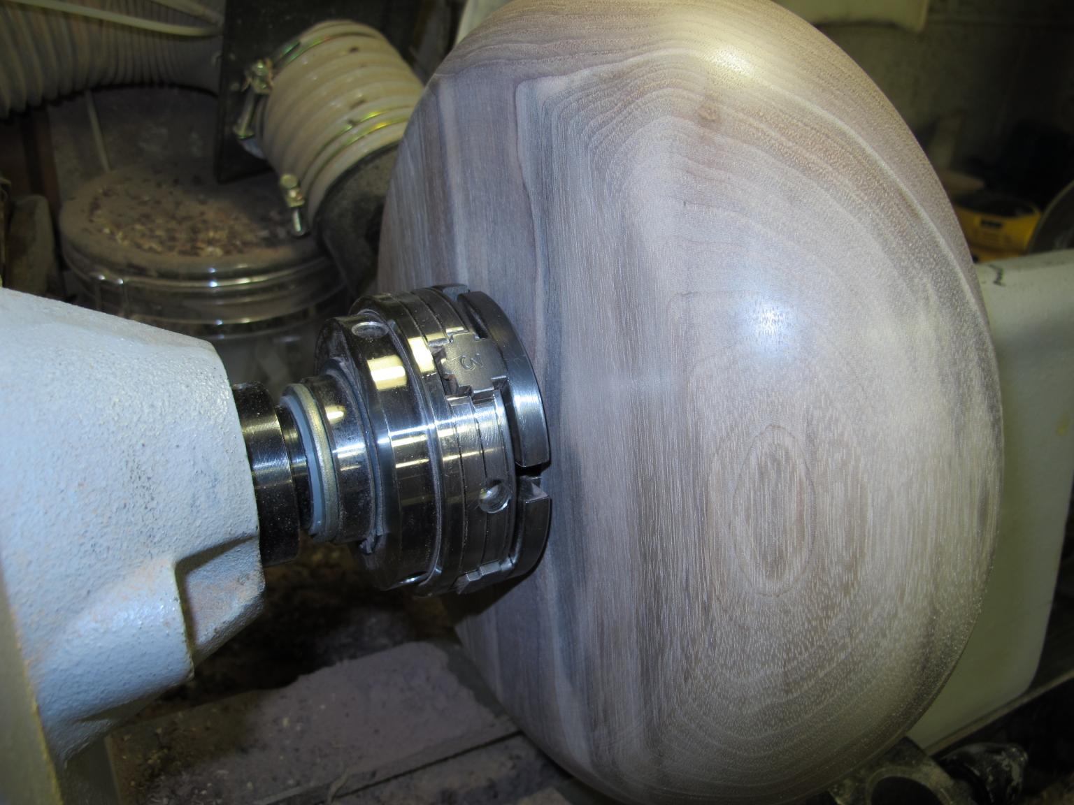

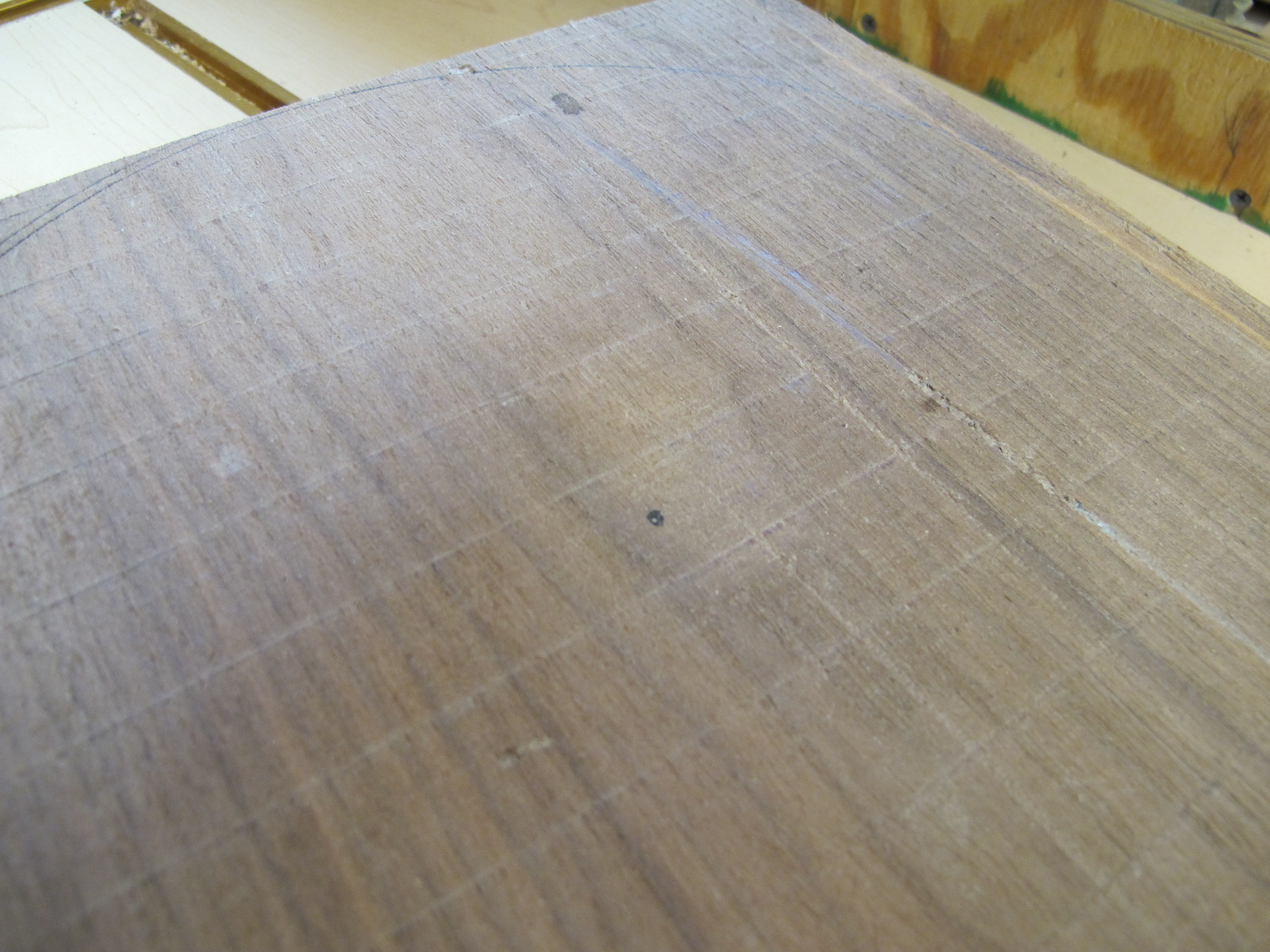

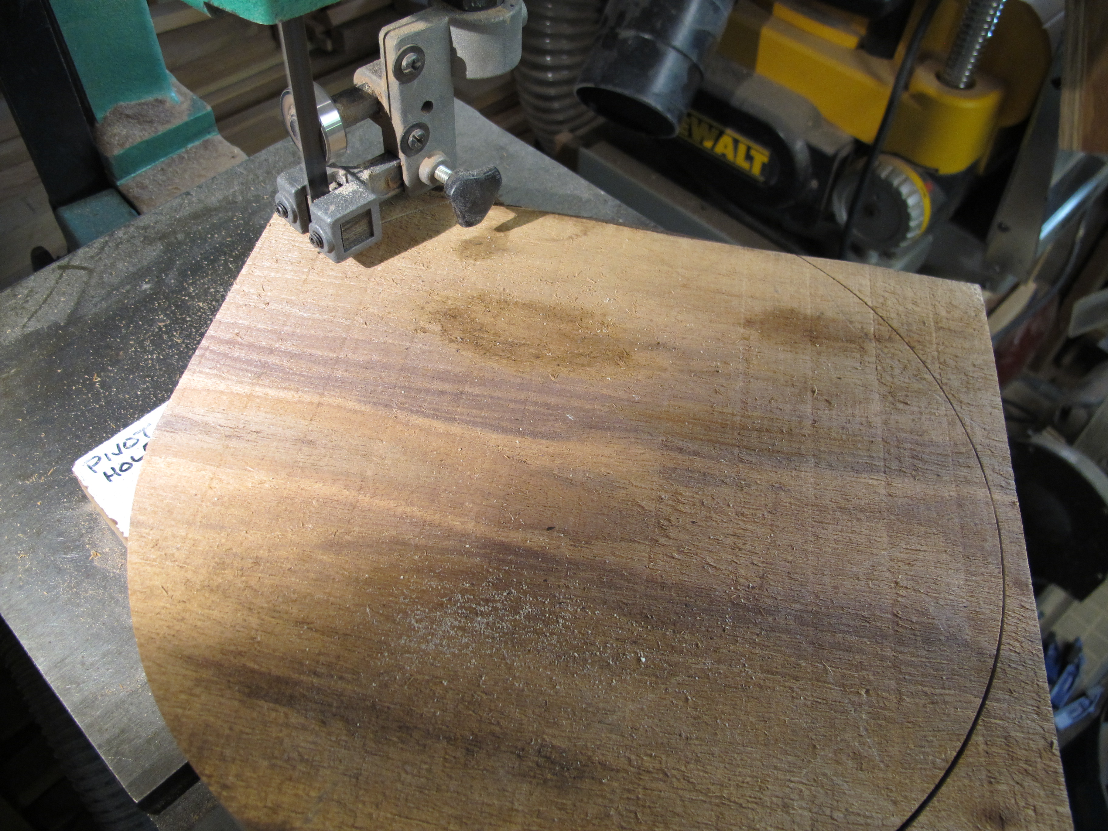

October 22, 201511 yr comment_62957 Well, the basement shop is still a mess, but I moved enough stuff to be able to get things done. Although sometimes I have to walks twice as far to accomplish them. I finished the coffee scoops and decided they would look better with some finish- bee's wax and mineral oil rubbed in. These are walnut and maple. The center one was the prototype. Then it was on to the walnut, shallow bowls. I still had several thick/wide pieces of air dried walnut from the humidor fiasco. I cut up one of the smaller pieces into turning blanks. The blank is about 11" square and 2 3/4" thick. Laid out a circle that would provide the most wood Drilled a small hole for the pin on my bandsaw circle jig Set the jig to match the radius of the cut Mounted the blank and cut it Once the circle was cut, then I added some layout lines to center/mount the lathe faceplate. I used a Vix bit to more accurately center the holes. Then drilled pilot holes for the screws- remember, no drywall screws here Mount the faceplate. I alway use a reference mark to locate the faceplate or chuck in case they need to be removed and reattached. Mount the blank on the lathe True the perimeter and flatten the face Locate the chuck recess and set the depth of the recess Remove the material where the chuck will set Using a shop made tool, I created a dovetail type opening to better hold the chuck. The opening is wider at the bottom and matches the chuck jaw angle Now it is just a matter of turning the outside to shape. I also sanded the outside after it was turned Next I removed the faceplate and mounted the blank on my chuck in preparation for turning the inside. Sorry, I forgot to take a couple of pictures here I carefully calculated and set the depth of the finished inside. No repeats of my last bowl accident. The inside of the bowl turned and sanded. A couple of home made sanding balls to help on the curved surfaces. I also used my random orbital sander on the flat surfaces. The last step was to finish off the bottom where the chuck recess is located. I have a shop made Longworth chuck that I use for this procedure The wooden cone, on the tail stock, keeps pressure on the piece- for safety. I had already started work when I realized I forgot to take more pictures. Pretty much the shape I was going for. I am trying to make the bottoms of my bowls concave, rather than flat- no reason. I have 5 or 6 more of these to make so I'm going to do all of the finishing at one time- probably a film finish- maybe the bumble bee butter If you don't have a Longworth chuck (or want to make one) here another method of holding a bowl for bottom finishing This idea was from the Macarthur Woodturners. They posted it on their Facebook page- http:// https://www.facebook.com/Macarthur-Woodturners-165003696898477/ You might need a Facebook account to see the complete post. Finally, from Woodworker's Journal a little something you might like to turn for the Mrs. http://www.woodworkersjournal.com/kimberly-chalos/ Safe Turning! Edited October 22, 201511 yr by lew Report
