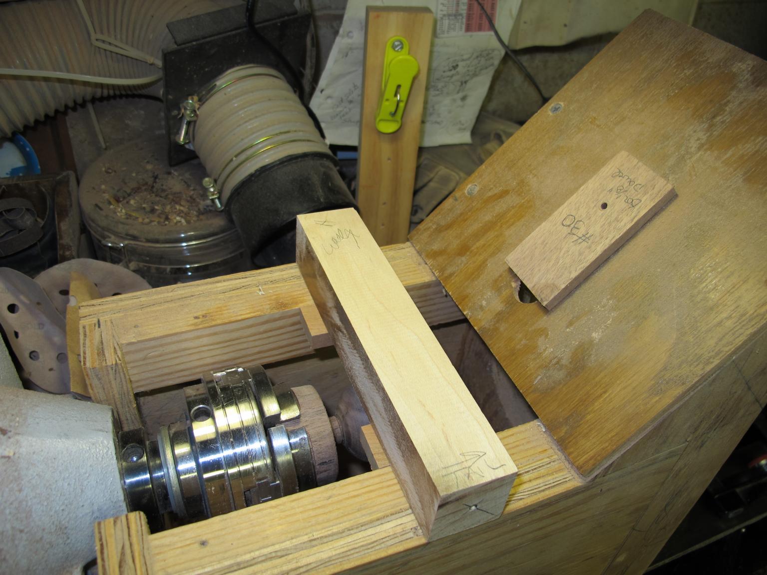

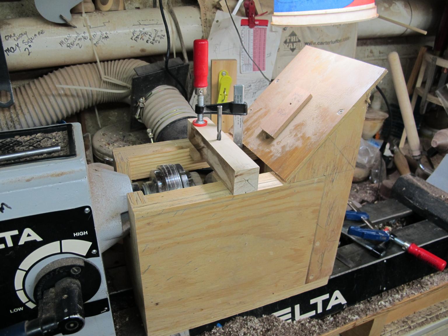

October 8, 201511 yr comment_62777 Things ground to a screeching halt, yesterday. The furnace man was supposed to do the annual maintenance so I needed to move a bunch of walnut and a few stored machines to permit access to the fuel tank and furnace. Everything is piled on, around and under the table saw and any other open space. I did leave the area in front of the lathe open, but you need hazardous duty pay to climb into that space. Oh yeah, he didn't show- he had an emergency repair. I did get some work done, this week, on the scoops. I figured a way to drill the handle holes. Many years ago, I made a tilt top table from an episode of the New Yankee Workshop. The table legs were dovetailed into the center post. "Norm" had a special jig that made the dovetail slots using a hand held router. Well, I saved the jig- even though I only made one table. A couple of years later, Woodcraft Magazine had a turned, wooden candlestick holder. Part of that project needed a special jig which, as luck would have it, was nearly identical to the NYW one. Well, again, I saved the now modified jig. Once again, it was time to haul out that jig- The jig sets between the lathe ways and is clamped by a turn catch and knob- I added a hard maple block to act a drill guide- Drilled the guide and clamped it in position aligned over the scoop- Drilled the hole I was feeling really good. This was going to work. Removed the first scoop and repeated the process, @ $%#^^&*())*&@^%$#??!!@%@^&**(&^%$@%^^@$###**(()&&^%$#@@!!#@$%^%$&&))((&^%$#!*!&^%- and that's the short version The knob that was supposed to keep the jig in place, on the ways, slipped. Well, that won't happen again- The remaining scoops drilled OK. On to the handles! The handles are about 4" long. A 1/4" tenon and 3/8" collar A test fit. I hope to get to Supergrit tomorrow so I can finish sanding the scoop parts. Some of you may be familiar with Frank Howarth. He does the neatest stop action woodworking videos on the web. Well, he's out- done himself this time! Check out this video and the 360° interactive perspective. Frank's a great woodworker and a phenomenal cinematographer. Finally, check out the latest edition of Woodturning OnLine at- http://www.woodturningonline.com/index.php Safe Turning Report
