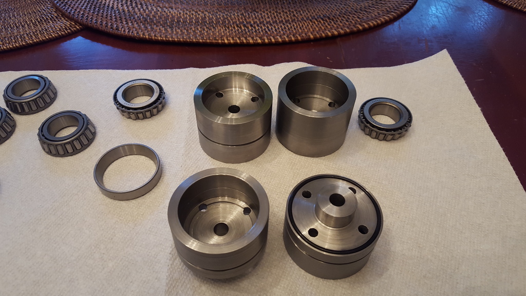

I turned  four bearing knuckle assemblies from 2.5" 4140 steel.   It's tough steel.  Each knuckle had a component made to accept  Tapered Roller bearings  one on each end with a steel cap to engage the bearing and  one bearing in the muddle where the  two knuckle parts meet.
 It bears noting that the size of these knuckles was solely determined by the fact that I got the taper bearings dirt dirt dirt Cheap~!!  So the bearings were the controlling factor.   It'll kill you what these bearings were made for: A Ferris Lawn Mower Blade mount assembly.

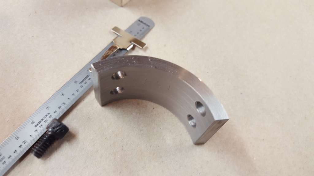

The knuckles are 2.490" OD  so I got some 3" A36 steel and made mating rings a dead exact match.  Cut the rings in thirds and  drilled and tapped the things into the knuckle assemblies  with 4  1/4-20  half inch long allen bolts per attachment.  Yes maybe it's overkill.
  I made four bearing  pairs per the  drawings
The tolerances I was working to were on average within 0.002" TIR concentricity and coplanarity and the Diameters were about +/-0.002 because they are bearing race mounts.
 The mating surfaces are O ring sealed.

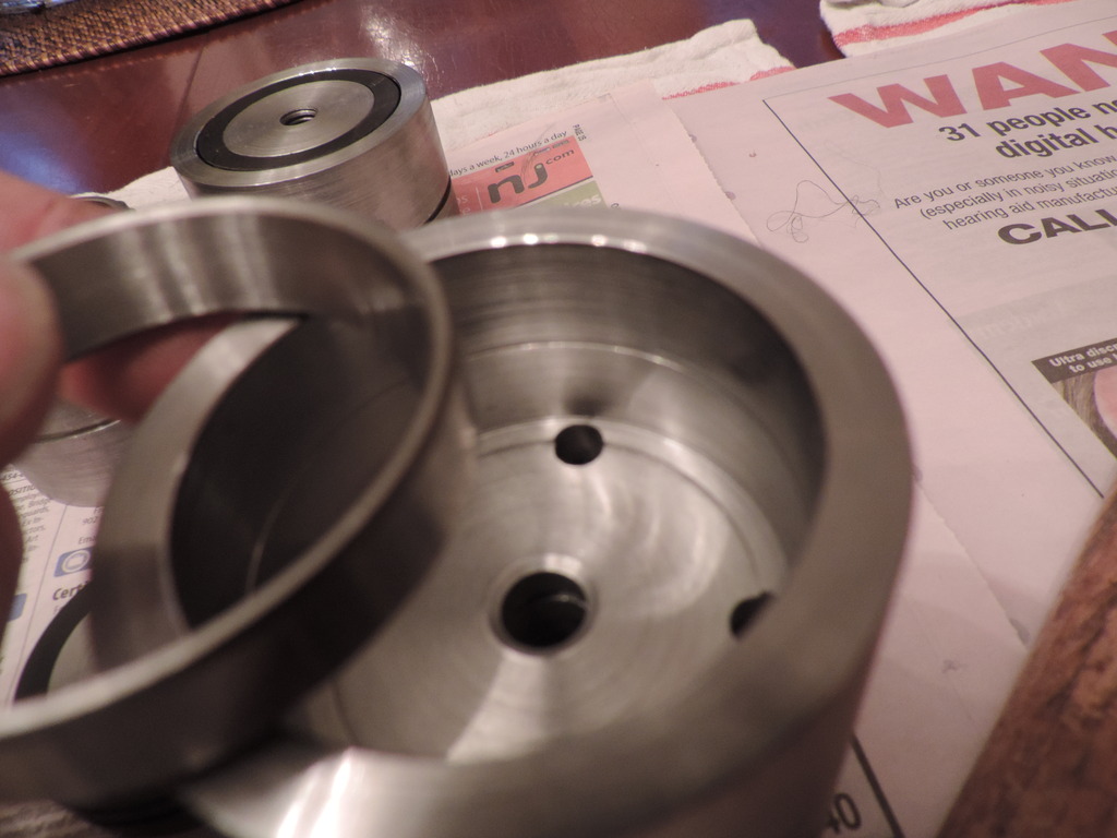

They look like this unassembled
Those for 1/4" holes you see are solely to facilitate me getting a little brass drift in to  tap  bearing races out.

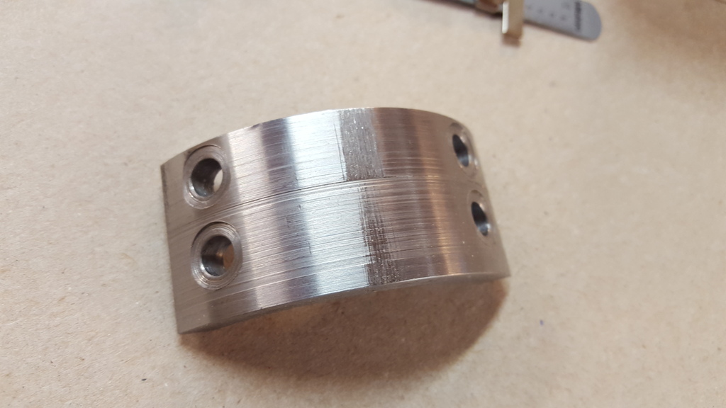

But I had to drill  and tap the sides to put these on
Like my little spot-face job to seat the allen bolts?
These ( above) are  A-36 steel ( very weldable) they attach to the knuckle OD  a 3/8" thick A-36 steel bar 2" long by 1&1/4  wide will be welded to these attachments to connect one knuckle to another.

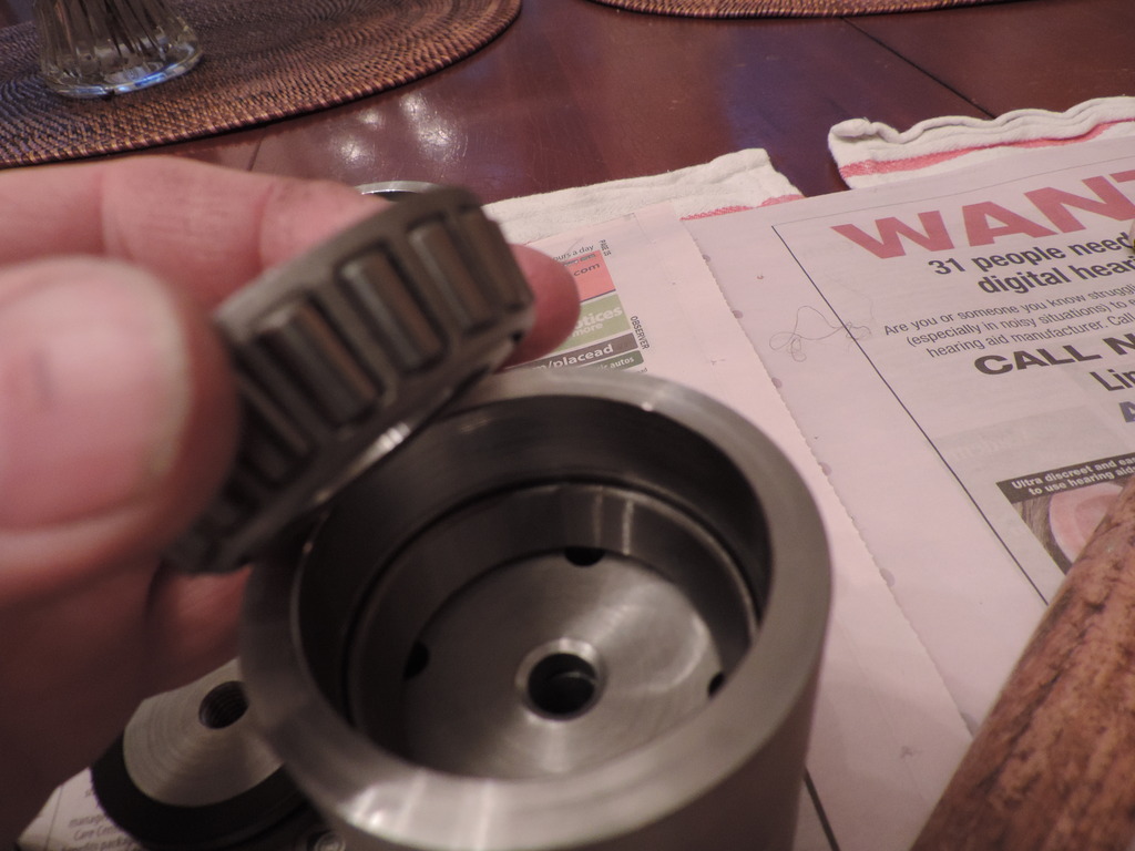

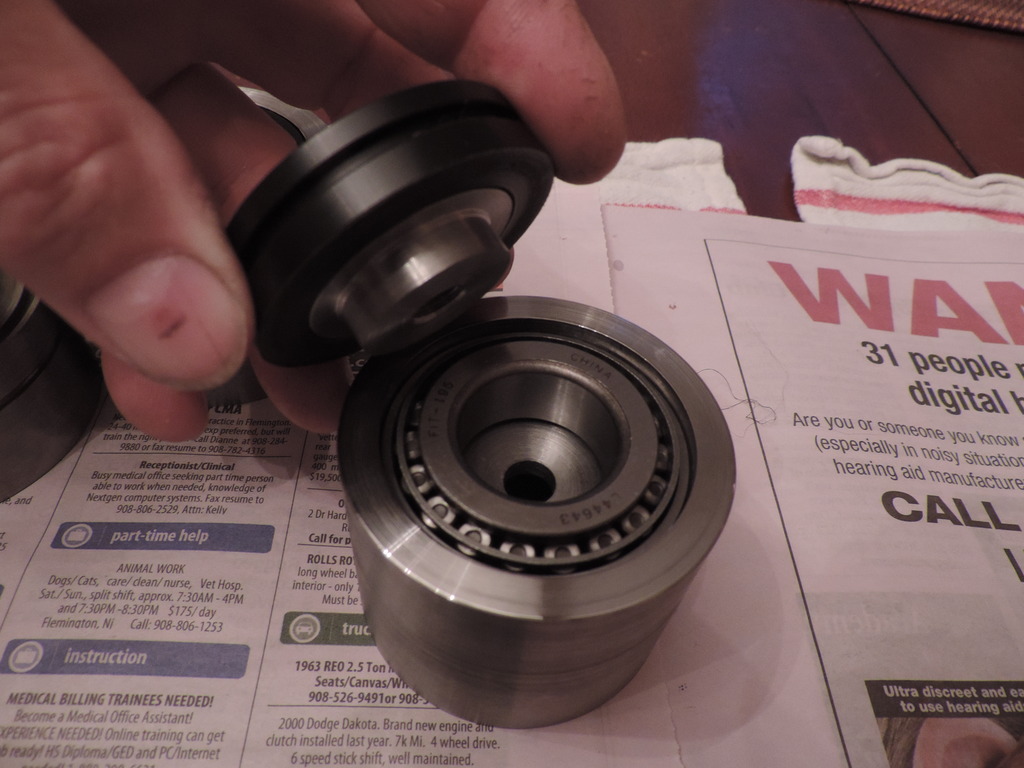

The knuckles get bearings
And a little cap
This one is all steel.  Others I made are composite so I could make them from smaller diameter bar stock and do less work
Here is a composite one with a Delrin annular ring that snap fits into place

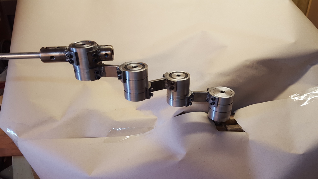

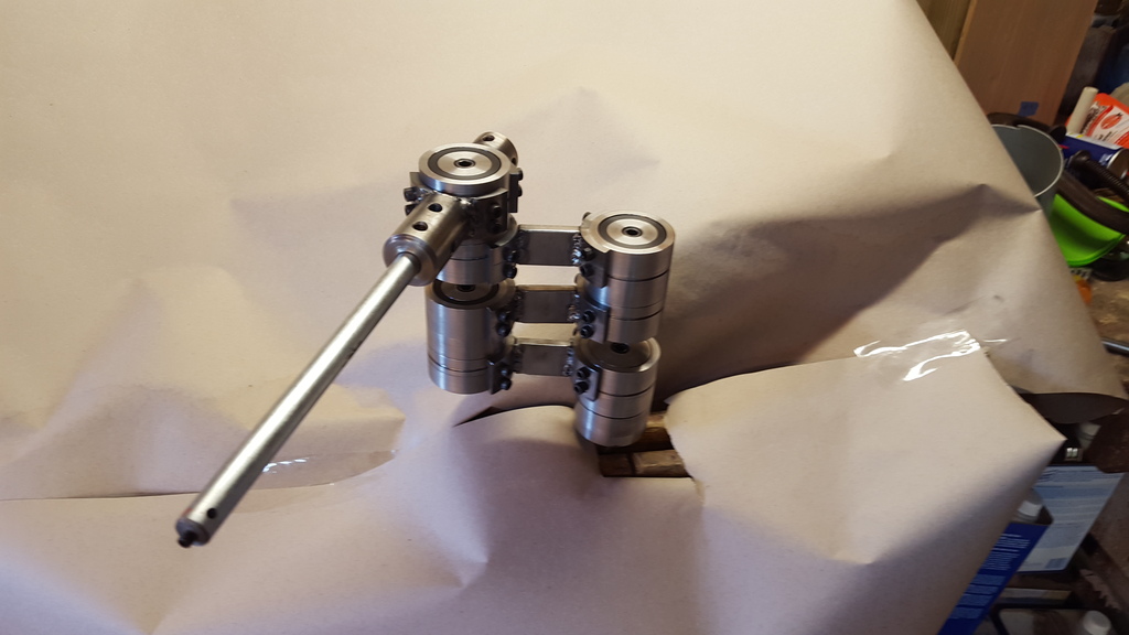

IT LIVES  The Franken-Hollower Lives
One thing for sure you can't accuse me of using too little steel.

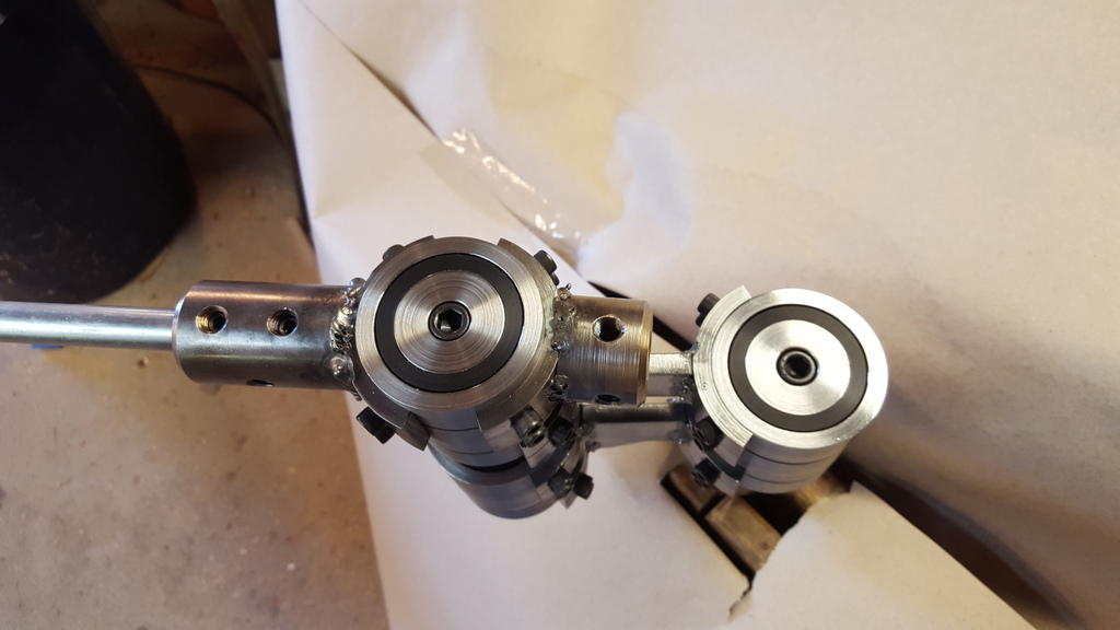

Here is is without paint.   The welds are all my crappy TIG welding . I have it mounted in my vice because the lathe mount isn't done yet.

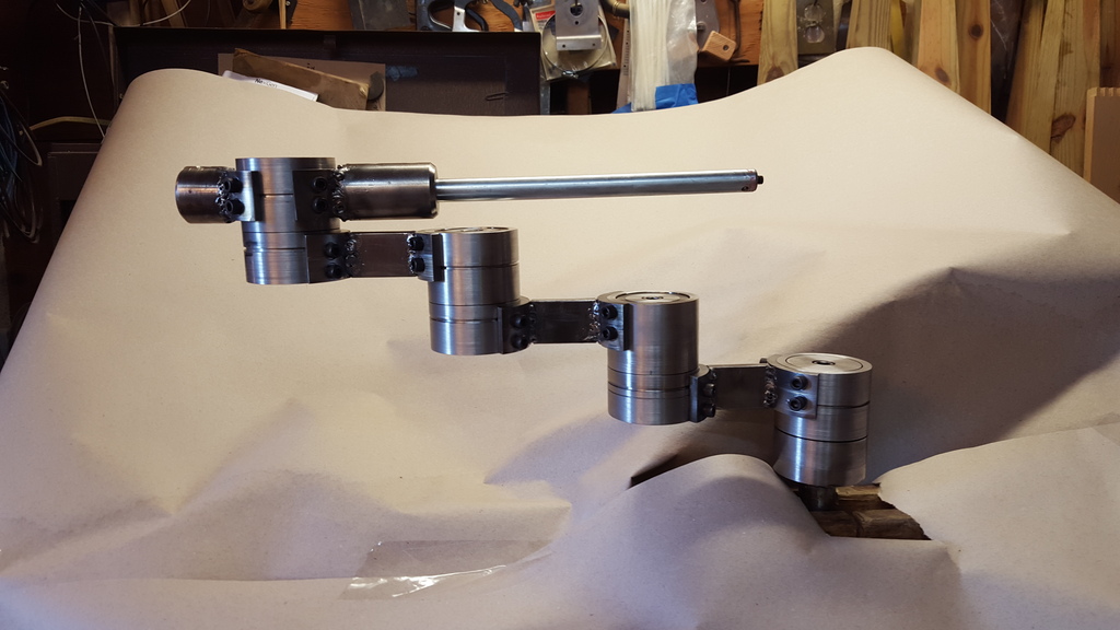

In the top most knuckle There is a hunk  of 5/8" bar stock in the tool end and the other end is a socket for a handle
Gotta have a birds eye shot
Stretched out  I get slightly better than 28 inches I can bore with the thing and there's not a scosh of wobble
And it's nice and square.  That was  a bit of a jigging thing for welding.   I couldn't have those knuckles all cocked off at goofy angles.

put it on the lathe today
Trammed it and  corrected a little run out.
