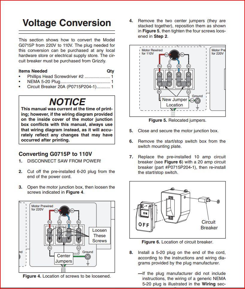

August 30, 201511 yr Author comment_62249 its a Grizzly G0715P 2HP saw prewired at 220v with a 20A breaker. distance from plug to saw would be about 40 feet. I was thinking of making my own extension using 12 gauge wire but some are saying 10 gauge might be better to cut down on voltage drop. The option to just rewire the saw is an option, I just have to look at the owners manual and see whats involved. Report

August 30, 201511 yr comment_62253 I'm running 50' of 10 gauge (4 wire) cord supplying 220 Volts @ 30 Amps out to my converted 24' camping trailer shop. It feeds a sub-panel where it is broken down into both 220, & 110 Volt outlets plus lighting. I run a 110 Volt 15 Amp electric baseboard heater, and everything else off of this cord. I have yet to trip the 30 Amp breaker. The cord I used was designed for RV use, and has extra heavy insulation. The outdoor receptacle, & plug are rated for 50 Amp use. I just checked the specifications for your Grizzly G0715P saw and it states that it requires 16 Amps @ 110 Volts, & 8 Amps @ 220 Volts. According to your saws manual you could use a minimum 12 AWG gauge size extension cord for lengths up to 50'. Below is what would be required for 110 Volt conversion. Report
