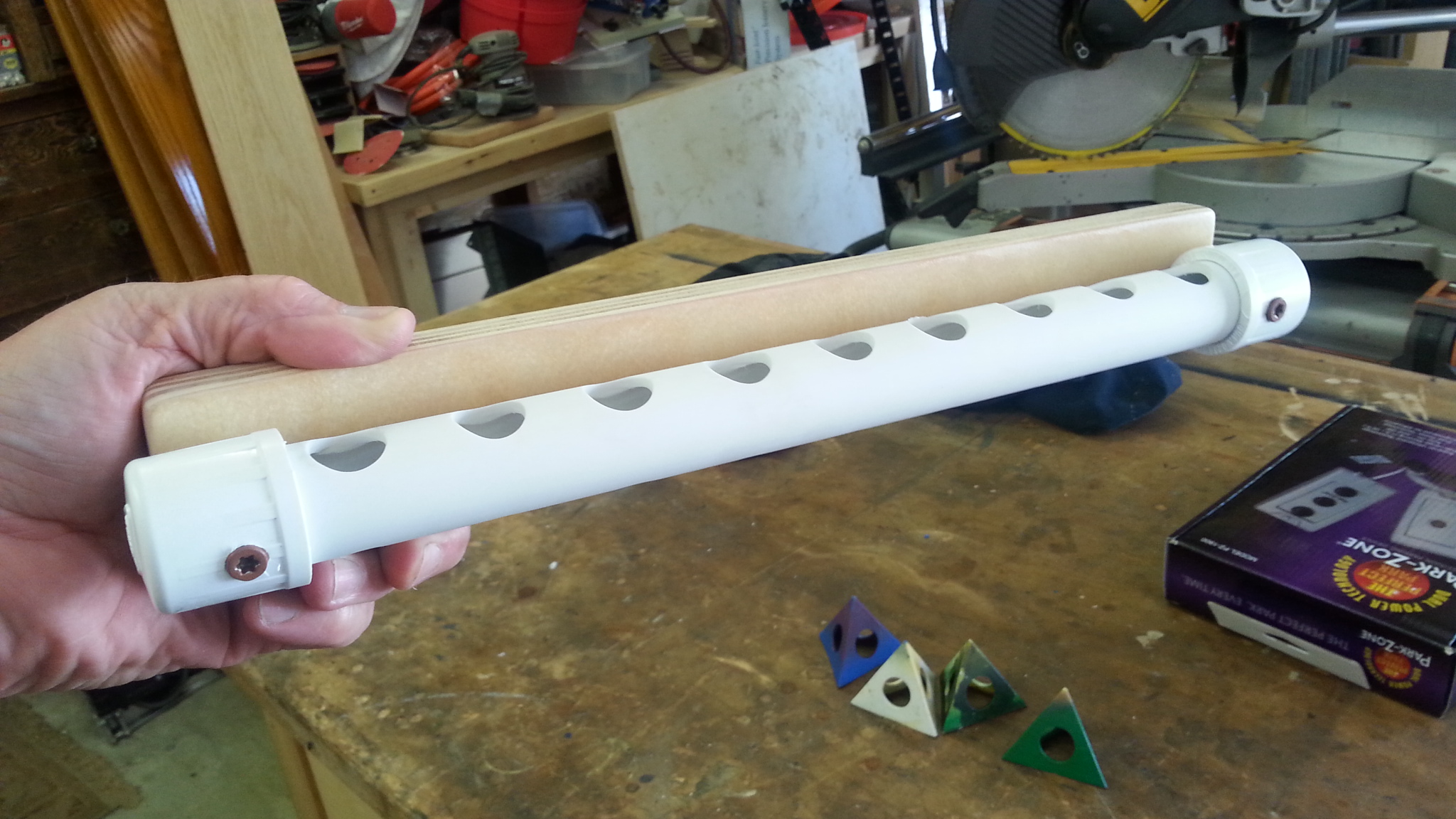

...but this one was unique. My wife needed a new toothbrush holder for her kids in her K-1 Autism class as they had been using a jury rigged plastic basket that they punched holes in. So it finally broke and my wife wanted a new one with room for at least 8 toothbrushes. It also could not be too big or heavy as it has to be hung up using velcro and it had to be done and installed by Friday.  So I cleaned off my workbench and started to figure out what to do. So after a bit of head scratching I came up with an idea and ran with it.
I used a piece of 1/2" Birch plywood for a base and then I grabbed a piece of 3/4" PVC pipe and drilled out 9 holes 5/8" in size to hold the toothbrushes. After drilling the holes I used a Dremel to smooth out the holes to final shape and then sanded the pipe to get it smooth and to remove the printing on it. The wood base I sprayed on a few coats of clear finish and then screwed the PVC pipe onto it. I took it to my wife's school and intalled it with some strips of velcro. My wife is happy which is the most important thing.
Brusha, Brusha, Brusha.
Neat idea.

Nice fix Allen and remember, "If mama ain't happy then nobody is happy."
Edited by Ron Dudelston
Nice job and it wasn't anything like my mind pictured when we were talking.
be careful with the head scratching,it is a bit thin up there!
Neat project Allen, I need to figure something out for my tools, to hang them up, instead of them just hanging around in boxes. I may just wind up buying or having a cabinet made that I can then screw something like this into.
NICE ALLEN!! WAY TO GO OUTSIDE THE BOX!! ATTABOY!!
That was a good head scratcher Allen and you come to the table and produced! Good on ya! Nice and clean looking too, that could also be incorporated into a wood shop some how too, still thinking about that one. Screw drivers? I like these type of projects myself, invention, it's fun.
