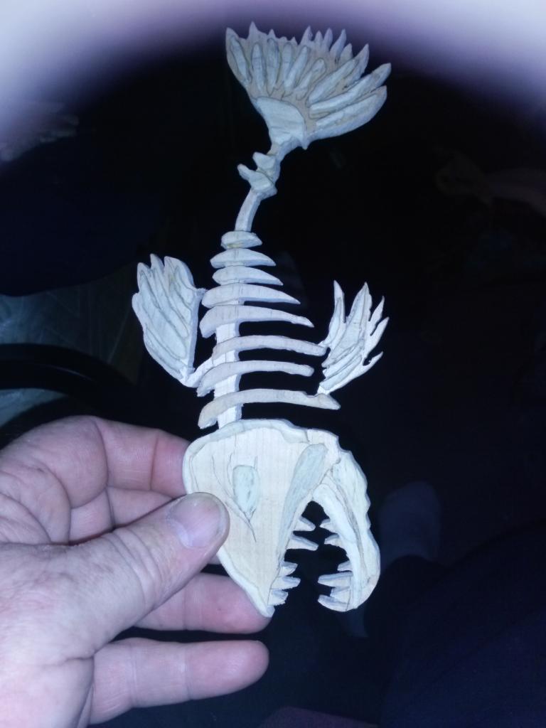

August 30, 201610 yr comment_70891 I got a few more fish skeletons I like. I'll post them up when I can. Report
