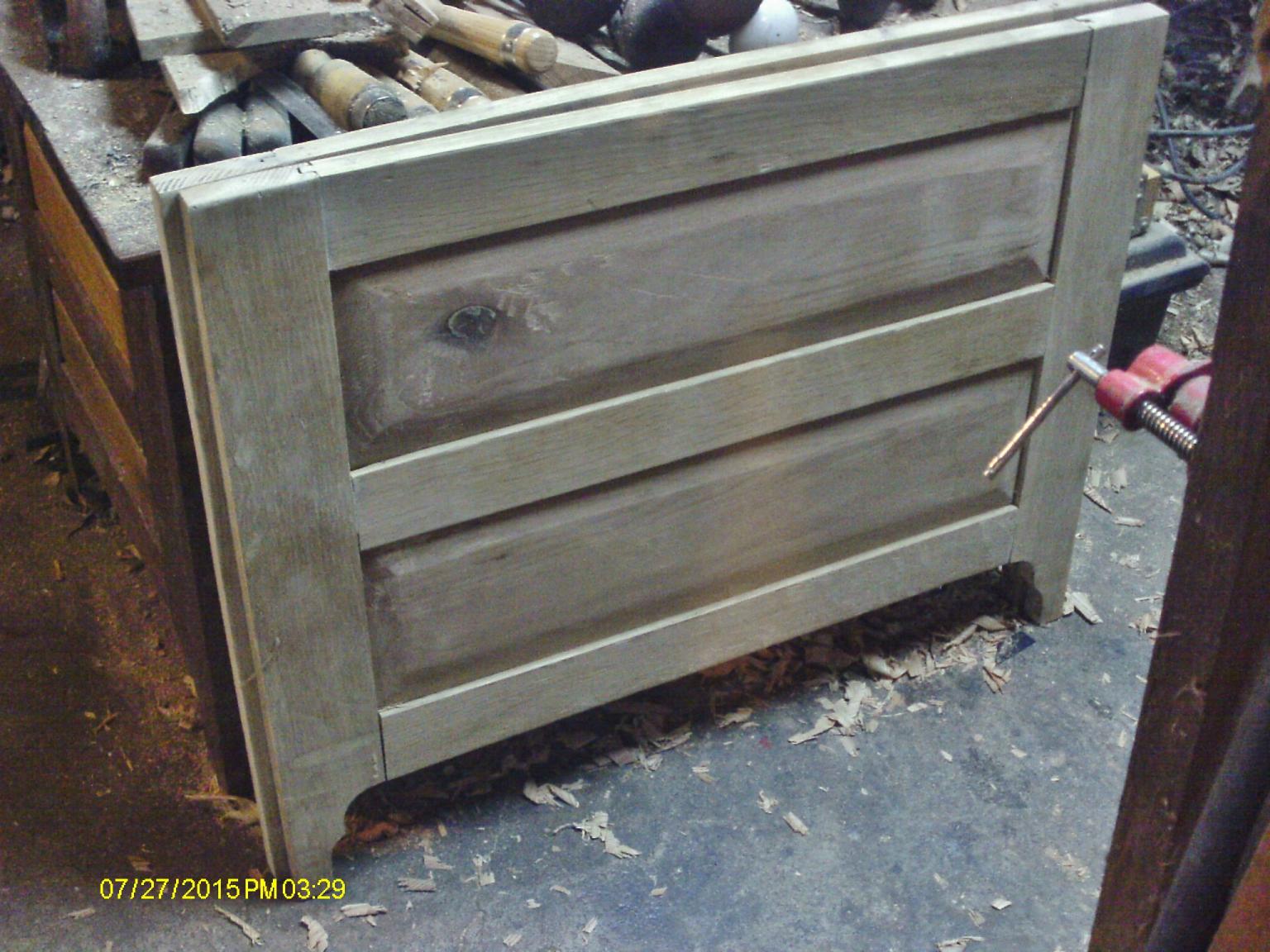

Got the last long side out of the clamps.   Compared the two sides....Something wasn't quite right?    Bottom of one was longer than the top.....Ok, scribe a cut line to adjust the splayed out leg's edge a bit.   Planes to get rid of the saw marks..  One corner post was a little angled up ( guess which one)  so it had to be trimmed down and square to the top rail.
Planes and a sander to level the glue joints flat.  Got rid of the "Bad" spots too.  Set the two sides onto the floor, and out of my way (almost)
side_panels.thumb.JPG.c3c30978ce921c87d8

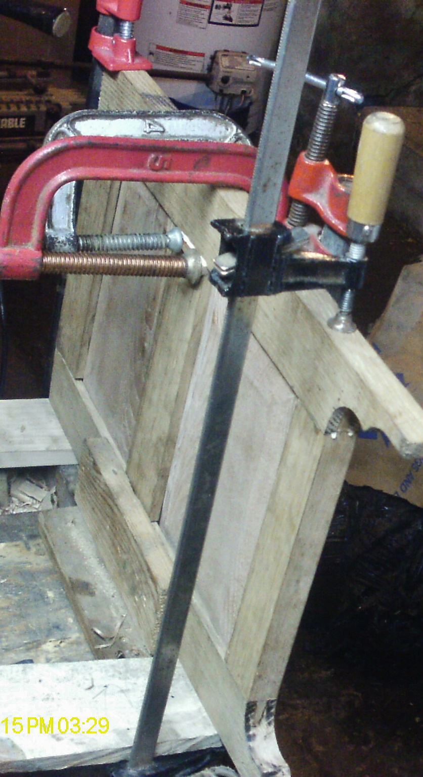

Still has a bit to  go on the fine tuning.  Brought down another thin oak plank.   It had a strip of water damage on one end.   I also needed enough to make another raised panel with.   Couple of saw cuts, a bit of work with the Millers Falls #9 and a second raised panel was done, even sanded it!   Set up the Clamping bench, again.   Might get good at this before too long.  Set parts together.....Raised panel#1 was too long?   And a might thick along an edge.   Scrollsaw to trim, smooth plane to re-do the bevel..try again.
clamped_up.thumb.JPG.67dbbbf63c7f7d2530a

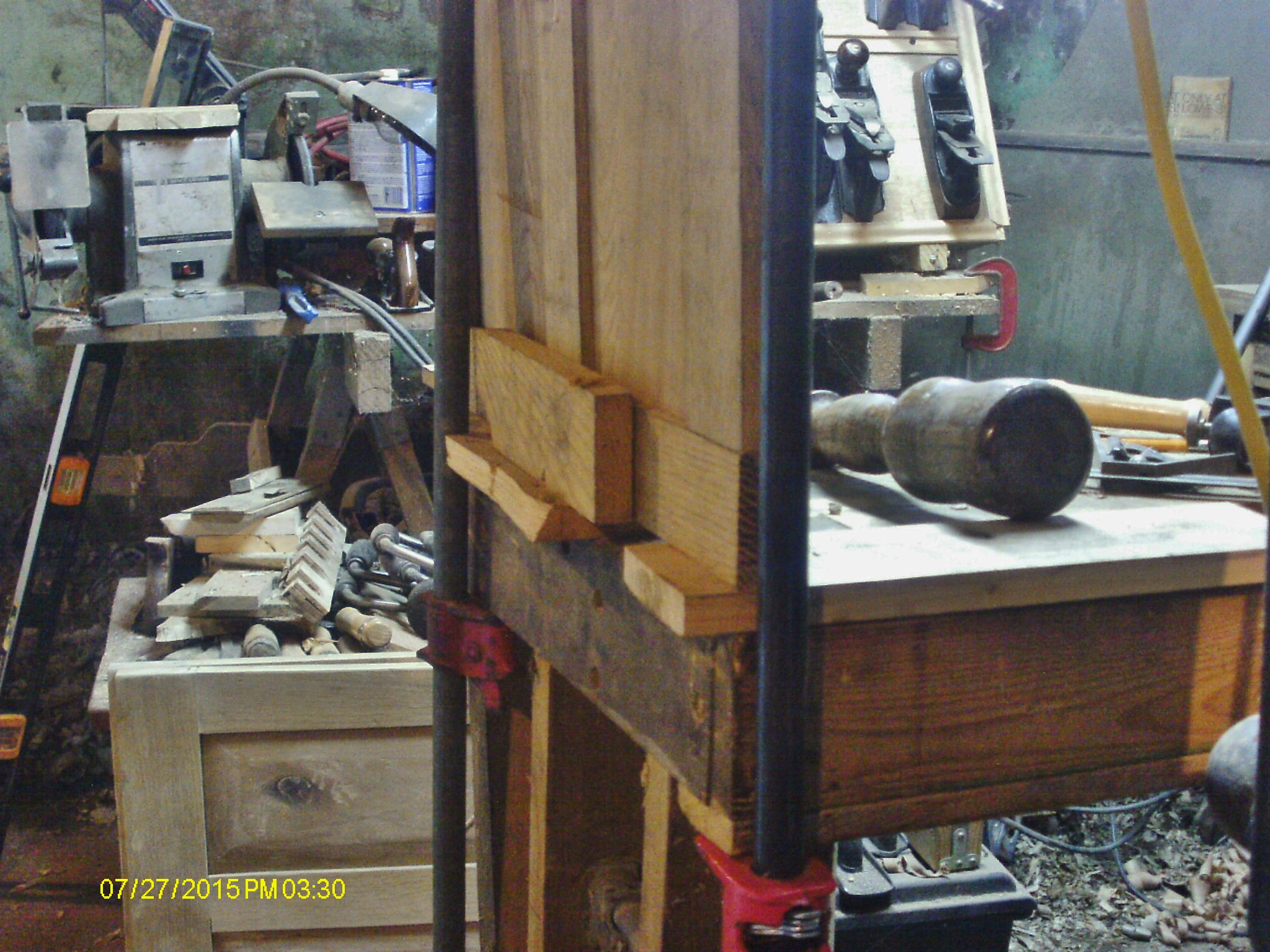

This is the "good" end.  The other end had a problem.  Center rail was too short.  (#@#@##!!)  Could not crank down enough to close the gap.   Split off a strip from a thin panel.  trimmed two pieces to fit into the gaps( yep, both sides) and added a few MORE clamps
55b693b2353b2_moclamps.thumb.JPG.25b8559
The "F" style clamp to keep the thing from bowing.   The two c clamps to clamp the filler strips....
