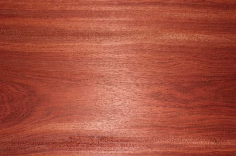

July 16, 201511 yr comment_61368 Here is a nice small slab of blood-wood for cheap that would make a great cutting board. http://www.ebay.com/itm/4-4-Bloodwood-36-x-5-x-1-A08925-/201373763453?pt=LH_DefaultDomain_0&hash=item2ee2cfc77d On a different site here is a photo of Blood Wood naturally finished with oil. Unless you are looking for a blazing red color, then stain or dye may have to be the way to go. Report
July 16, 201511 yr Author comment_61371 The customer wants red heart but is cost prohibitive @ $28 per board foot my cost. So we are going to try a dye on maple. They are ok with it fading and needing to reapply the dye. Bloodwood is also semi open which makes it not as good as a choice for a while cutting board. Report
July 16, 201511 yr comment_61375 The customer wants red heart but is cost prohibitive @ $28 per board foot my cost. So we are going to try a dye on maple. They are ok with it fading and needing to reapply the dye. Bloodwood is also semi open which makes it not as good as a choice for a while cutting board. Gotcha! Report
