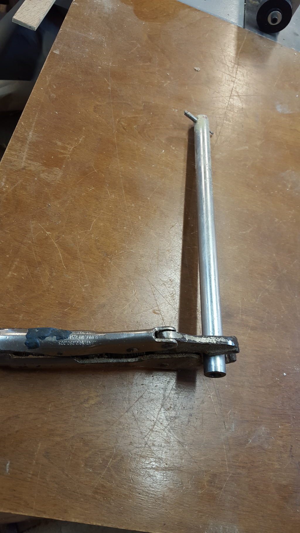

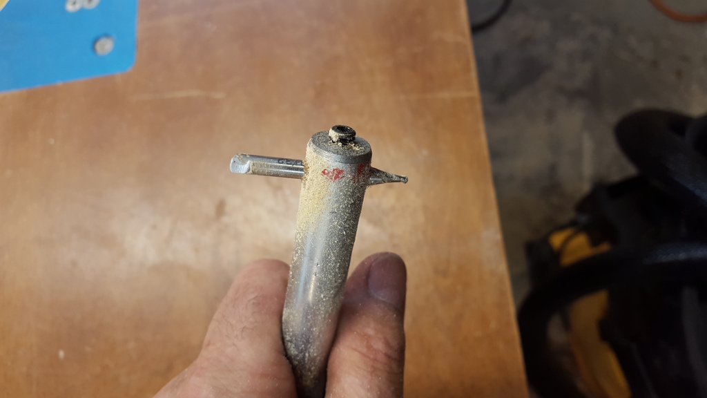

So I made one.
I got a bar of 5/8" drilled and tapped a hole in the end for a grub screw.  Then at a right angle on the bar near  the end with the tapped hole I drilled a .1875" hole into which  to shove an old broken end mill.
End mills are made of HSS so they are pretty good.  I have some carbide in that diameter too but I'll go with the end mill chunk.     So it sticks out a bout 1.75"  If I heated and bent the bar stock it'd stick out some more,
This is what it looks like.
For the working end I ground it like a little scraper. You can see the ball mill on the other end.
But I didn't make a wood handle for it.
Holding  the steel bar-stock it in my hand  it worked but If I leaned in it there was a bit of torque
So I attached a  very sophisticated  specialty handle
And you know, it works about exactly as well as I imagined  as those  EXPEND-O-LICIOUS commercial hollowers that   was drooling over
A hunk of bar stock and a chunk of busted end mill.

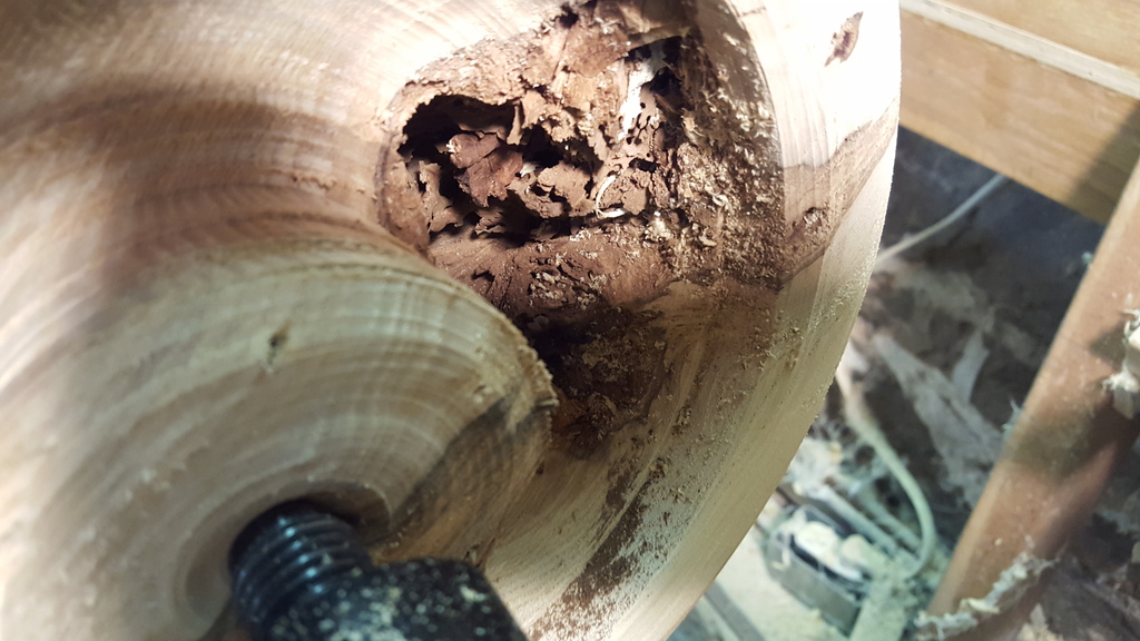

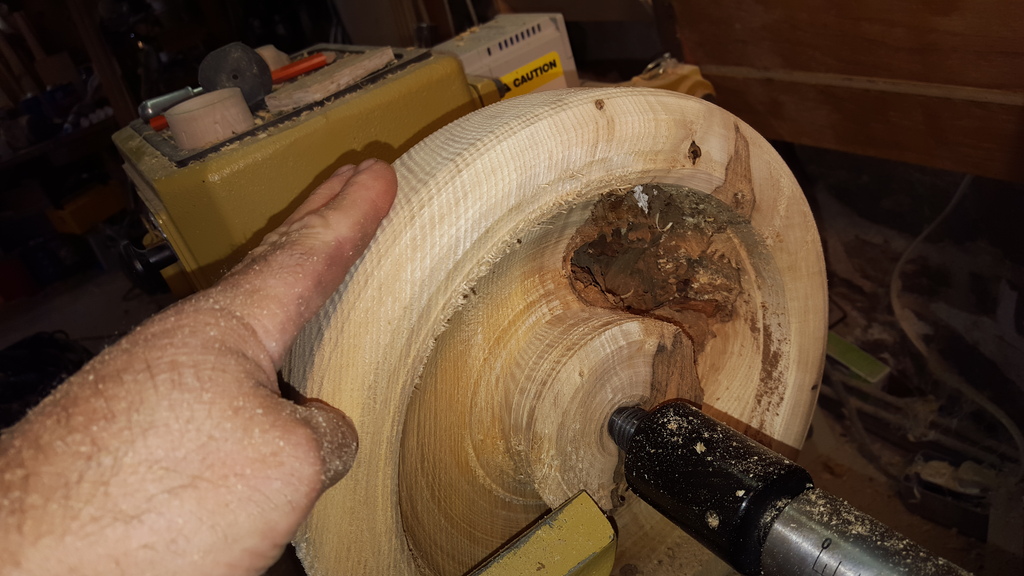

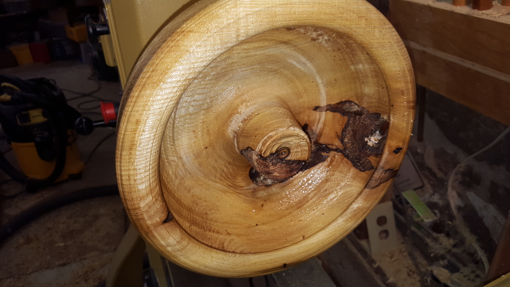

This is what I'm doing

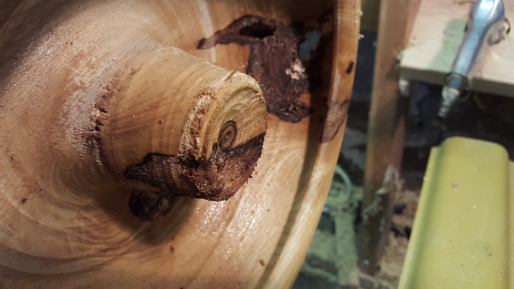

Can you see the lip?
It's about as deep as my end mill sticks out
The piece has a hole going through the side from a carpenter ant nest.  It's been a struggle to turn cox the big cavity makes for an interrupted cut and imbalance.  But it looks cool.

That handle is the battery terminal clamp on my truck. :lol:
Larry, I hear ya, that handle is also the clamp that holds the throttle cable onto my lawn mower!
I swear I didn't get it offn' no truck 'n not no lawn mower

I was surprised at how well such a cheap solution worked.
I'm prolly not ever going to buy one of those expend-O-licious fancy pants hollowers
I  will  - for sure- end up  making a longer  version putting  handle on it and using carbide.
If it works as well as this appears to be working  I'll have a few of them with different cranks
