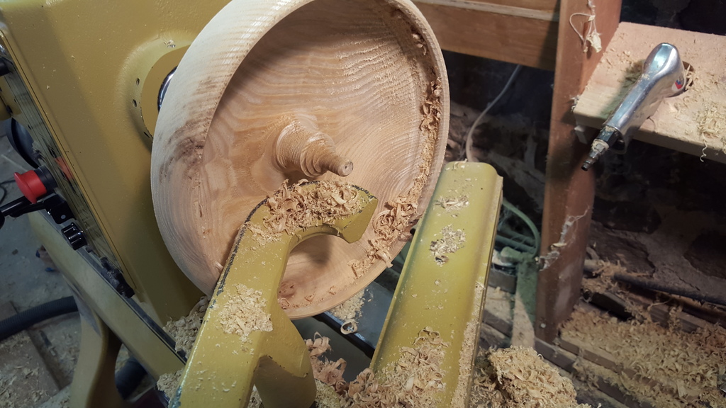

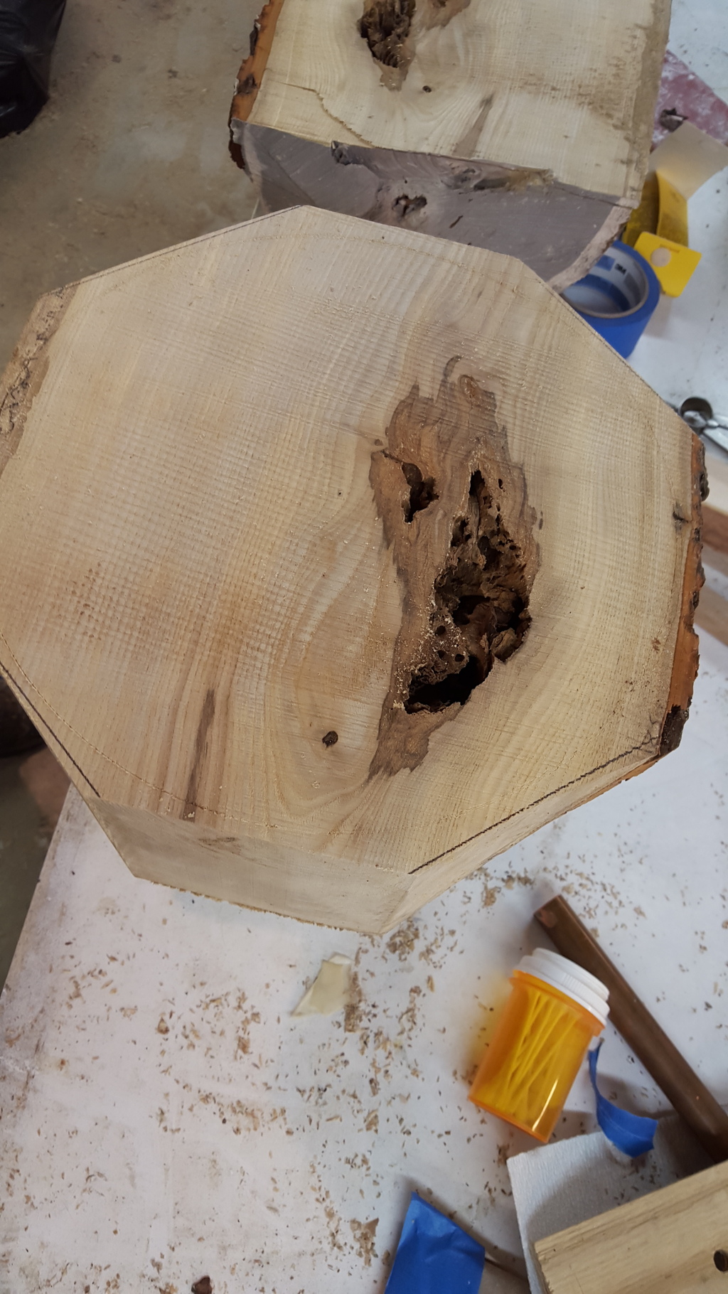

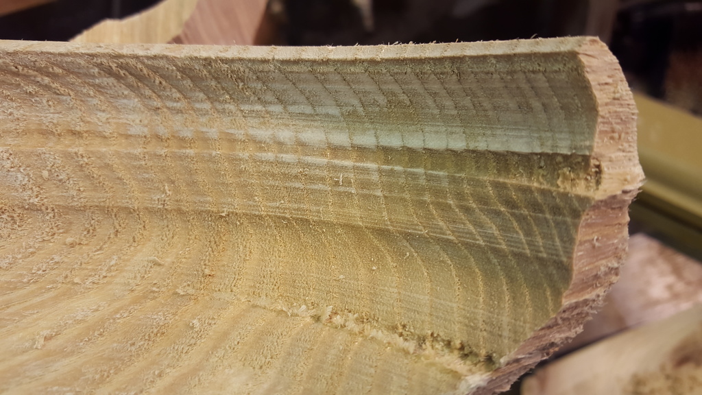

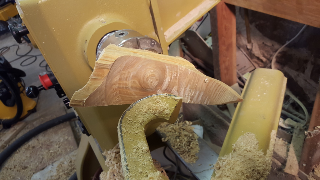

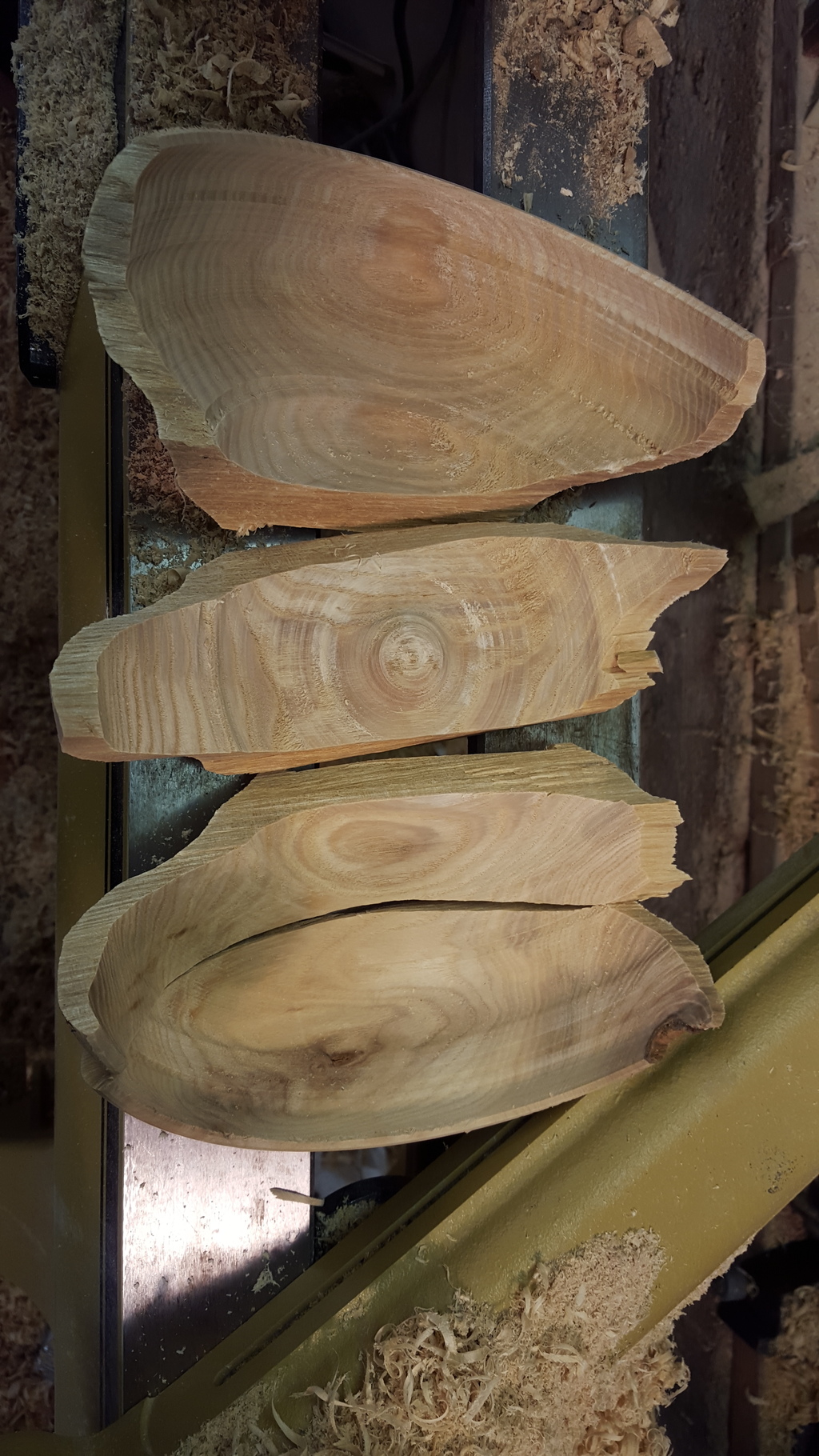

July 1, 201511 yr comment_61037 I found a walnut log Halved it Made an octagon Mounted it Rounder r' up and was happily making a bowl with nice thin walls a slight recurve at the top and what I thought were nice lines. Then BANG GOSH and GOLLY Well I didn't actually use such harsh language. Here's the catch that did it At about 1350 rpm you can imagine it was a dramatic instant. Report

July 3, 201511 yr comment_61066 And I thought I was the only one could that, I had 4 pieces. the next one was 3 but I am not doing bowls anymore to get to no pieces., Report
