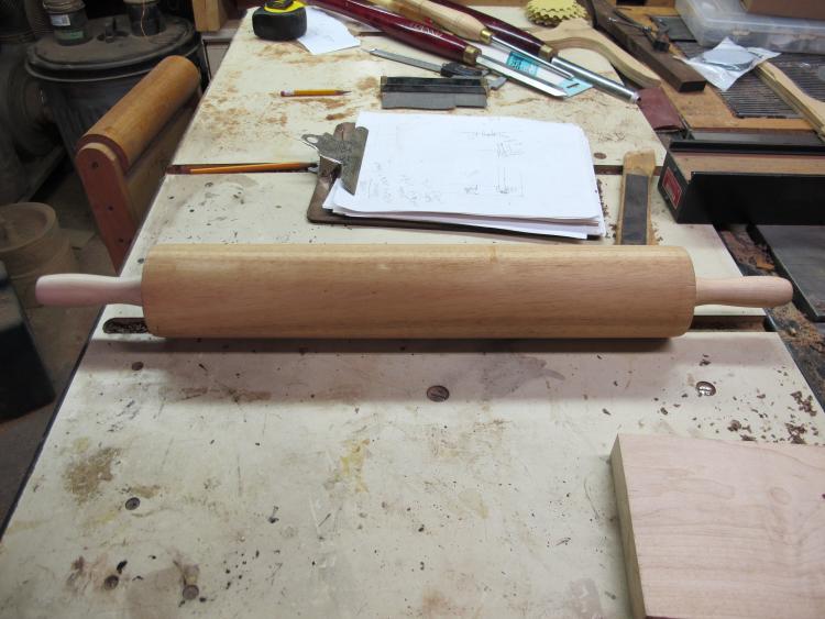

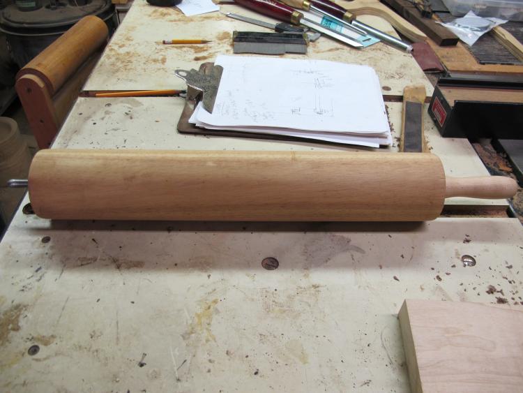

This one fell on the floor

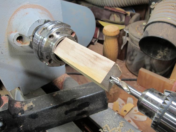

Maple blank drilled to 25/64"

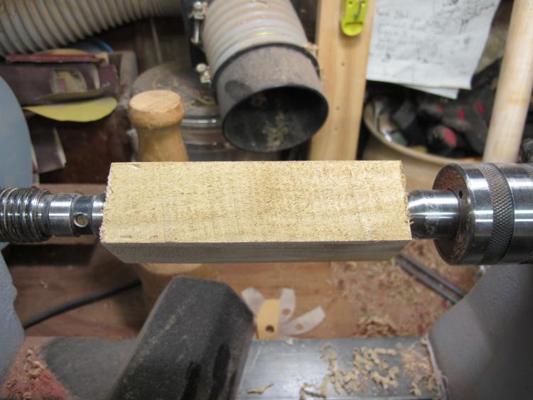

Removed the chuck an set up to turn between centers

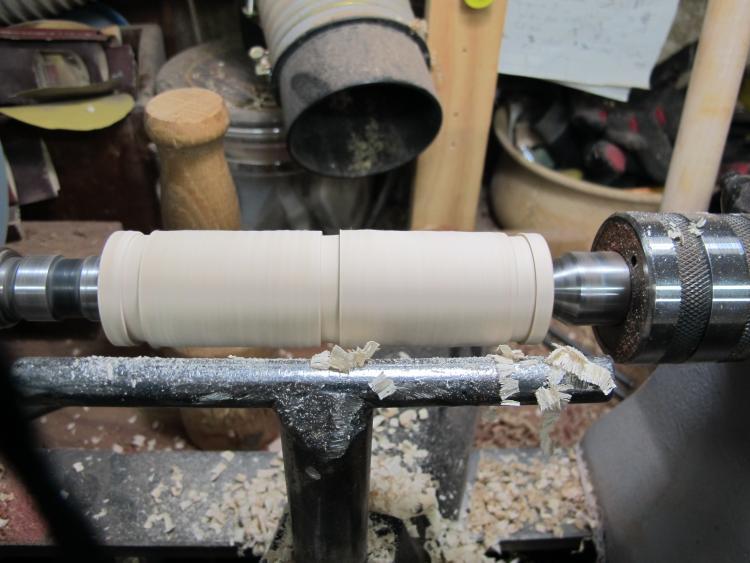

Rounded the blank and set the overall max diameter

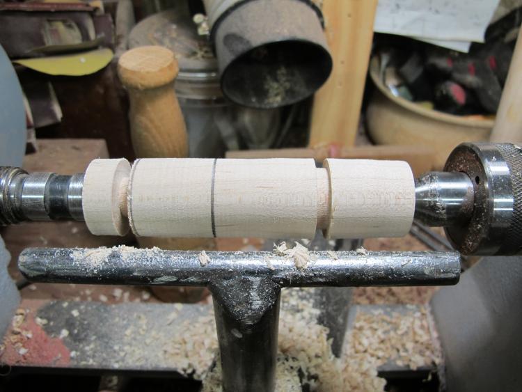

Parted away some material to set the overall length
Set the minimum diameter

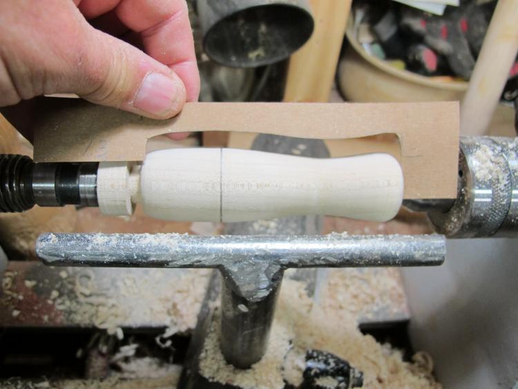

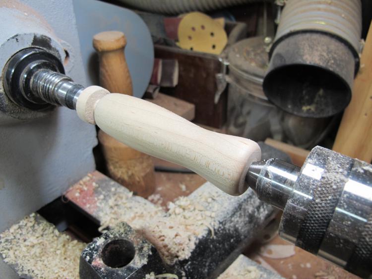

Skew and gouges to the shape and check with template
Ready to part off the waste end. Cut it free with a saw.

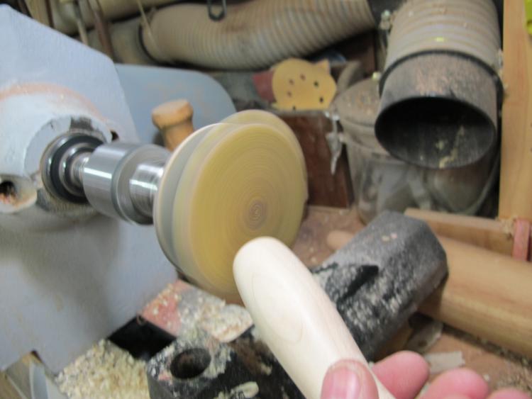

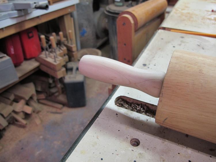

Rubber mallet put the new handle in place.
Ready for the Bake Shop at school
I added some mineral oil to the entire rolling pin. should be as good as new.
