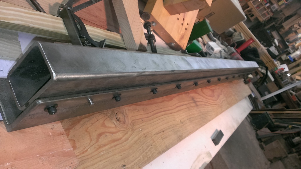

Here's my progress so far:
End view of the Fence in progress
There are 13,  1/4-20 bolts holding them together  pinned  on the ends with dowel pins

LEMETELLYA  descaling that great long  hunk of 1/4" X 3" X 3" angle has proved to be a bigger job  than me.
 The black oxide millscale is deep in pits and grindering it all off is not much of an option. I spent a few hours at it and  - - well that in the pix is a good as I got.
I tried some  real muriatic ( 20% technical HCl) not the stuff they sell at the BORG but the real stuff. But because the angle is so long I couldn't do a real pickle and  brushing acid on is not an option.  I tried.  It just doesn't get the job done.
So I got most of it off, but not all.  That sort of says that a paint is a doomed effort.
Maybe wax is the way to go.
Maybe sand blasting will do it?

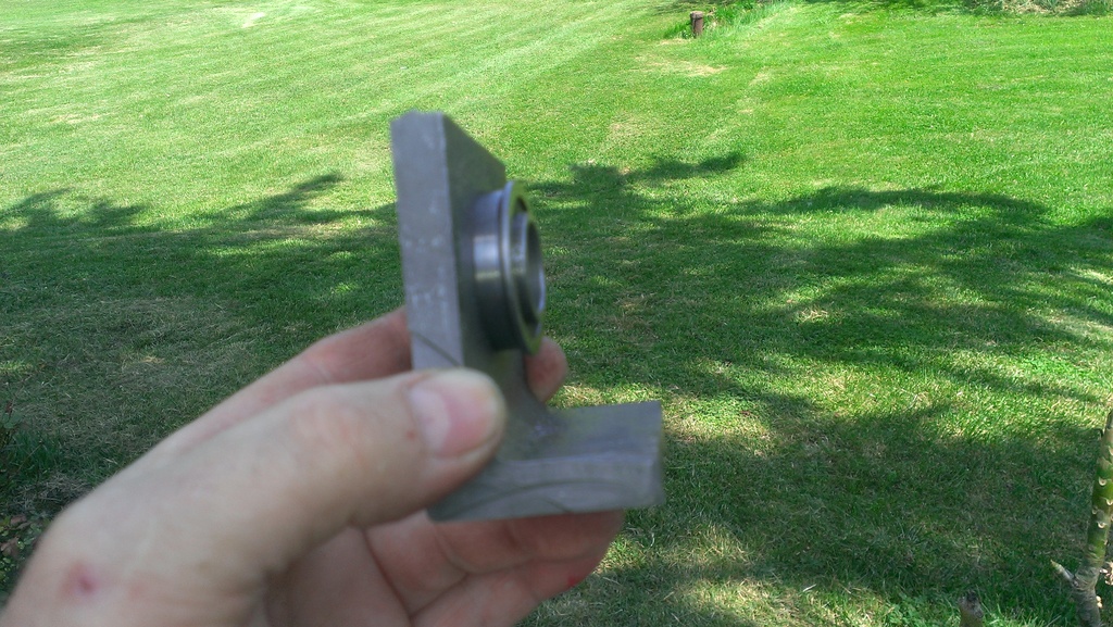

I'm going to need a way to mount the shaft that will be the eccentric cam.
 OK  I considered welding something up but I got this hunk of steel  an angle  about 5' long  and about 6" x 6" on the flange  sides by 3/8" thick
So I'll cut some angle off that.  It'll be thick enough ( ya think???) Well the bearing are 3/8" thick so it sort of makes sense.
Yah it's heavy, but I only want to make this once.
So I cut of some bots of that angle with my grinder and chopsaw.   Then I tossed it in some acid to decsale it.
 But how to get the hole for the bearing??
I mean I need a hole that is exactly and precisely 1.375 plus nothing  minus 0.001 and zero tenths.   IT's press fit for the bearing.  I don't want slop.
And it's 3/8" thick
And my little Walker Turner Drill Press is tapped out at anything around 3/4" in steel and drilling won't cut it anyways coz I need   hold a tight tight tolerance.

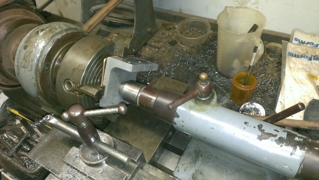

Well, I got an Elgin jewelers lathe that I got for free. I got a 4  jaw chuck.
It'll be a stretch but I think I can do it.
Here it is being  positioned in the 4-jaw. I'm using a center to get it ball parked
Squaring up the face and then the  hole which was done in the Drill Press
It's going to be close~!!!
Bearing%20in%20angle%20-01%20_zpspav5avr

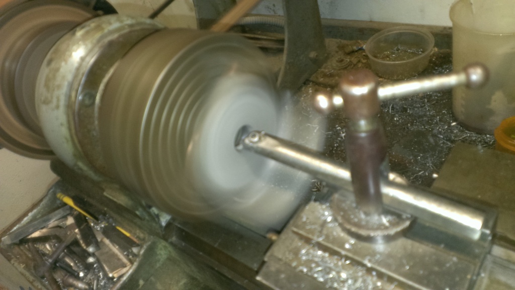

Whirrr
Measuring the bore - I'm working to within a half a thou'
Bearing%20in%20angle%20-06_zpsjlhkwonl.j
I been to this rodeo before
It's going in nicely ( I need to  do this one more time)
Bearing%20in%20angle%20-09_zpsu2c2fbvx.j
Mind you I considered the logic of working to such tolerances to get a press fit on a bearing that is going to be installed in ANGLE IRON~!!!
Yah I know the angle of the Angle Iron is not going to be square to start with.  And I lack a milling machine or a grinder.
So when I press fit the shaft  into the bearing  ( it'll be a very light fit maybe 0.0005" interference) the contact surfaces of the two angles will be wildly out of plane with each other.
But, I have a plan.
It calls for abrasives and patience.

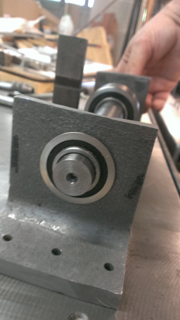

Well, I got the  work done on my little custom pedestal bearing blocks. they are all flat and squared up
And I made the eccentric cam clamp shaft.
It's about 8" long between the bearings.  I figure this'll give me lots of Spring to accomplish a real stiff clamping action.

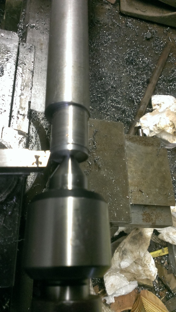

I turned it between a 4 jaw chuck and a  live center
There's a video of it  and it works
Here it is  in the lathe
Close up of the eccentric part of the eccentric
I left the ends long to get a wrench around for when I fit it with a handle and set the loading

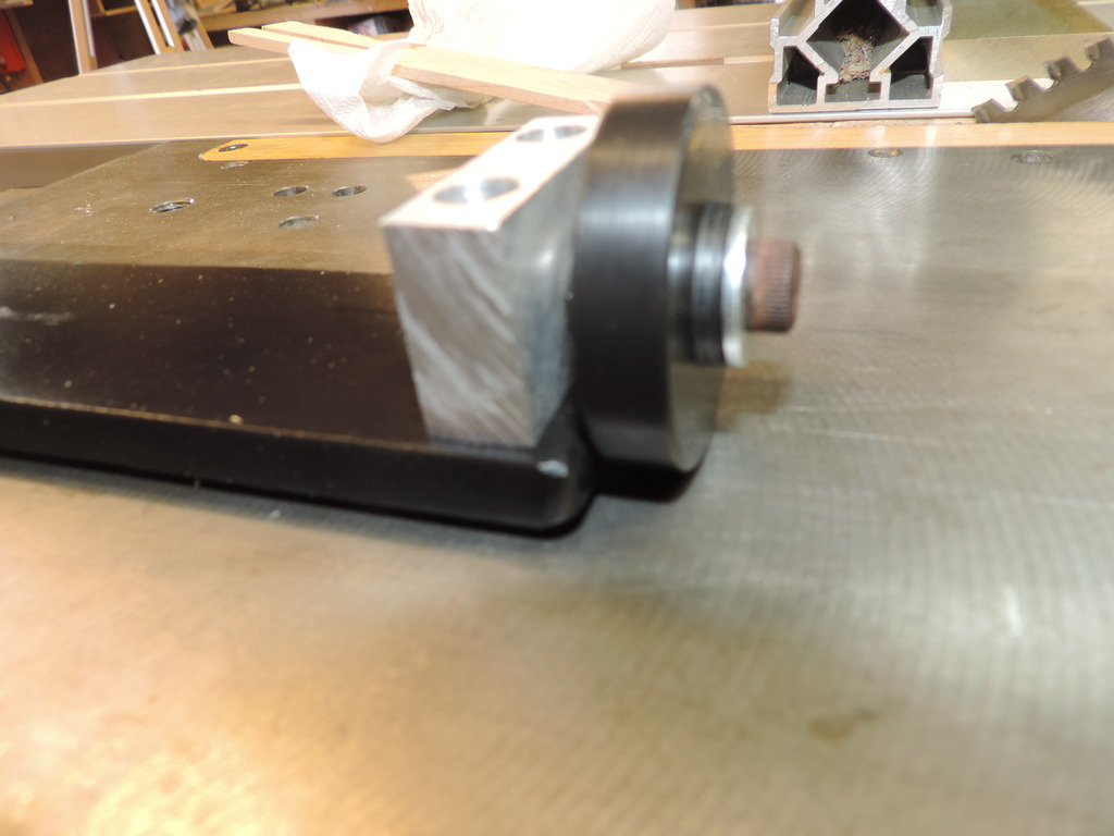

Up by the red pen you can see the little 1.75" dia delrin wheel I turned to  mount on the end of the fence main support bar  to keep the thing from dragging on the tables.

Crummy  close up picture of the Delrin whell that prevents it from dragging on the tables
There is the wheel mounted on the end of the main  support bar
