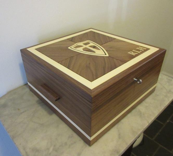

Here are a few photos of my newest project.
Made from Walnut with Holly accents. The Intarsia Crusader Cross is made from Holly and Ebony surrounded with bookmatched walnut. The interior is lined with blue suede . Measures 15" x 15" x 8". The hardware is Nickel plated.Here is the info sent to me by the client;

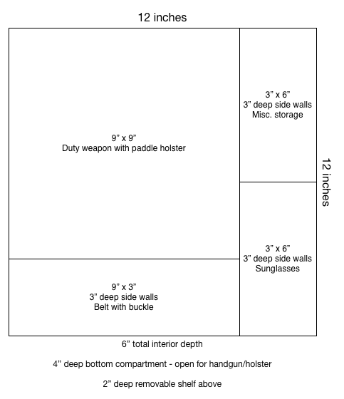

I am a police officer in NC, and am interested in having a custom valet box made to house / organize all daily carry items. I have drawn the internal layout & attached as two files. Also, I would would like to have a cross inside a shield (as attached) inlayed large/centered on the lid, and my initials inlaid in small letters near the front/bottom right corner of the lid. All the dimensions in my sketches are minimum internal dimensions for the sections, and several of the items have tight tolerances, so the overall size would need to be slightly scaled up to allow for the thickness of the wood.
post-2931-0-01755900-1429121172.png post-2931-0-60602100-1429121187.png post-2931-0-91341800-1429121210.jpg
And here are the photos of the finished project.
post-2931-0-66805000-1429121288.jpg post-2931-0-17550300-1429121302.jpg post-2931-0-53160600-1429121317.jpg post-2931-0-88416500-1429121327.jpg  post-2931-0-87419300-1429121339.jpg

Excellent! Really purdy gun box. Bet he's happy.
Mike, that is absolutely gorgeous.  Great job.  How did you attach the suede?  Contact cement?
