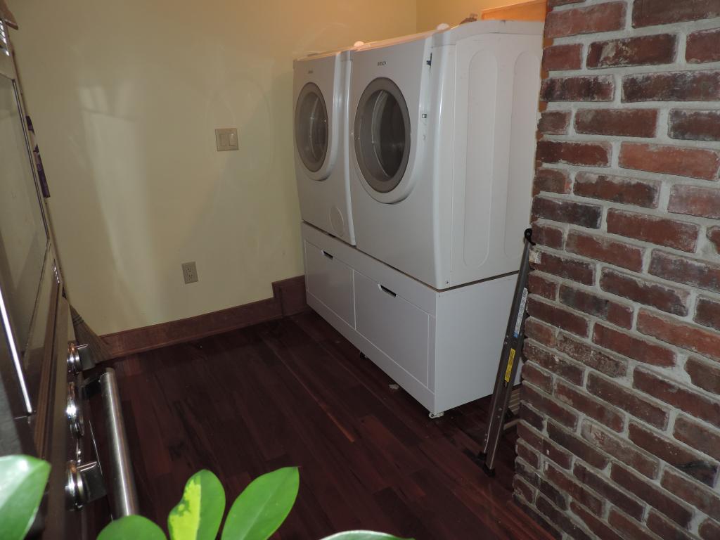

Finally it's done.
I couldn't get anyone to help me toss this three hundred pound monster up the 26" onto the pedestal so I did it myself.
Got some straps and some rope and a four sheave block and tackle and hung a beam.
Here she be:

 The last part the getting the beasties up in the air  took the longest.
Finish is Borg Bher Gloss applied with a roller for coverage and brushed out for gloss in a color the missus picked from their card rack.  She's got a better eye than I do for this.

Hold on to the plans Cliff.  I think a new washer and dryer is in my future.
Plans?  I pulled this one right out of my backside.  Don't recall using so much a a piece of paper.   I can't really  say why I started it. I had so many other things I wanted to do and one day I was cutting mortises and gluing up a frame.
 If I planned this there are some changes I think I'd have made.
One of the changes  would have been the height (it is a bit tall):
The front casters are Great Lakes  leveling  casters
  that let me rotate a star wheel and lower a rubber post to lift the wheels so as to lock the thing in position.  These casters - - or rather the star wheel inside them - - I would have accessed VIA a pop away panel held in place with magnets.   plus I'd have inset the rear swivel casters to  match.  This would have let me lower the whole thing appreciably.
I'd have planned for the drawer slides too.  As it was I just left it off till the  drawers were made figuring I'd have plenty of room to rig something up. I did, but it was a PITA.
 I wanted DEEP  and large  drawers, to get things like gallon bottles and paper towels in,   so the height is part and parcel of that, so  - -  it's tall.
