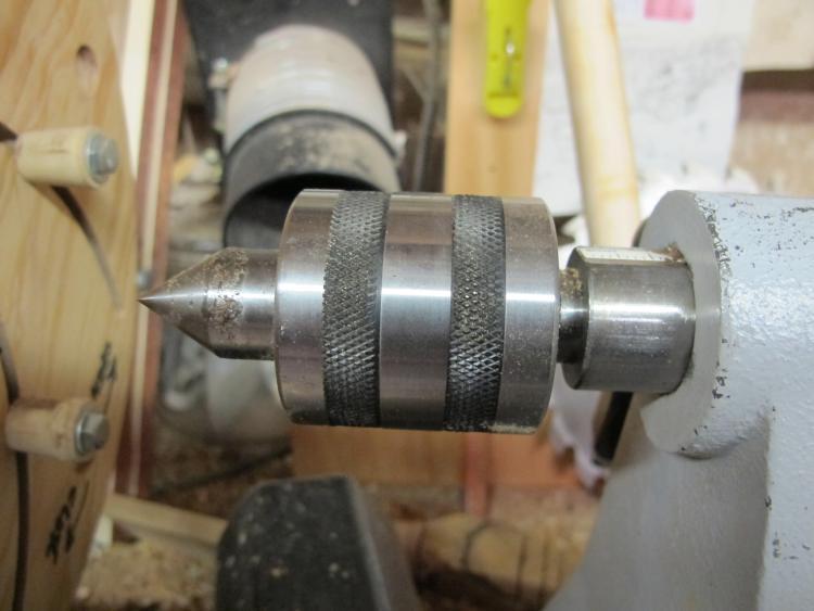

As for me, a little lathe time this week. Actually just replacing and testing a new tail stock live center. While working on the last couple of projects, I noticed a vibration of the work piece as I worked closer to the tail stock. At first, I thought maybe the tail stock wasn't aligned... not that. Maybe the locking lever for the tail stock advancement screw was causing the problem... nope. As a last resort, I replaced the actual tail stock live center. The one I was using, seemed OK. No grinding or play but I guess, under load, the bearings were worn enough to cause enough play to create the vibration. The new one solved the problem. As you can see, I've already baptized the new one with super glue.
This one is from Grizzly. It is a lot heftier that my old one, too.
