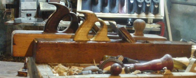

Well, dug out the dovetail thingy, it was junk.   Decided to just make a tenon under the tote.  Had to thin the tenon a bit to fit.   Scrollsaw to cut the outside curves.   Forstner bit for the insides.  Roundover bit to start the curved areas of the grip.   Then cut a 1" wide sanding belt in two, and "Brusha Brusha, Brusha.."   Smoothed down the rough spots.  Test fit, and then some BLO
and
and again
Alongside the other 22" long Try plane.   Not too bad for just a chunk of firewood?
Well, after an overnight dry on the glue joint, and a couple screws to reinforce things....we have shavings!post-3502-0-52810400-1421696769.jpg
