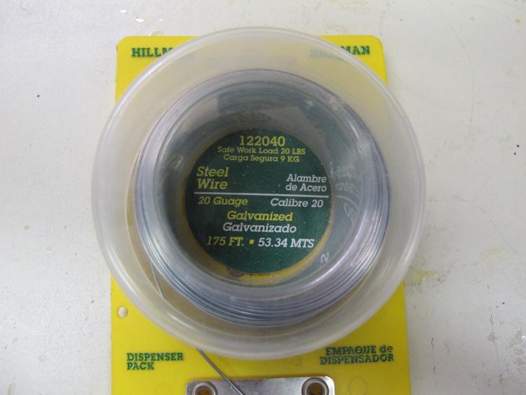

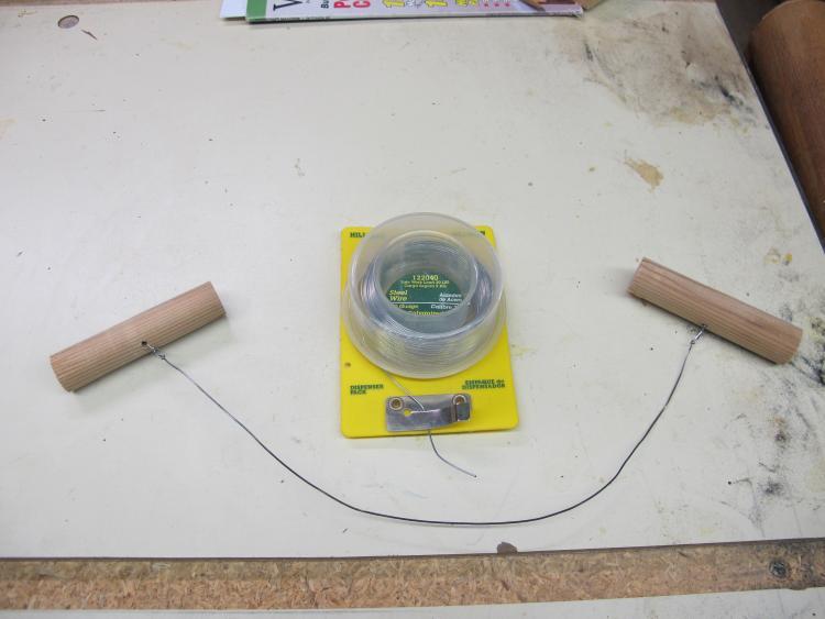

This past week, Ron Altier posted an "inside out" Christmas ornament. He used a burning technique that raised a question about the process. I am sure there are as many ways to do this as there are turners. Here is my setup-

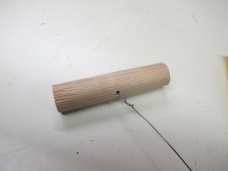

Eventually the wire will break so easy replacement is necessary
The wire came from Lowe's
I usually use the skew chisel to create a slight indentation. This helps guide the wire and keeps it where I want it. With the lathe spinning, place the wire in the pre-cut groove and pull it against the spinning work piece. Apply enough pressure to cause the friction to heat the wire and blacken the groove. It will smoke a little.
DO NOT WRAP THE WIRE AROUND YOUR FINGERS OR HAND! The wire gets hot! Or, if it catches, the results could be catastrophic.

one thing to add is that different diameter wires will provide wider or narrower lines
Great post as always Lew!!
I usually burn mine twice. once before final sanding and then again after to clean out the burn. a quick touch with 600 grit will clean up the edges without erasing the burn.
That's a great idea, John! Thanks, I really appreciate this type of input. I'm so isolated here, I get tunnel vision.
