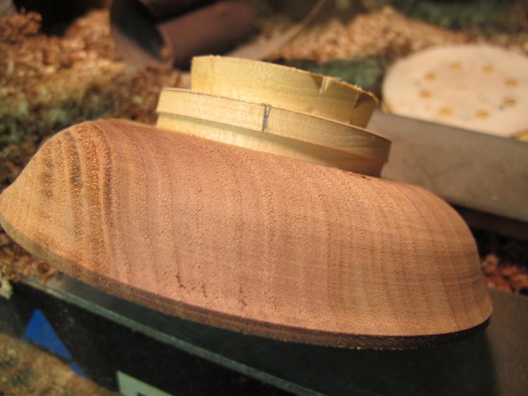

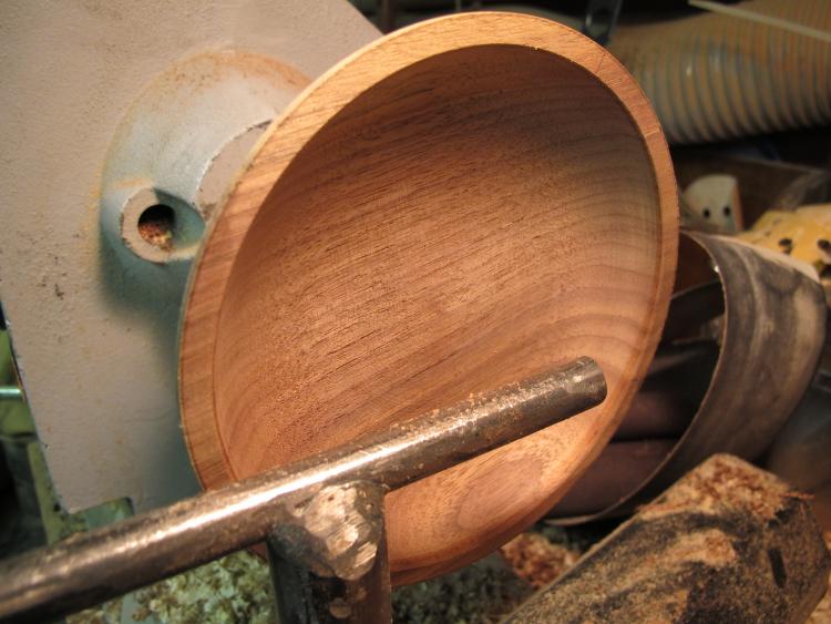

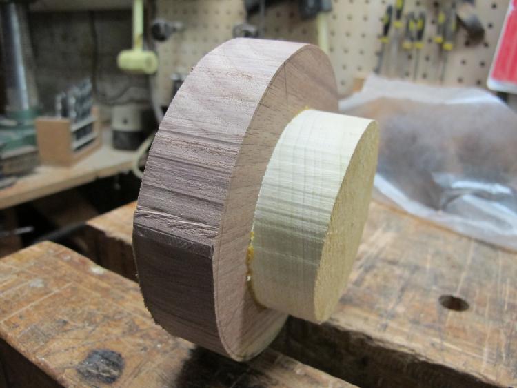

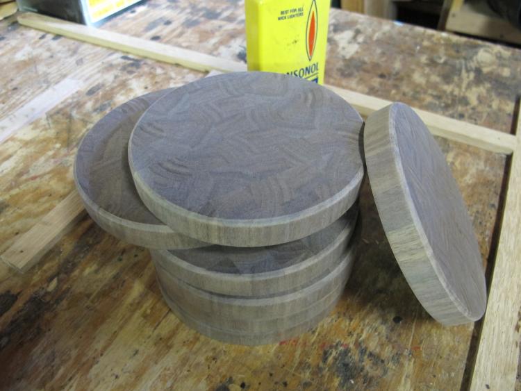

November 19, 201412 yr comment_56206 Man, it is COLD out. It's so cold that.... well you know the jokes- but thankfully I don't live in Buffalo, NY. I've been sitting in for the Electronics Instructor, this week, at school. Introducing county wide, 9th graders to the wonderful world of Electronics Technology. But I did get a little lathe time and some progress on the Christmas presents. Most of our friends/relatives are getting one of those garlic crackers. I thought I'd better also give them something upon which to crack the garlic; so I made some miniature end grain cutting boards. These are about 5" in diameter and about 5/8" thick. They still need a little sanding and the finish. I'm also making some shallow bowls to use for the same purpose . I had a piece of poplar propeller (at least it looked like one) and used it for the glue blocks. The finished bowls will be about 5" in diameter and a little over 1" tall. They have a flat bottom over most of the inside to facilitate cracking garlic or hard herb seeds. Tim Yoder posted another neat turning project- Inside Out Christmas Ornaments- Finally from a newsletter, I read about Rodney R. Miller, a disabled Air Force veteran who does some really nice turnings. You can email Rodney at Atsilla@gmail.com. You can see more of Rodney's work on his Facebook page at https://www.facebook.com/rcprojectsofAZ I hope he might decide to join our ranks. Safe Turning! Report
November 19, 201412 yr comment_56209 I love the small end grain cutting board! I am so glad I don't have a fridge like the one you pictured. Report

November 20, 201412 yr Author comment_56216 I love the small end grain cutting board! Thanks, John and John! I'm looking forward to seeing the grain patterns after I put on the finish! Report

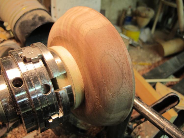

November 20, 201412 yr comment_56218 The bowl is perfect, I like the curve at the lip, graceful and wonderful a touch. Lew, are you keeping the glue block on? Or does it get cut completely off when you are finished, I have never used a glue block before so the concept is new to me. I am completely green for turning, remember! Report
November 20, 201412 yr comment_56221 Bu the way, I do love the bowl also. Just forgot to type that in my first response. The bowl has a beautiful grain to it, I think it will look great when it is finished. How are you planning the bottom, flat or slightly raised? Report
November 20, 201412 yr Author comment_56224 John and John- I will part (cut) off the glue block after sanding the inside and as much of the outside as possible. I usually use a piece of pine for the glue blocks however in this case, the poplar piece I had was so twisted that it wouldn't have been much good for anything else. After parting it off, I'll reverse chuck the bowl in a Longworth chuck and finish the bottom with a slight recess- so it sets flat on a counter top and then complete the sanding. Probably make 6 or 7 of these. The first one had a little lip because the material was thicker and I could incorporate it into the side wall. All of the other bowls are a little less thick so I'll just use a simple curve. Thanks for kind words, they are really appreciated! Report
