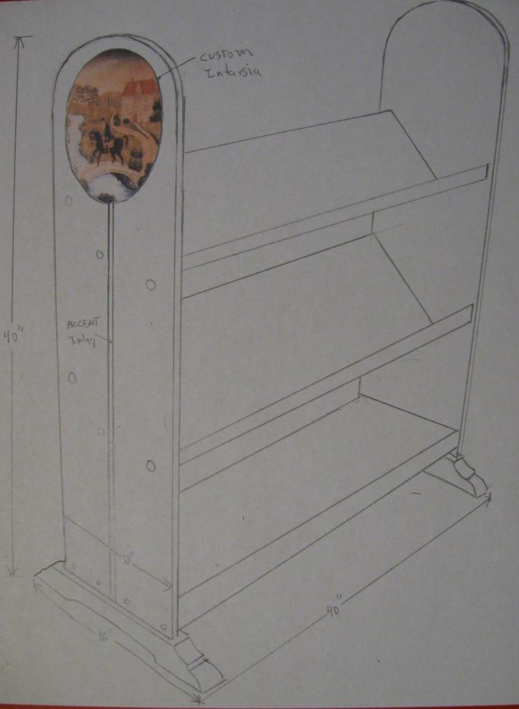

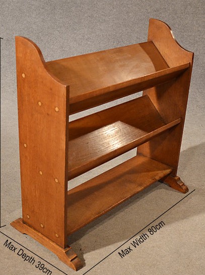

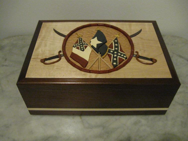

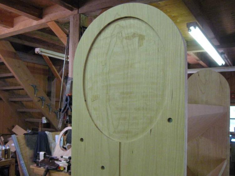

October 30, 201412 yr comment_55870 Hi EveryoneMany of you will remember a project I posted a while back. This was a keepsake box made with an Intarsia of the different Confederate flags on the lid. What I failed to mention was the client that ordered this box lives in Switzerland.He received the box, loved it and immediately started sending me photos and ideas for the next project. He sent several photos of different bookshelves and the plan was to incorporate a custom intarsia on the sides of the bookshelf.After some discussion we concluded that the unit would have to be able to break down for shipping purposes and he would have to do the final assembly.So here is the photo of the bookshelf that he wants to recreate-- Old English style( early 1900's) And this is the Photo of the subject for the Intarsia. This will be done as a mirror image on each side of the uprights. We chose cherry for the wood and gave it the dimensions of 40" tall x 40" wide x 10" deep. he wanted to add some accent striping on the sides using a nice contrasting wood.After re-drawing the original photo to include the areas for the Intarsia, This is what the bookshelf will look like. All of the cherry components have been cut and dry assembled. Still have to do the edge routing, final sanding and finishing on the cherry.I used a template and pattern bit to do the routing for the Intarsia recesses. Because I have to make it easy for the client to re-assemble the shelf, I installed alignment dowels in the ends of the shelf pieces and bottom feet. I'm using square drive screws to hold it all together. So after many hours of what my client calls " fidgety work" here is the completed right side Intarsia. Has 135 pieces from 13 different woods. On to the other side. Fun Stuff Report
October 31, 201412 yr comment_55880 The box is completely awesome Mike, first off. I have a few questions, what do you mean by "mirror image" in this situation. And, the drawing you did of the plan with the intarsia piece installed is beautiful art work in itself, how did you learn to draw so well? The intarsia concept drawing alone is way cool. Thanks for sharing Mike, great work as always and I am completely envious of your talent. Report

October 31, 201412 yr Author comment_55890 Thanks for the comments guys. This was a fun and challenging project. To John-I have always had the knack to draw but it wasn't until I started creating Intarsia that I really has a use for it. Mirror image just means that the left side will be constructed just the opposite of the right side. Thanks Report

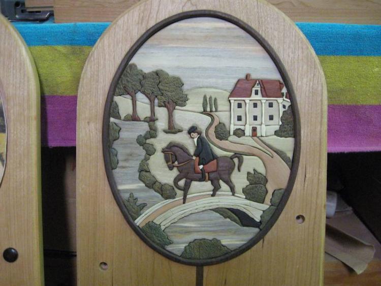

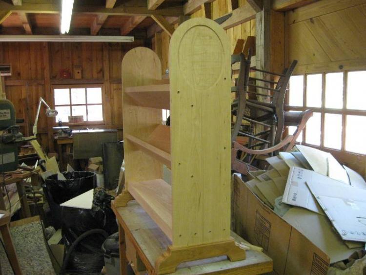

November 14, 201412 yr Author comment_56127 Almost There!!! I'm running a few days behind on this project but should wrap it up in the next week or so. All that is left is to finish the intarsia and apply a few coats of finish, The right upright is complete with 3 coats of wipe-on and spray poly. Report

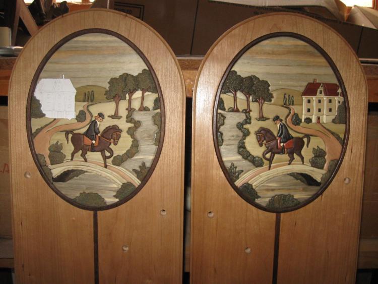

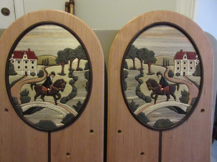

November 18, 201412 yr Author comment_56188 Intarsia is DONEStill have to apply a couple more coats of finish then do the assembly of the entire shelf unit.Also need to expose the left panel to UV for a couple of hours to let the Lignum " green out" a little more Report

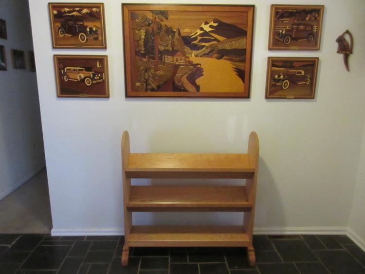

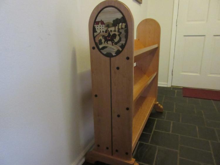

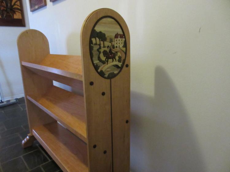

November 18, 201412 yr Author comment_56190 Just Couldn't stand it!!!Intarsia is done, Shelves are done, little turned screw buttons are done. still have to apply more coats of finish but just had to see what the whole thing looks like assembled so here it is. Have to break it down anyways for shipping to Switzerland. Report
