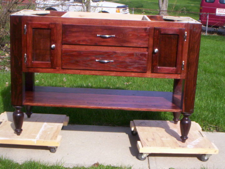

August 23, 201016 yr Author comment_53712 Hi John, I got rid of my jointer a few years ago for it was not being used other than to drawing dus for I use Titanium blades on my saws and they are 40 tooth thin kerf and there is no need to joint them for the edges are so smooth you can just glue them up right from the table saw. Now if one were to not cut the pieces to a rough size for the project being about to build you would/could have some defects, cups, bows an anything but a straight board. So be cutting them to a rough length and width you avoid any problems of this occuring when running them through the planer. First look at the board to see if it hac a cup. f so adjust your planer and run the board through a few times while lightly taking some wood off the top of the cup and then when you have a flat ara of about 3" wide it will ride flat on the planer table then start taking off the sled runners till it is almost down to the bottom of the cup. Then by doing that your board will run through the planer level and flat and each time you reset the depth, run it through and then flip it over 180º side to side and run it through again on the same setting. This will give you a flat board that needs no jointing. I have been doing it for over four years now and don't need jointer and if I am right you have seen some of my work and if not here is one. Report
August 23, 201016 yr comment_53711 Thanks, you clarified your methodology here, And, looks like you found how to load pics directly, great job Ralph! And nice bath vanity, I remember when you made that. Report
