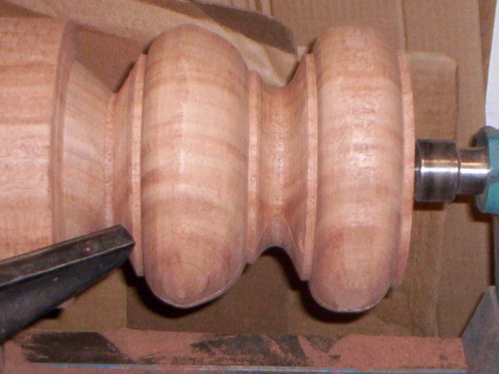

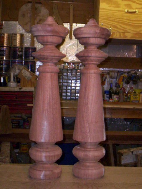

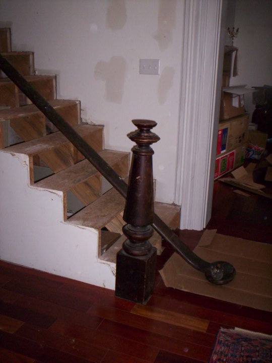

September 4, 201016 yr comment_53453 Good Evening Friends, I don't claim to be a master wood turner but I have in my life as a woodworker turned on a lathe that was turned with a big leather belt hooked to a John Deer Tractor. As time went along I found that I could look at a profile and duplicate that piece simply with eye/hand coordination and calipers. Â Here are two newel posts I turned for a job last year while restoring a set of stairs in a house that was build in 1842. Â Â This newel post was the original bottom newel post that I used as my sample. Â Now for the other ones I turned; Â Â This was the start of one of the two and one half I had to make. Â Â These are the two full newel posts I turned out of mahogany with their caps on and all I had was the sample and eye/hand coordination and calipers as well as a cardboard template to hold on the posts as they were turning to see how close I was to getting them to look like the original post. Â I hope you like what you have just seen for I was pleased in the way they turned out. Â Ralph Report

September 4, 201016 yr Author comment_53463 Hi Greg, Yes, I did buy one and tried it several times and the duplicator bit/tool was so pointed that it left a ragged work surface so rough it seemed like it took forever to clean it up. I found that working with the tools on hand I could better control them and as you saw in the first picture of my newel post it was clean and crisp and left very little to sand. Using a skew tool for laying out the various separations made it much easier to work from them in the design of the sample newel post. I am more fortunate than most for I had many years of hands on with the lathe and John Deer tractor to practice making items and as we both know there is no better way of learning than hands on. Here is a little more of my turning work.Greg Coleman said: They look great Ralph. I do not have the eye for detail that you are blessed with. No matter if it is flat, round, or curved, you seem to pull it off.IIRC you acquired a lathe duplicator some time back. How did that work out? Report
