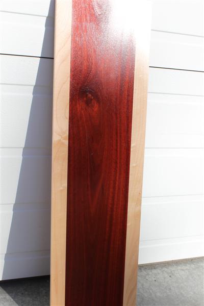

I done a lot of research on finishing Blood-Wood. As always you get conflicting reports. Some say it will turn brown over time. However more say it will retain its' red color. I talked to a fellow named Jerry Work who is a well known pro woodworker that uses a lot of Blood-Wood in his projects. He says says it will keep it red color. He recommended using Target coating EM 2000 wvx which is a water born interior/exterior varnish. In the pasted I use a quite a bit of Fuhr's pre-cat lacquer (a water borne product).When using that product I would first seal the wood with Zinsser's seal coat. The Seal Coat is a 2 lbs cut shellac. So I asked Jerry If I should seal it with shellac before applying the EM 2000. He said, and I've read this in other places, do not use alcohol products on Blood-Wood on any woods containing a lot of resin because the alcohol will/can dissolve the resins leaving you with a muddy looking finish. He also said he doesn't' like an oil finish on Blood-wood.
He recommends for a seal coat cutting the EM 2000 50% with distilled water and then applying 3 coats of the EM straight from the can or maybe up to 10% water if thinning is needed for better atomization for your spray equipment.

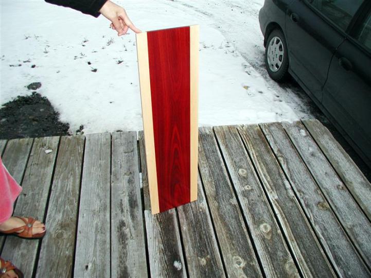

All that being said and before I knew about not using alcohol products 3 years ago I sealed some Blood-Wood with shellac and after 3 years it's still holding it 's color. See picture below.
The first picture was taken about 3 years ago and the second picture was taken 10 minutes ago.
ning-bloodwoodthreeyearsagomedium-53231-
Wow that still looks good.
