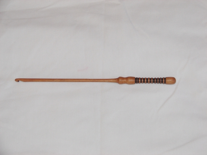

September 26, 201016 yr comment_52956 My wife has asked me several times if I could make her a crochet hook, size 8. I didn't think I could do it because it looked far too delicate to me. I gave it a try by first picking a piece of Cherry with the straightest grain I could find. Then I used a micrometer to measure her old size 8. I had to think about how I was going to do this, without breaking it first. I realize now that there are probably tutorials on Utube, but I didn't think of that at the time. I did struggle with it a lot, but finished it. It AIN'T perfect, but she likes it. Now she wants more and wants them designed to fit her hand, that is shorter and the handle needs to be longer. etc. Report
September 27, 201016 yr comment_52962 Ron that is great. So what part of it gave you the most problems? Report
September 27, 201016 yr Author comment_52961 The thinner it became, the less stable it was. The final diameter was very touchy, the center thin shaft had to be stabilized with my fingers. Which made me wonder how safe that was, if it broke off, would some of it find its way into my fingers. I turned most of it with my gouge, but the final diameter was taken down with a small power belt sander. I'm sure there is much better techniques, but that is how I did mine. John Moody said:Ron that is great. So what part of it gave you the most problems? Report
September 27, 201016 yr comment_52960 I know what you mean about safe. I broke a handle on a mirror I was turing the other night and scared the daylights out of me. It was a bad place in the wood, but still scared me. The fun thing is it doesn't matter how you do it, it is just that you do it. Ron Altier said:The thinner it became, the less stable it was. The final diameter was very touchy, the center thin shaft had to be stabilized with my fingers. Which made me wonder how safe that was, if it broke off, would some of it find its way into my fingers. I turned most of it with my gouge, but the final diameter was taken down with a small power belt sander. I'm sure there is much better techniques, but is how I did mine.John Moody said: Report

September 30, 201016 yr comment_52958 Good Morning Ron, Working with something that slender might call for a lathe steady and following is one I made while turning spindles for a rockong chair. I hope you find it useful and if you need doirections just send me an email. Ralph Report
September 30, 201016 yr Author comment_52957 Ralph, when it became unstable, I used my thumb and finger on my left hand to stabilize it, while my right hand was working with the tools and sandpaper. Maybe not a good thing to do, but it worked. If I decide to make more, I will certainly consider you offer. Thanks for the info and picture Ron Report
