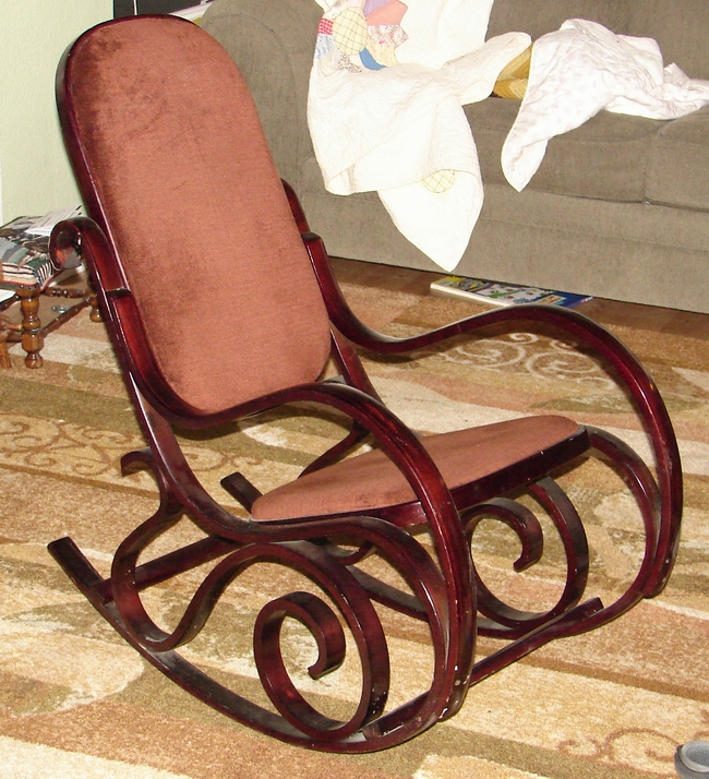

September 30, 201015 yr comment_52914 My wife bought this chair at a garage sale for $15. After I tightened the screws, all were very loose, it is really a nice rocker. Now the question;How did they make all those curves so precise? Was it made of multiple laminations and bent around a jig?  Report
September 30, 201015 yr comment_52919 I don't know, at least not at this point. Do you know how old the rocker is? If you look closely at edges does it look like a bunch of thin strip glued together? Does you camera have a macro setting? Ff so maybe you could take a close up of an edge using plenty of light and post it here on the forum. Report
September 30, 201015 yr comment_52918 Ron, you'll see this over on the other forum but I'll post it here anyway so others will know. Matt posted this and I trust his knowledge. The design is from the late Beidermeier period and extended well into the Art Nouveau period. Very popular in Austria and France, and variations have been called 'bistro furniture'. It's factory made, most often steamed and then put into industrial jigs to cool. Laminations are seriously more labor intense and more of a time sucker. Steaming and a little hand work after the fact was the way to go. Chairs such as this were made by the tens of thousands this way. As with everything like this, all the action is in the bending jigs. Report
