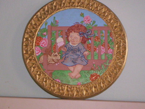

October 31, 201016 yr comment_52275 Hey Mike, Oh for goodness sake, I din't read the whole post before I read or clicked on the attachments what you were meaning. Those are neat however you could print out the face of either one and lay a grid over them and then enlarge to suit or as needed to carve the face in the post. Then after you have the picture on the paper make a pounce by using a tracing wheel to perforate the holes and the sand the back of the pounce paper and put some charcoal powder in a pouch like of an old T shirt and pounce the patteren on the post and have at it. If you pencil in the lines you won't lose the pattern. I do it a lot if I am going to make a different carving or repetitive of te same picture. As you will see in the picture I am posting; This is a picture I took off of a calender my wife had and I chip carved every line and then painted the picture. I used the grid system to transfer the picture to the wood. Ralph Ralph Allen Jones said: Good Morning Mike,No need for a green man post when all you have to do is to set another post with a center horizontal 4 x 4 between them making an H and take some number 9 wire and wrap it around the top of the gate post and down to the bottom of the second post and then when tied in a loop around both posts put a stick of an 18" piece of wood in and twist the wire together winding it tight.The hang the gate and if it sags take a few more twists on the wire. It works every time.Ralph Report
