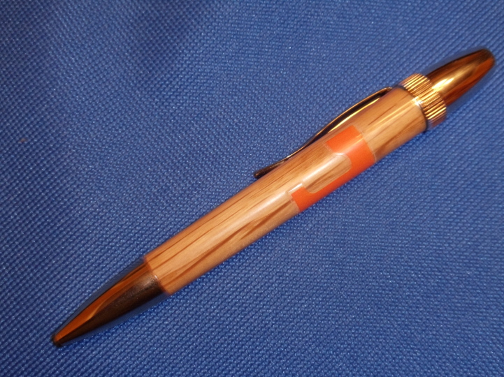

November 11, 201016 yr comment_52031 I saw some decal work on a pen in another forum. I haven't tried making my own yet but came up with this. It is a temporary tattoo applied to a Jack Daniels whiskey barrel stave. I can't get the whole image in the photo but some of you may recognize it. GO VOLS. Report

November 11, 201016 yr Author comment_52035 Joshua, I put on 2 coats of thin CA, placed the decal/tattoo, couple more coats of thin followed by 3 coats of medium. I can still feel the decal. I am sure they are thicker than water slide decals. Everyone seems to like it though. John, CA is Canoacrylate glue. Super glue it is usually called. In my opinion it is one of the best finishes for pens. It is easy to apply, super hard, and shines up beautifully. Report
