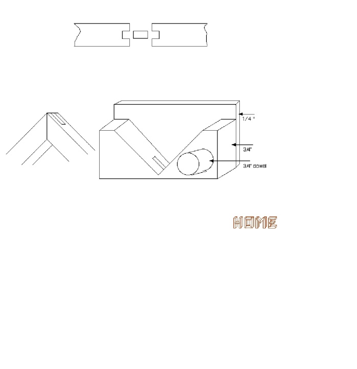

November 13, 201016 yr comment_52004 Hehe, Ron I have been in this same exact place before, quite a few times I started with something that was a good size and from boo boo's and "Aw Craps" I ended up with a different design and size, so pardon me for my giggling, I find this humorous as I can completely relate. The whole expansion thing is a non issue at this point, especially with Oak, oak is very stable in the first place and in that size it would be negligible. I think at this point, you should edge it to the eye now, whatever looks great, whatever feels right, and however you want without any concern for movement. That being said, 45 it, that would look great and you can add some width to the table. After you have the table framed out with your 45 edging, slot the corners of the 45's about 1/2" deep or more and put some nice contrasting corner splines in the corners, this will add a nice touch and give you some insurance on preventing those 45's from separating. That is what I would do anyway. Here is a decent illustration of a basic Spline Joint Jig.The jig is used on your table saw, very handy and cheap to make from scrap wood, and you'll use it many times over once you see how easy it is to use and how beautiful and classy the joints look. Report
