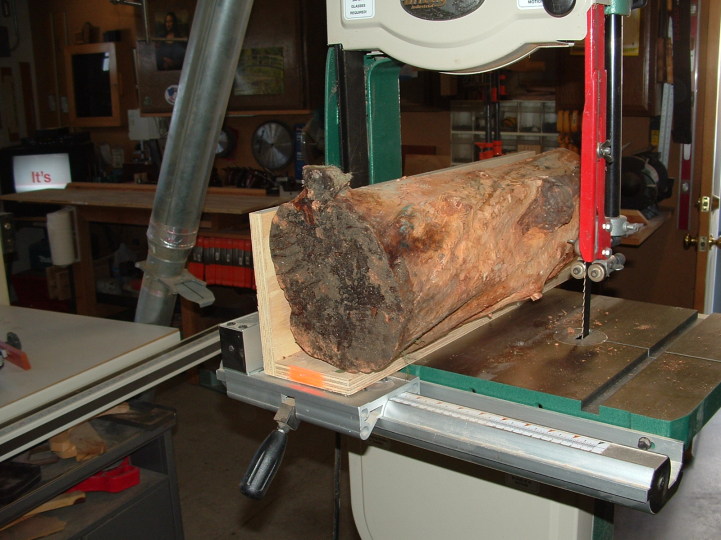

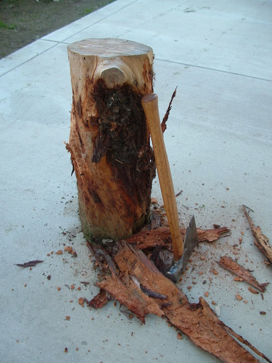

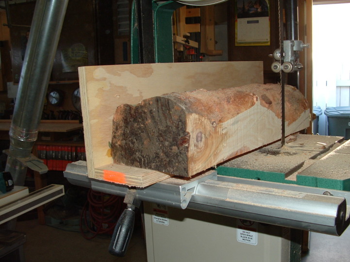

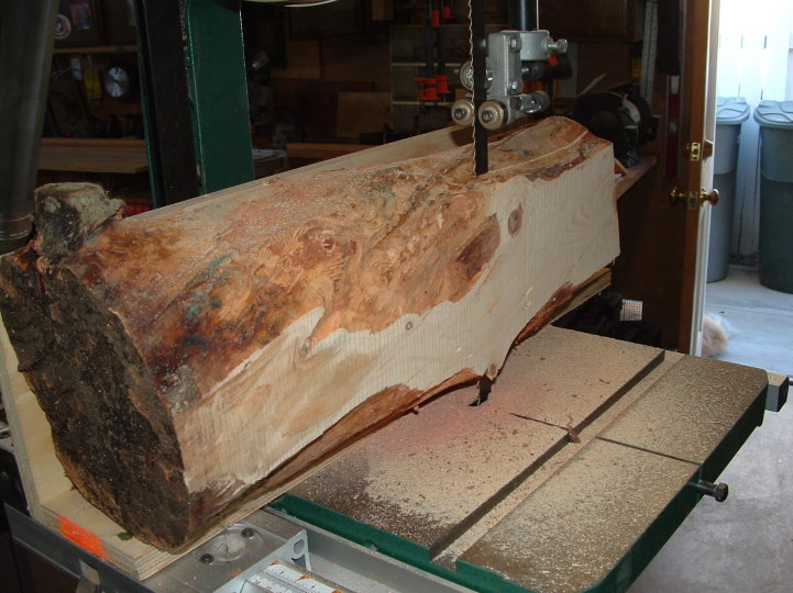

November 14, 201016 yr comment_51929 Today I was out in the shop doing some honey do stuff. I started to work on a new door threshold for our front entry doorway, but the flies are so bad in our area right now I couldn't leave the front door open for any length of time to work on it. So, I got sidetracked and cracked open a log just for fun. I don't even know what I can do with the boards, but for me it's just fun and somewhat relaxing to find out what lay inside a chunk of firewood.I didn't know what type of log this was, can you tell before you scroll down and see the other pics?That's my framing hatchet I used to debark the log. My poor mans right angle re-saw jig with the log screwed from the back of the jig securing it in place. First run. Second run, I sliced 1" boards. Third run, I got a couple 1" boards from this set up, now I have a flat frame of reference. I rotate it 90 degrees to produce another flat side. Now the flat side is set up against the band-saw fence without the right angle jig. Now that I have two faces I can rip my boards normally. This little log about 24 inches long yielded some pretty interesting cedar. It's amazing what a little firewood can have inside it. So there ya have it, took me about 20 minutes to come up with a pleasant surprise, not to mention the pleasant smell that filled the shop air. I had no idea what this log was, but as soon as the band saw blade entered the log, I knew what I was cutting, the aroma was unmistakable.I have no idea what I am going to with these little slabs of 4/4. But I'll throw them in my wood bin and wait for the time to call.Thanks for lookingBy the way, I did this on my Grizz Ultimate Bandsaw with a 3/4" 4TPI blade.  Report
