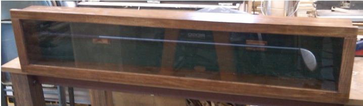

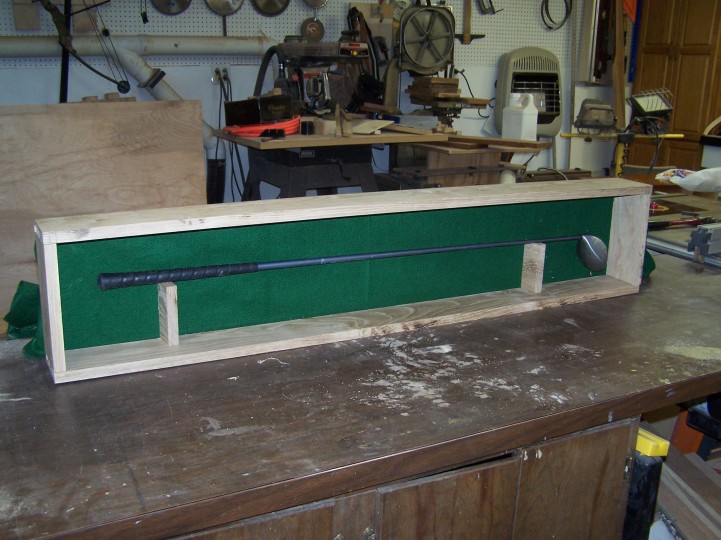

December 20, 201015 yr comment_51049 Ron, Â The only shadow box I have built was for golf clubs. Â I build a box for the club to hand in. I cut a rabbet in the back to accept the plywood back that was covered with felt. Â Â I then made a frame to put the glass in and hinged the frame from the top of the box so that it hung closed. I put a catch in the corners to hold the lid closed. I made the door more like a regular door with glass than a mitered frame. Â I have the door frame a little larger than the box so that the frame was about all that you saw when it was hanging on the wall. Â Â Report
December 20, 201015 yr Author comment_51048 I guess I wasn't thinking John. My thoughts were about one that is permanently sealed. A hinged door, is a simple solution that would allow it to be used for many things and internal clean up/rearrangement of your display. I'll have to recheck and see EXACTLY what she wants. Â ThanksJohn Moody said: Ron, Â The only shadow box I have built was for golf clubs. Â I build a box for the club to hand in. I cut a rabbet in the back to accept the plywood back that was covered with felt. Â Â I then made a frame to put the glass in and hinged the frame from the top of the box so that it hung closed. I put a catch in the corners to hold the lid closed. I made the door more like a regular door with glass than a mitered frame. Â I have the door frame a little larger than the box so that the frame was about all that you saw when it was hanging on the wall. Â Â Report

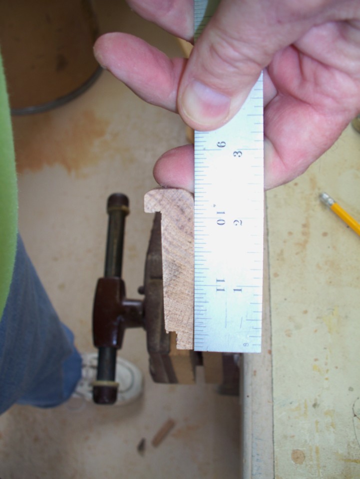

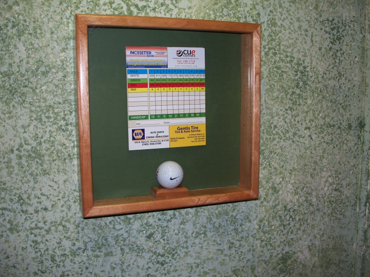

December 20, 201015 yr comment_51047 Ron, I've made several of these and they're a piece of cake. Make a series of cuts to make the frame look like this on the end view. Miter the corners, square it, glue it and pin nail it. Put the glass in using glazing pins. They're available at any hardware store. This particular piece is 3/4 thick so a standard 1 x whatever should work. I put turn tabs on the back for access. Hope this helps. Here's a finished product. This is a small version. The biggest I've made was for an autographed Pete Rose jersey. Report

December 21, 201015 yr Author comment_51043 Thanks guys. Ron, one picture make a simple procedure very simple. I started cutting some of the pieces today and will most likely have it assembled tomorrow. I'll send a picture. Thanks again.Ron Dudelston said: Ron, I've made several of these and they're a piece of cake. Make a series of cuts to make the frame look like this on the end view. Miter the corners, square it, glue it and pin nail it. Put the glass in using glazing pins. They're available at any hardware store. This particular piece is 3/4 thick so a standard 1 x whatever should work. I put turn tabs on the back for access. Hope this helps. Here's a finished product. This is a small version. The biggest I've made was for an autographed Pete Rose jersey. Report
