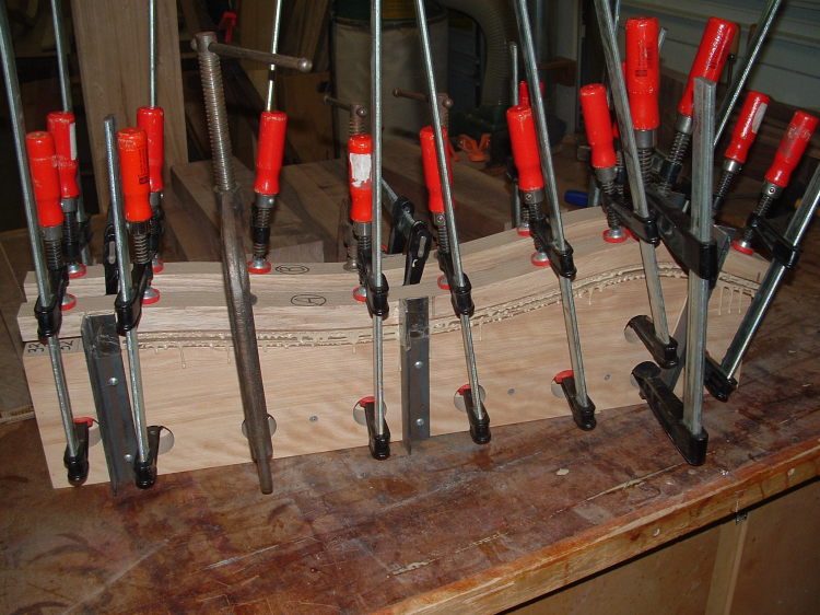

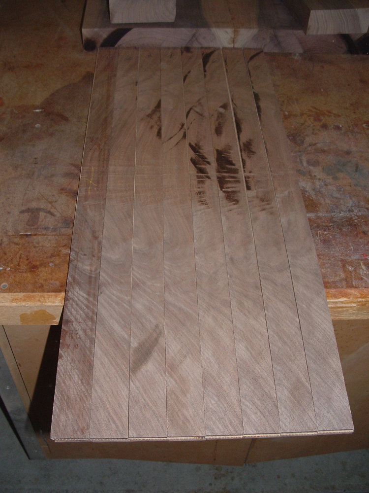

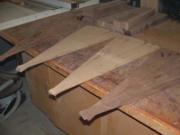

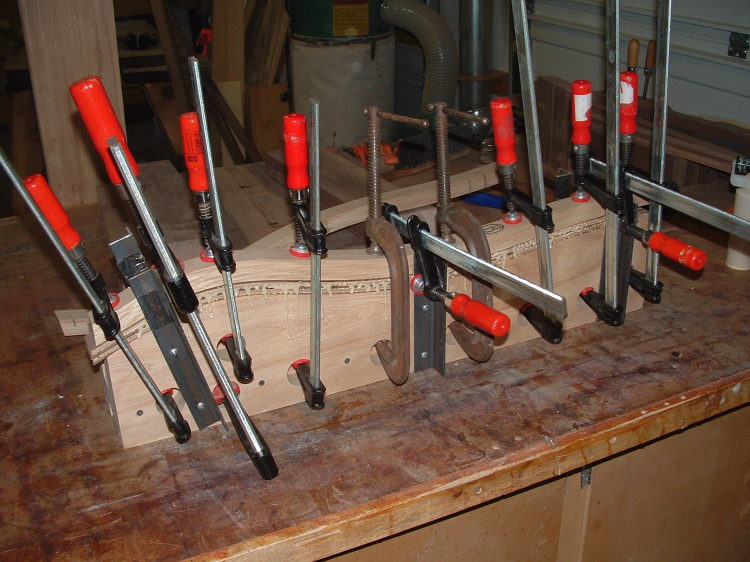

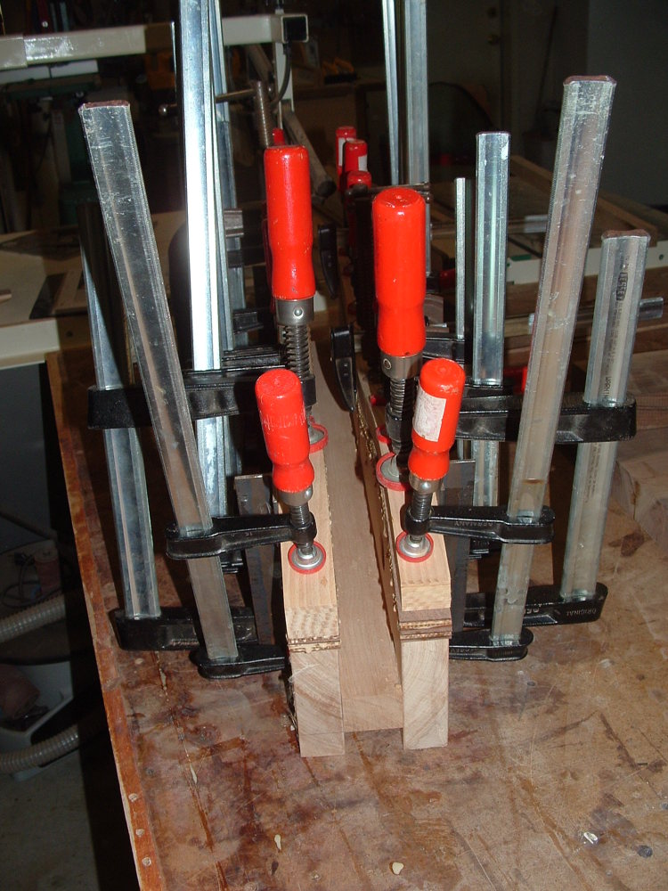

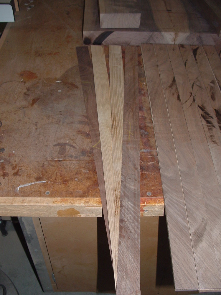

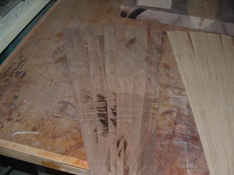

December 29, 201015 yr comment_50790 Tonight I got to spend a couple hours in the shop, and I spent the time ripping the lams for the back braces and sorting and gluing them in my back brace form. This first photo is the back brace lams ripped, the two assemblies on the right and left are the walnut stacks, and the two in the center are ash. Â The second picture shows the matched grain pattern that will really show up nicely in the finished chair's back braces. See the lower portion of these lams, the beautiful ribbon affect, these back braces will really pop in the final rub down. Â The back brace lams are now sorted and stacked, the walnut lams are sandwiching two lams of ash. Ash is used for it's tendency to stay in a formed shape, it has been used for centuries in bows. Â The next photo are the lams stacked and ready for glue up. Note how nicely the figured grain is matched, when these are assembled in the chair, the flowing matching grains are really going to be eye catching. Â Here we have two stacks glued up in one shot. Â The next pic shows a total of four lam stacks (four complete back braces) glued up in my doubled up form. I have a total of 8 back braces to make, so that means I need to make two glue runs with this set up. Â The end shot of the setup, this might help explain how this is done. Â Tomorrow I will glue up the other four back braces the same manner I did these four, and I will also be ripping the rocker lams and I will be able to glue them up tomorrow as well. Thanks for looking folks! Report

December 29, 201015 yr comment_50795 Fantastic John, that wood is looking so good. Glad to see you getting some time to work on the chair. Thanks for the photos.  BTW, how many more clamps do you wish you had?Rich.  Report
December 30, 201015 yr Author comment_50794 Thanks John, I think it's really going to look good. John Hechel said: looking good John, I love the grain pattern on that walnut also. Report
December 30, 201015 yr Author comment_50793 John, I still don't have enough clamps! I have to stagger my glue up operations because of lack of clamps. I will invest in more in the future. John Moody said: We are really off and running now. Looks great and yep, we need all of the clamps we can get. Â I really like the effect that will give. Should make it really pop. Report
December 30, 201015 yr Author comment_50792 Rich, about 100 more clamps, really! I could use em, I could have multiple operations going on at the same time and it would speed up production,I am working on it though! Richard McComas said: Fantastic John, that wood is looking so good. Glad to see you getting some time to work on the chair. Thanks for the photos.  BTW, how many more clamps do you wish you had? Rich.   Report
