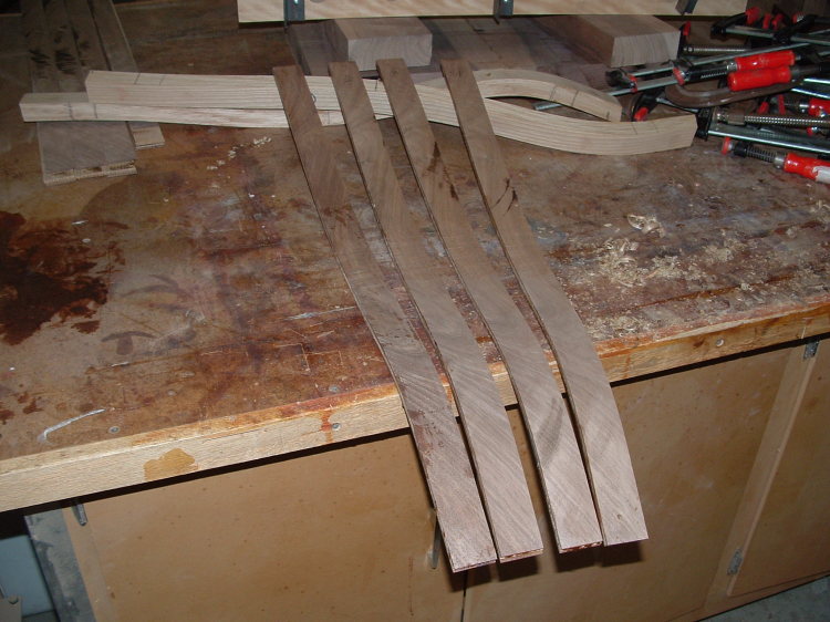

The first pic is just a picture of the Tightbond III Wood Glue after dried, it turns nice and dark, and for the walnut rocker, this is great.

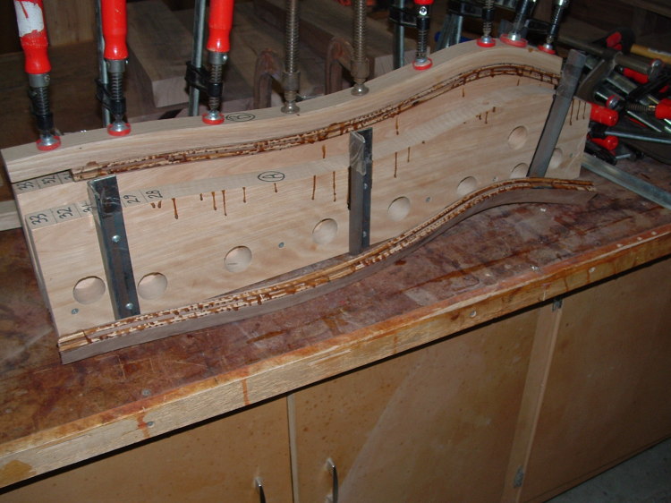

ning-poppingthelams-50781-3.jpg?width=75The second pic is the first two back braces popped off the form, they are stuck together, I get an uneasy feeling every time I do this, even though I know I took precautions to make sure they don't stick together, it sure looks bad when they are first removed before clean up. It wouldn't take much to cause them to stick together and that would just ruin this particular set.

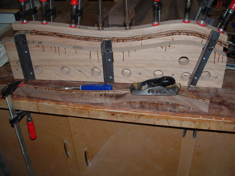

ning-lamssucktogether-50781-29.jpg?widthThe next pic is showing what I use to clean up the sides of the two back braces before I attempt to separate them, a chisel and a block plane, I remove the majority of the glue with the chisel, then I run my block plane over it about a dozen times and the edge is then clean, I do this on both sides, before I attempt to insert a chisel between them for separation.

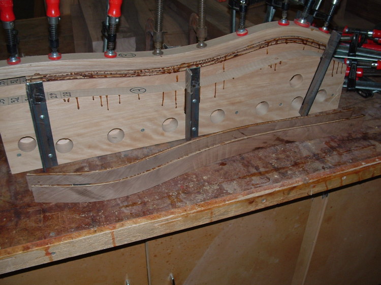

ning-cleanup-50781-93.jpg?width=750Successfully separated two back braces.
ning-separatedlams-50781-59.jpg?width=75My first set of four back braces off the form and separated.

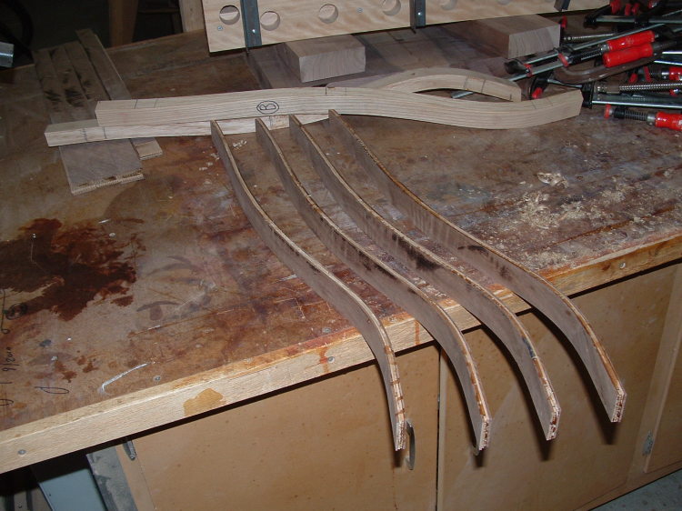

Four nice back braces.
