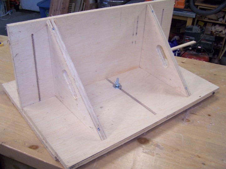

Basically it is a piece of plywood for the base. Then I took two pieces and put them together to create a fence. There is a slot cut in the fence and a bolt with a handle through the fence and into the base. That way you can slide the fence in or out to adjust the size you slab off. There are a couple of slots in the back of the fence so you can put a small screw through the fence and into the log to hold it on the fence until you get a flat face cut.

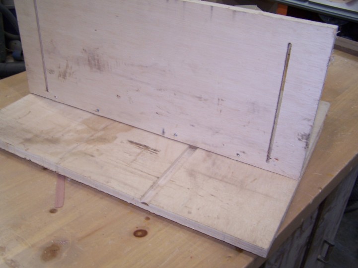

Here is a picture of the back of the jig.
ning-100-3740-50406-78.jpg?width=721So there a a couple of pieces to this. One is the bottom board. Then the other part is the fence section. On the fence section, I routed two slots to allow me to put a screw through it and into the log until I got one face flat. There is also a slot in the bottom of the fence section to allow a bolt to come through to tighten it when you move it in or out.

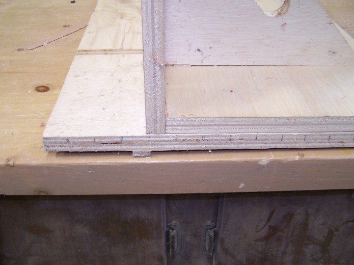

ning-100-3741-50406-66.jpg?width=721There is also a dado cut in the bottom board to allow a running on the bottom of the fence to move in it. This keeps the fence square to the slot in the band saw table.
ning-100-3741-50406-71.jpg?width=721
This is the slot and running on the bottom of the fence.
ning-100-3743-50406-19.jpg?width=721ning-100-3746-50406-85.jpg?width=721I have the bottom indexed every 1". I think you can see the pencil marks on the side. This way I can loosen the wing nut and slide the fence over and take off what ever thickness I want.
I hope this helps, if I didn't make it clear, let me know and I will try to do a better job of explaining it. Sometimes it makes sense to me and I don't explain it very well.
Again, sorry for the delay in getting it to you.
Bob,  I forgot to put dimensions on the other post.
The base is 24" long and 16" wide
The fence is 24" long, 11" wide and 10 1/2" high.
