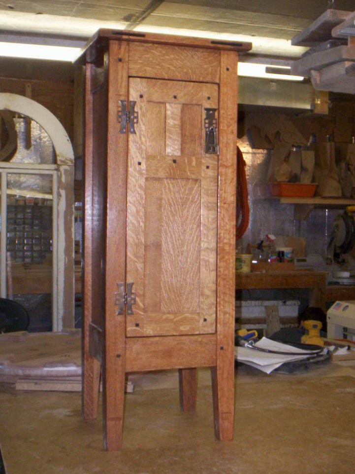

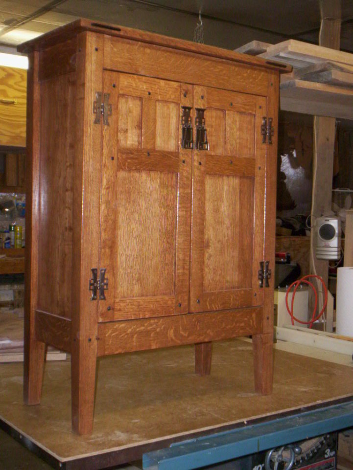

January 14, 201115 yr comment_50239 Good morning Harry, I finish by hand on all of my products and the methods I use are as follows; Sand the project down to 150 all over and down to 220 on exposed edges of the grain. Then vacuum all and any dust before applying the first coat. when applying it put it on like you are waxing a car and over lap continuously through out the project. Allow the first coat to dry 24 hours then fold a piece of 220 that is 1/4 sheet and sand lightly over the entire project. Vac and apply the second coat much in the same manner as the first coat. Allow it to dry over night and sand again with the 220, vac and apply the third coat. After this application you do not need to sand any more but instead take a grocery sack (Paper) and wad it all up and buff with it and your dust nibs will disappear. I use Minwax Tung Oil consistently with great success. Here is a sample on two of my pieces; Â Report
