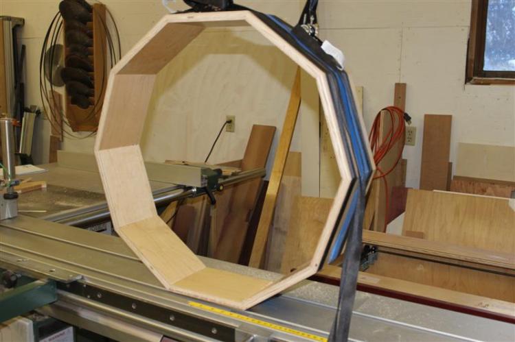

I'm making a shadow box that's a decagon shape for some Alaskan native art. It's a mask in a round shape. See picture below. It's not that exact mask but it shows what I mean by round shape.

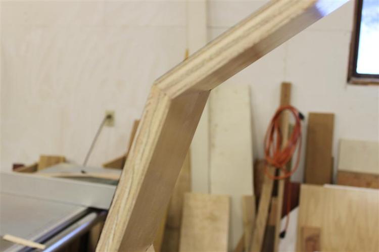

Anyway, I thought I'd do a mock up out of plywood to check my saw blade setting. I used my (for the first time)Beal-Tilt-Box to set the blade angle to 18 degrees. Made my cuts and it came out perfect the first time. Now I very impress with my Beal-Tilt-Box.
ning-bealtiltbox1-50147-40.jpg?width=750Every joint came out perfect.ning-bealtiltbox-50147-19.jpg?width=750Did I say I'm impressed with my Beal-Tilt-Box.

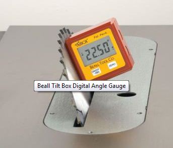

ning-bealtiltbox-50159-64.jpgThe Tilt Box is a digital inclinometer that will read relative angles to an accuracy of +/- 0.1 degrees. Accurate +/- .01 degree.
ning-wixey-50159-88.jpgyou can quickly and easily set the bevel angle to 0.1° resolution.
Both units cost about the same.
In my opinion the Beal out scores the Wixey for two simple reasons.
1. The Beall uses a standard 9 volt battery.  The Wixey uses IIRC a CR something.  The round button battery.
2.  The Beall has auto shut off.  The Wixey. does not.  If you forget to shut off the Wixey, you are running around trying to find that specialty battery.
