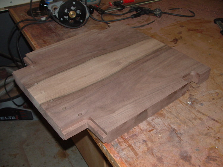

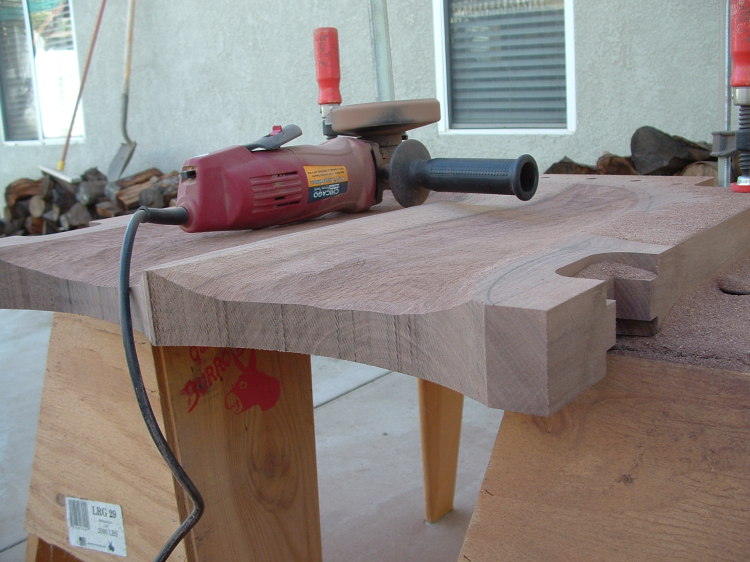

This first shot is of the chair seat before I took my right angle grinder to it.

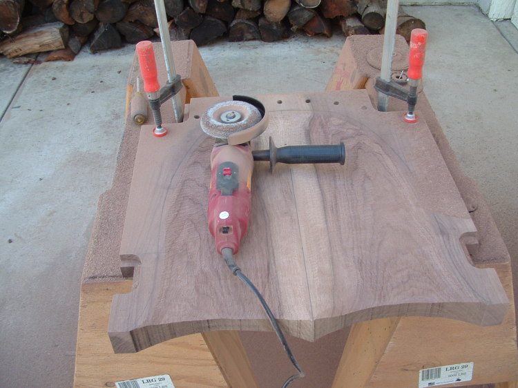

ning-028-50143-95.jpg?width=750This next shot is of the first 1/4" or so of the chair being ground out with my Harbor Freight right angle grinder and wheel.

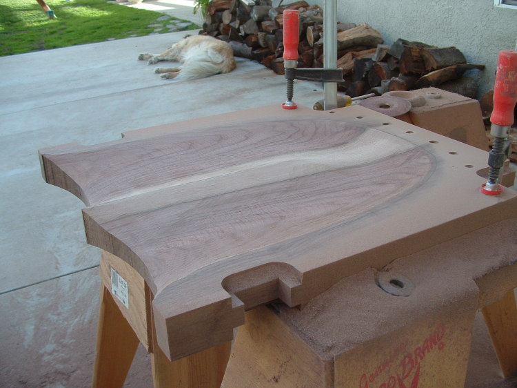

ning-chairseat-50143-34.jpg?width=750Next pic shows a little more progress, after a lot of dust and some strained arms, even though the grinder does a lot of the work, it still take some continuous muscle to keep working the pressure and back and forth motion to keep the grinding even and uniform.

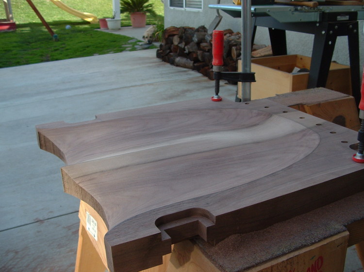

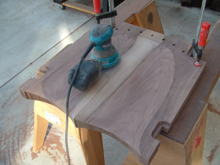

ning-almostdone-50143-66.jpg?width=750The sander is brought out after rough shaping, I fine tune the lines and center ridge with my sander. I am sanding with 60 grit at this point, just trying to even it all out, take out the bumps and carry a nice line around the perimeter. I still have the pencil line preserved from the beginning, I laid out the line at the ridge center of the seat, this is no mans land, that ridge area I like to keep in original condition, and I like to keep the same pencil line that I started with.
ning-sanding-50143-81.jpg?width=750The seat is now good enough for assembly with the legs, I will perform final sanding after the legs are joined and blended.

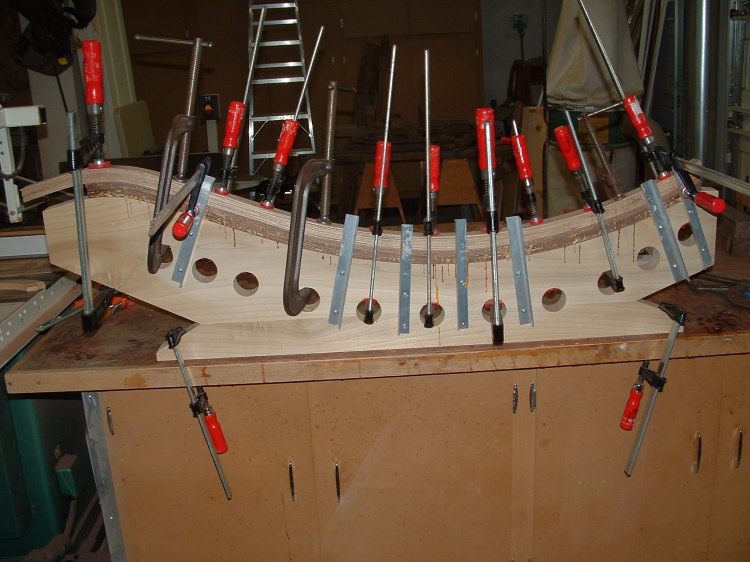

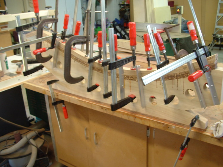

The next pics are my rockers being glued up. I really love the Titebond III glue. I have 9 lams to glue up, I need to spread glue on 16 sides, and it takes some time, the open time of the Titebond III is great for this application. Plus the darkness of the glue after it sets up is great for filling in any micro gaps if there is any, the color goes well with the walnut.
ning-rockerlams-50143-66.jpg?width=750ning-rockerlamswalnut-50143-80.jpg?widthYou'll notice with this rocker set, I designed a little negative hook in the rear of the rocker, I wanted to experiment with some design changes on this rocker. As a lot of you might remember, my first rocker was based off the Hal Taylor design, I really want to branch out and come up with my own design. While I am still being influenced by other rocker makers, some day I hope to have a signature design of my own. Step by step.
