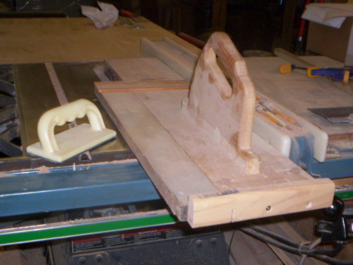

January 26, 201115 yr Author comment_50010 Good Morning John, That would be determined on how thick you rip the thin strips. If they for instance are only 1.16" thich they can be over lapped and the corner would hardly be noticed but, if you rip them 1/8" thick or thicker yes, you would 45 them. Using my thin strip jig one can rip them very easy at 1/16". Here is a picture of my thin strip jig; Â To accommodate wider pieces the hold downs would naturally be higher and ripping 1/16" thick strips is as easy as pie. Report
