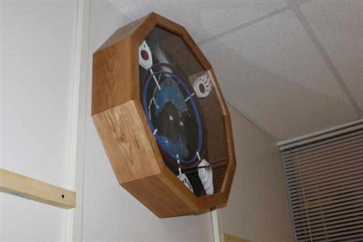

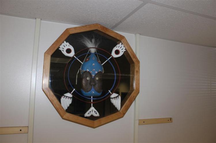

January 28, 201115 yr comment_49924 I finally finished the decagon shadowbox box. It houses a Yup'ik mask made by an Yup'ik artist. Â This was a work order I received for one our schools. This is your tax dollars at work. Â Report

January 29, 201115 yr Author comment_49927 Cherry wood with Blond shellac. The back is recessed 3/4 of an inch and hangs on a french cleat. There are 5 long 6" screws on the back that hold the face frame in place. Remove the screws to gain access to the inside. Report
January 29, 201115 yr comment_49926 Very impressive to get all of those angles to work out. I may have to get me one of those. Rick Report
January 30, 201115 yr comment_49925 Rich, that is way cool. I love American Indian art and your display case is a great compliment to the artwork itself. Very nice man. That Beal does good work too! Report
