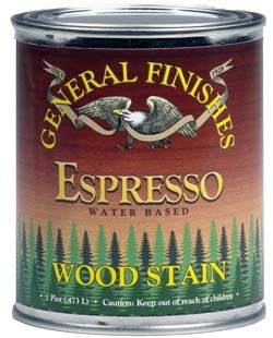

January 31, 201115 yr comment_49879 Not sure what the definition of Green is...????? Â However, GENERAL FINISHES make a great line of quality water-based stains/dyes/finishes, I use them all the time. Â Report

February 1, 201115 yr comment_49877 I agree on the GF water base finishes, about as green as it gets... except for mud , as well its as durable and tough as it gets, we use it all the time ..... Report
February 2, 201115 yr comment_49876 Tung oil . Pure tung , available from several sources, is the base finish I use to bring out the best in my high figure woods .Citrus based solvents compliment this "green " finish ,and helps it to penetrate deep into the woods surface . It takes time to cure , and there are a few ways to go with this "solvent " based finish that can be tinkered with .After several days the  top coat of choice is General Finishes Enduro -Var .New last year from GF , this stuff is great ! Very hard , easily tintable , and easy to apply . I just completed a restaurant job with this finish schedule to very flattering reviews . I always smile when I say that my finishes are oil and water LOL Report
